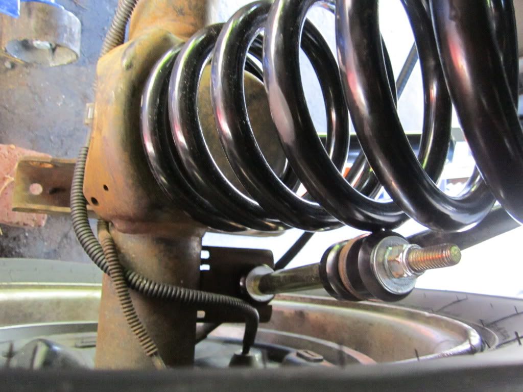

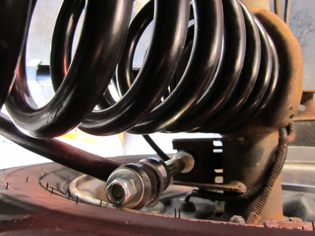

Just got done last night. I have a few questions now though.
Does this mean I need an adjustable rear trackbar? I got a new one (not adjustable) from IRO with the kit but my axle isn't centered quite right.

I adjusted the front wheels and took the rear sway bar out for now (since it hits the spring and/or rim). When I took it for a test drive, everything seemed to work pretty well except there is a vibration when I go about 30 or so. Could this be the need for alighnment or should I drop the transfer case. The kit came with the drop kit but I didn't install it yet. At slower speeds I don't notice any vibration. I'm new to all this but it seems like, if it was driveline vibration, it would be noticable at slower speeds as well.

Contact IRO and see if you can turn in the non-adjustable and get an adjustable one. It'll fix your non-centering issue.
Make sure your pinion is pointing correctly in the rear. Your vibes may be due to an incorrect pinion angle. You want it to look like this:
Your front pinion should point directly at the transfer case.

you definetly nee to do an alignment, pinion angles need to be correct, but more than likely you need to replace your driveshaft ujoints to cure the vibes, they end up wearing a pattern in the needle bearings and since the driveshaft angle has changed, the u joints arent' liking it much
start with getting the proper pinion angles

You are going to loose those wheel weights on that rear wheel. The endlink will clear them away.

I just took the whole sway bar and links off for now
