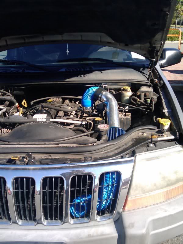

So I think the 4.0 intake was badly designed. Every tie I looked at it I thought to myself "how does this thing even breathe? So I was in autozone getting some degreaser and went by the filter isle and thought "why not?". 93 bucks and a few lazy hours later I got this...
It actually made an improvement power-wise. I was pretty surprised during the 4am parkway test drive. It definitely pulls harder. It also sounds totally badass at WOT. Somewhere in between the 4.7 and the GM supercharged V6's. I'll try and get a vid up.
Removing the airbox (which is a ***** and a half without a flexhead, I had to break it) freed up so much space I think I may invest in a turbo when I build up a 4.8 stroker from a junkyard 4.0.
For now though, I say my money was well spent. You can probably do this for even cheaper if you go the ebay/home depot route. Anyone saying their 4.slow doesn't have enough umph should do this little mod.

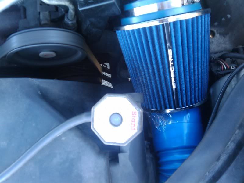

I wouldnt want to get laughed at. The clear tape on the cone is nice too. Might need more to stop all the leaks.

Hahahaha. I'm anal and wanted it to be flush with the cone, didn't really work as you can see. I jerry rigged it now with some Gorrilla Duct Tape, lolol, and it's flush with no "leaks".

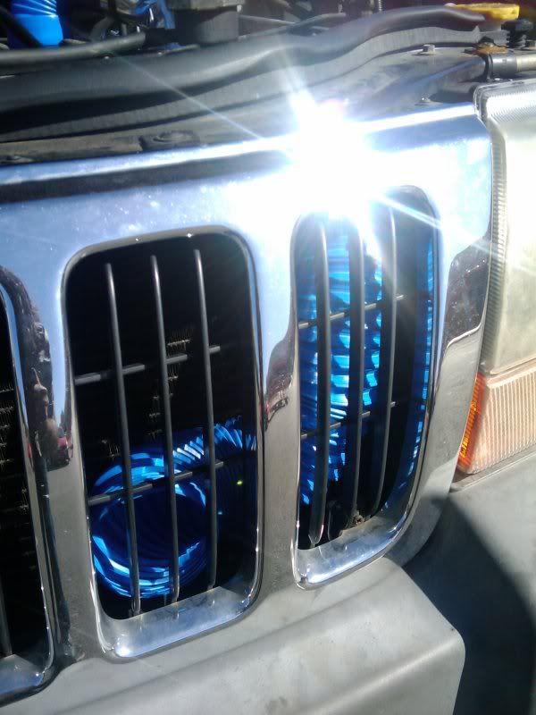

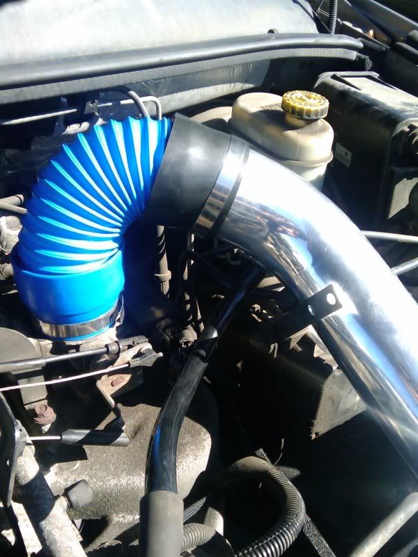

In what way did you "improve" the intake? What was wrong with it before? Now it sucks in hot air and you added turbulence with neon blue dryer hose...

Gotta love the warm air intakes.

Im just waiting for the metal tube to fall off the flex tubing on the TB that has no clamp or fastener. I guess that would make it a warm no filter intake.

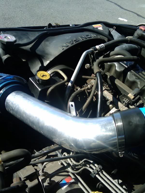

all those ridges won't help you at all. Stock is safer as well. If you had a fat radiator hose to the filter you would get the WOT noise boost but there is little to no way you gained power from that. This has been tested and tried so many times

I like the budget air intake however there are a couple of changes that i would do. First, i would make sure that thing is bolted down good. I wouldnt want it to fall off on a trail. Also, add a heat shield to help keep the intake temp. down

I would try to find some way around using the dryer hose stuff. See if you can replace that section at the throttle body with a solid 90* bend of PVC or even rubber. Also your tube is going to get as hot as everything else in the engine compartment and subsequently increase the temp of the air going into the engine. I actually have a cheap ebay intake that had the same problem, so I wrapped it in three layers of AC duct insulation and wrapped that in aluminum tape to keep it secured. Works very well. Look at my build thread for pictures of it.

As far as the dryer duct crap heading to the air filter goes, that's the most flexible option I can think of. Getting rubber to bend and stay where you want to doesn't always work. Not exactly much wiggle room through the hole in the plastic and behind the grille either.
