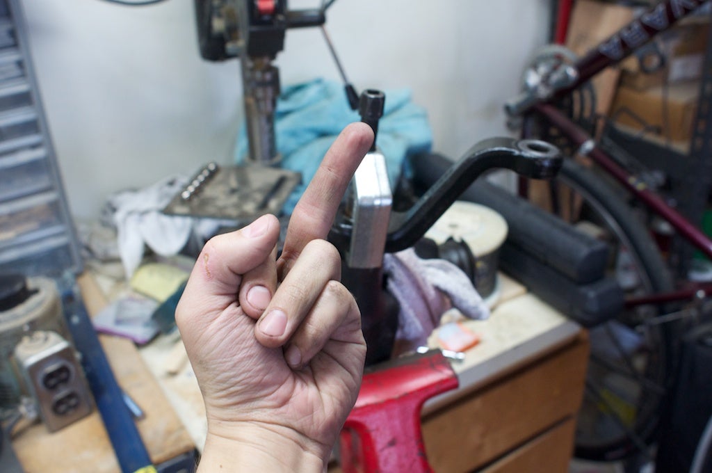

Picked up the steering box, pulled the jeep into the garage to start pulling things off.
They had other ideas.
I was following the durango box swap guide thats around here somewhere. Very good guide, and if there was a durango to steal a box from anywhere near here I would have done that, but alas there isn't.
Drag link tre wouldn't come off at all while it was on the jeep neither would the pitman arm, so I figured I'd drop the thing wholesale.
Steering linkage came right off, helps if you pull the airbox. The fsm says to removing the linkage from the jeep entirely, written for hourly employees I guess
Then I had some room to work, one good hit with the BFH and the TRE popped right off. Bought a new one anyway, why not, and I messed it up a bit trying to get it off the carcass when it was still in the jeep.
New vs old:
Pitman arm was not so fortunate. I've been soaking in pb blaster and beating on it for three days now and nada. After day two I ordered a new on from rockauto.
New arm should be here on wednesday, hopefully I can get it installed then and driveable. I'm working 8am to midnight thursday and friday so I won't have time then.

Pitman arm came in today. So I can give the old steering box back to o'reilly, with bonus pitman arm.
Everything installed pretty quick, new drag link TRE.
And packed up the new tires to get them mounted.
Costco mounts tires for $14 a pop + $4 disposal fee, not too bad compared to the $25 a tire some of the other places around here want. Bonus points as there's a costco on the other side of the freeway from my office, complete with an in-n-out across the street. Cheeseburger for lunch and I have new tires. They may as well be new, still had 90% of the new tire nub things on them. What a steal.
Been working till after dark, so no lift and tire picks yet. Tomorrow. JKS discos came in from kolak today too. Can't wait to put them on, not excited about trying to get the driver side link out.
