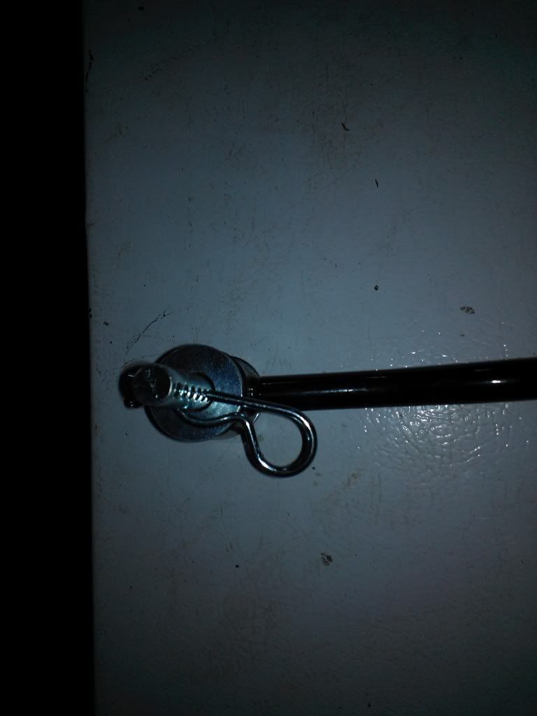

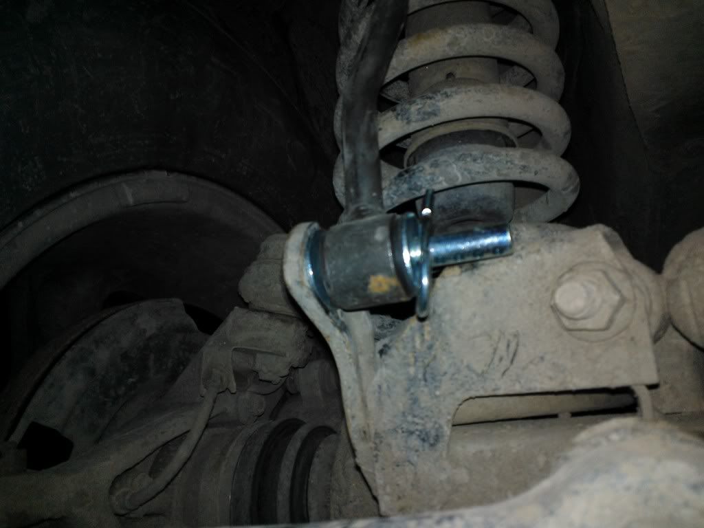

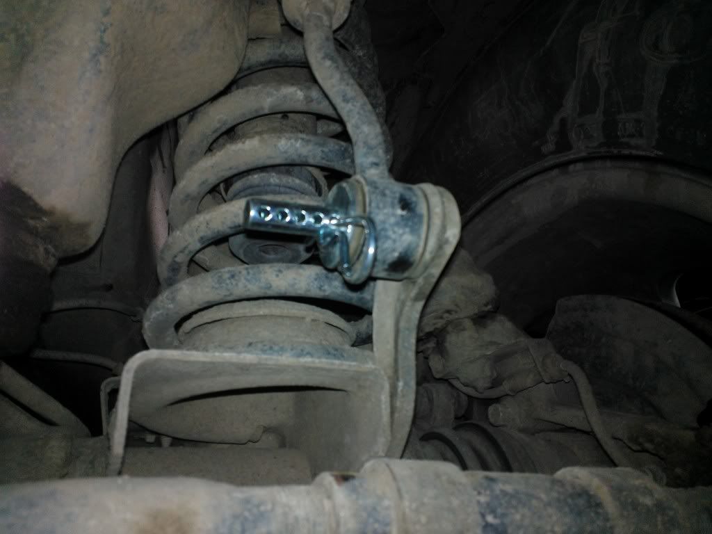

Decided to make me some disco's this afternoon! Grabbed two tine pins (3"x7/16), two cotter pins (fit the tine pins) and 4 washers (7/16) for a grand total of $7.xx at Lowes. Installed and I get this:
Before disco's:
After disco's:
Needless to say, I am STOKED!!

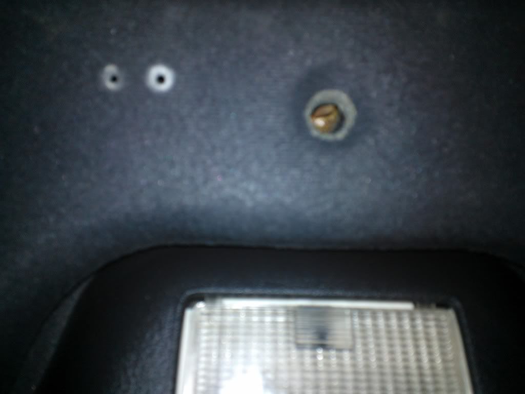

Also took out my soundbar in the back The PO had some funky-a** setup where he had drilled into the roof of the Jeep with sheet metal screws because the soundbar's center nut had come out/gotten lost/idk what the f*** he was thinking, so he drilled holes. Drilled. Holes. In a niner! Anyway, it was rattling and squeaking every time I hit the tiniest bump in the road (it was maddening on dirt roads) so I had to take it down until I find a center-nut for it. G********. PO's are stupid
Here's a crappy phone picture of the nut that isn't there and the space where it is supposed to go:

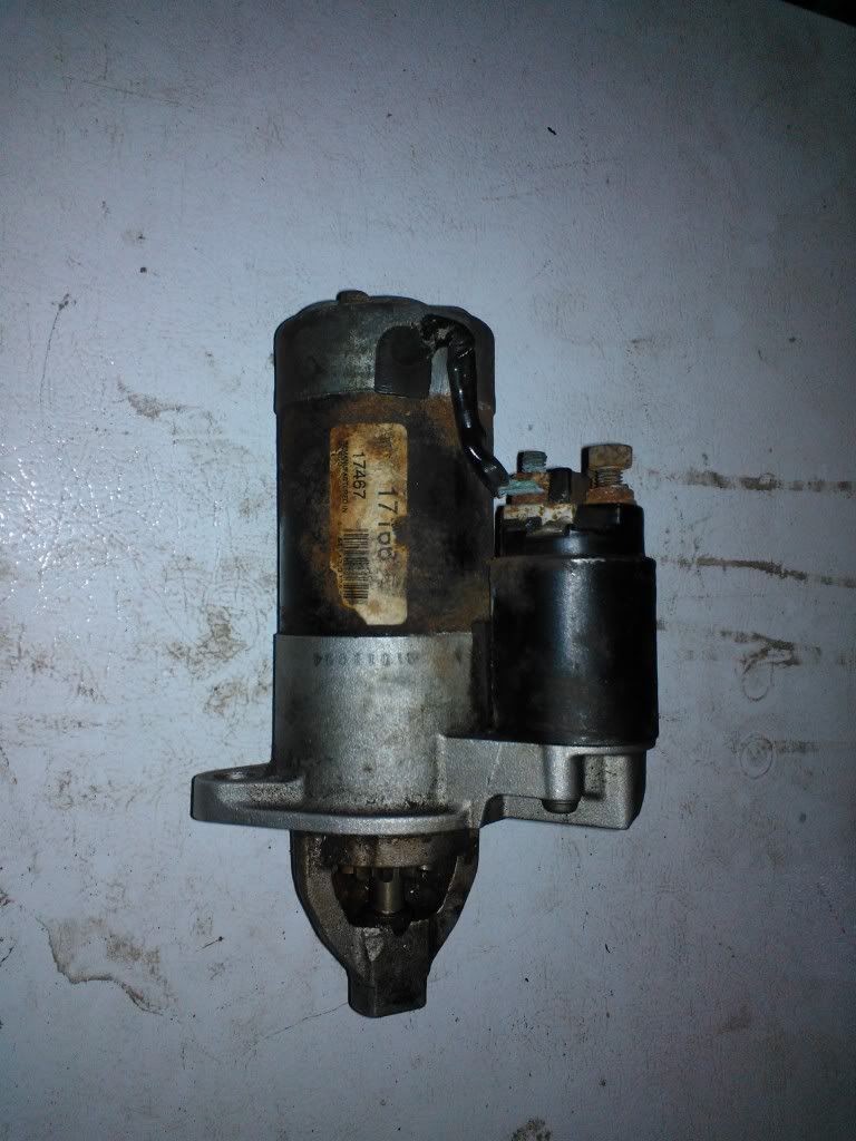

And I took my spare starter apart today. Should probably have cleaned it while it was in pieces, but this was the first time I had taken a starter apart, so I was really just testing the waters before I got too in-depth in cleaning the thing. Probably a good thing I waited too... Managed to put it all back together again, but it took me a solid hour, maybe more. Oh well, a learning experience.
Random pic of my starter? Sure, why not?

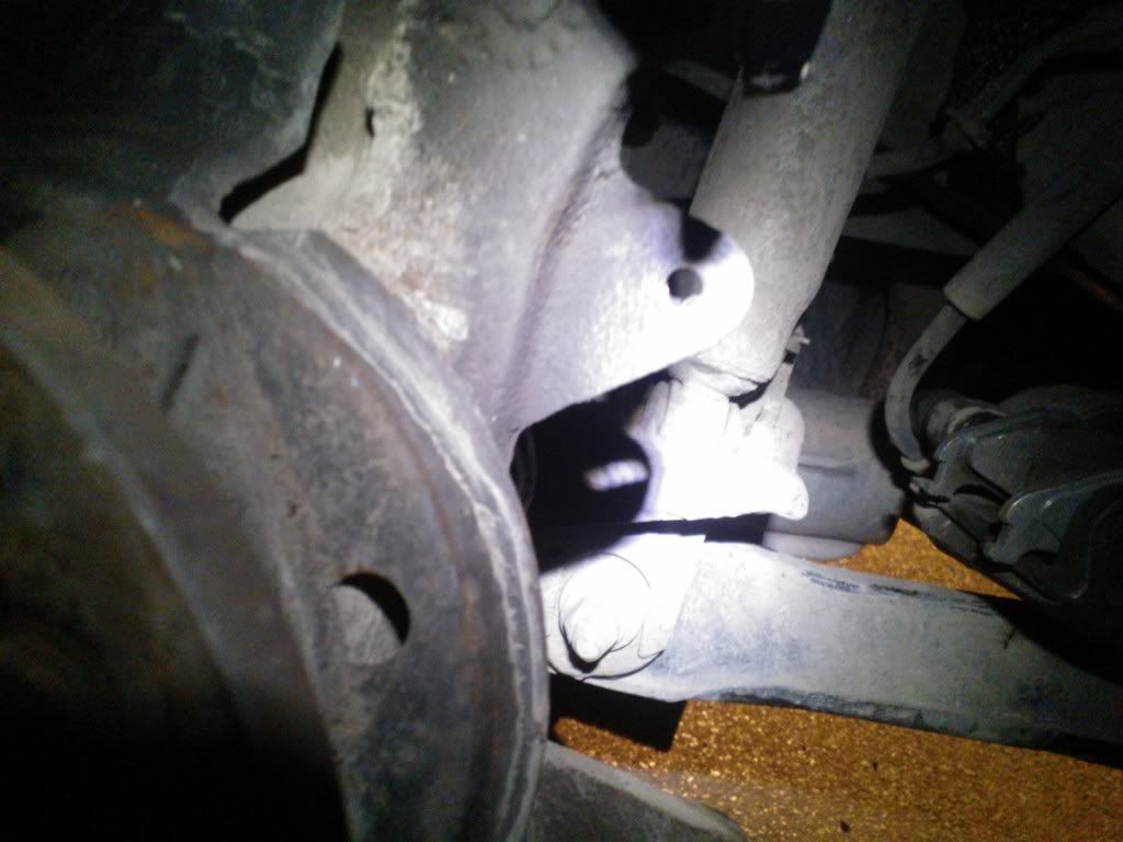

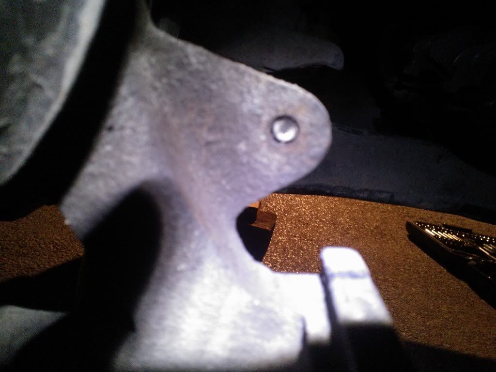

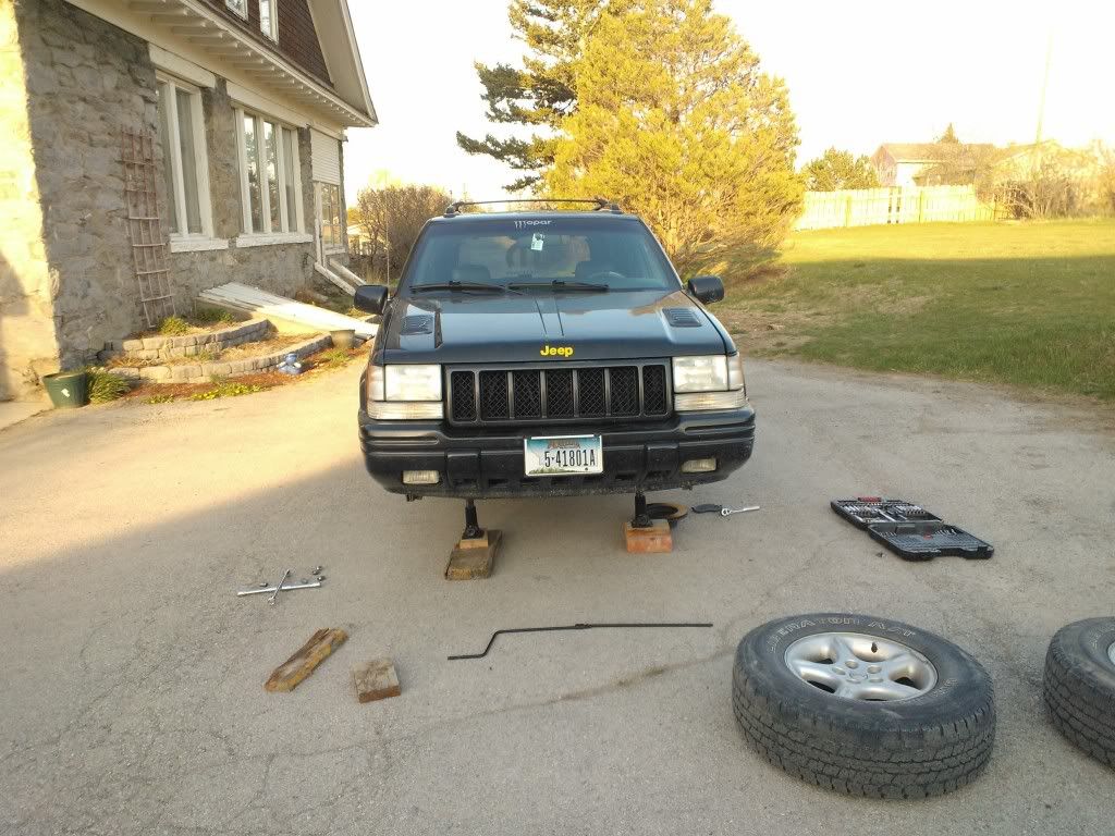

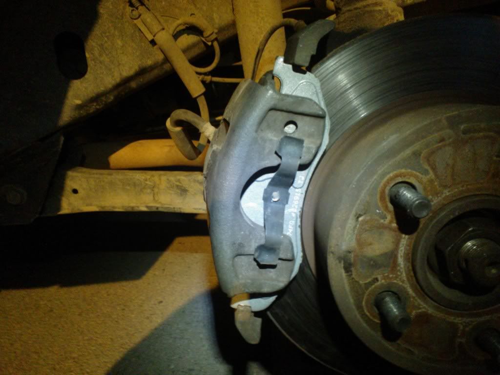

Took a short trip down a bumpy road. Long story short, didn't make it 10 miles before the strange clunking in the front got the best of my paranoia. Couldn't figure out what was going on, so I flipped a U-ey in the middle of the road and crept back to town. It stopped on the interstate. On the way back to the interstate, though, my brakes were intermittent. Actually, instead of intermittent, it felt like the master cylinder was getting low on brake fluid. Brake peddle to the floor and not much response. So, got it home and up on some jacks:
As I was down there and taking off the drivers-side wheel, the caliper fell off So now I'm freaking the f*** out... Get to looking closer and realize that the passenger side looks right. Like this:
Where the drivers side looks like this:
Notice anything missing?

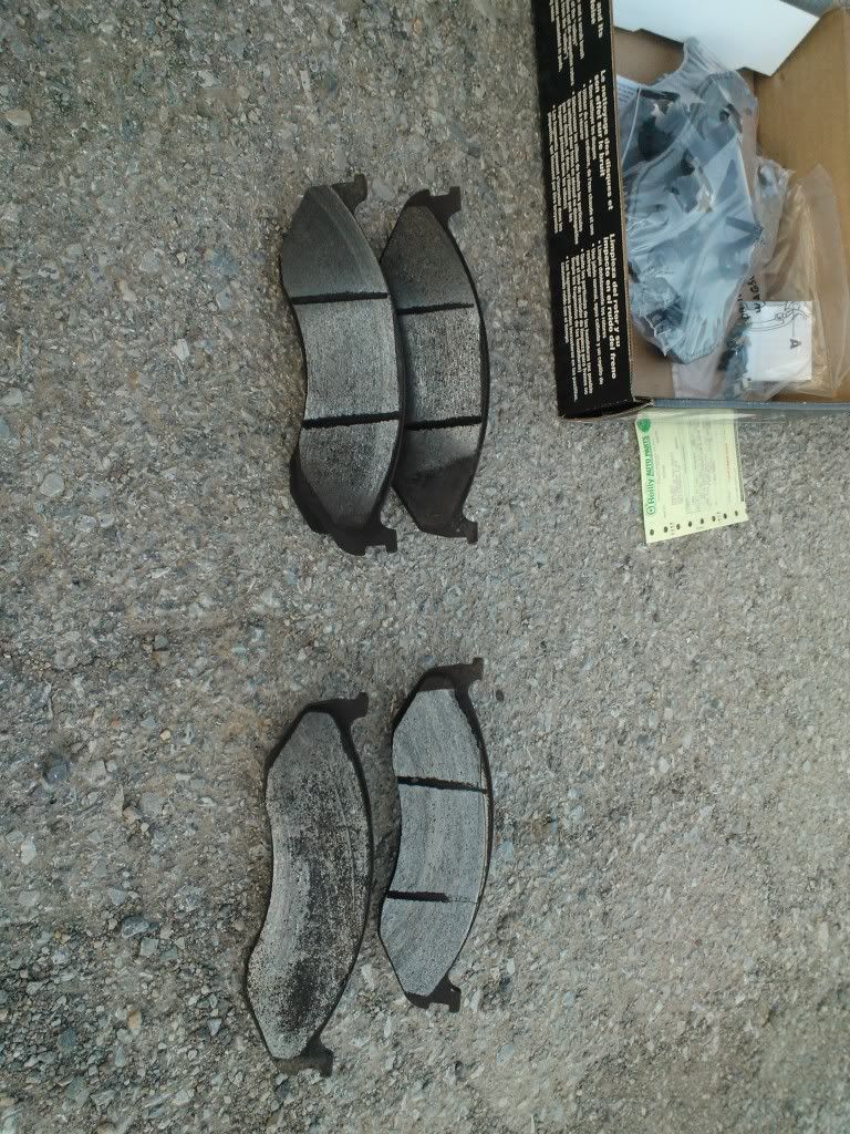

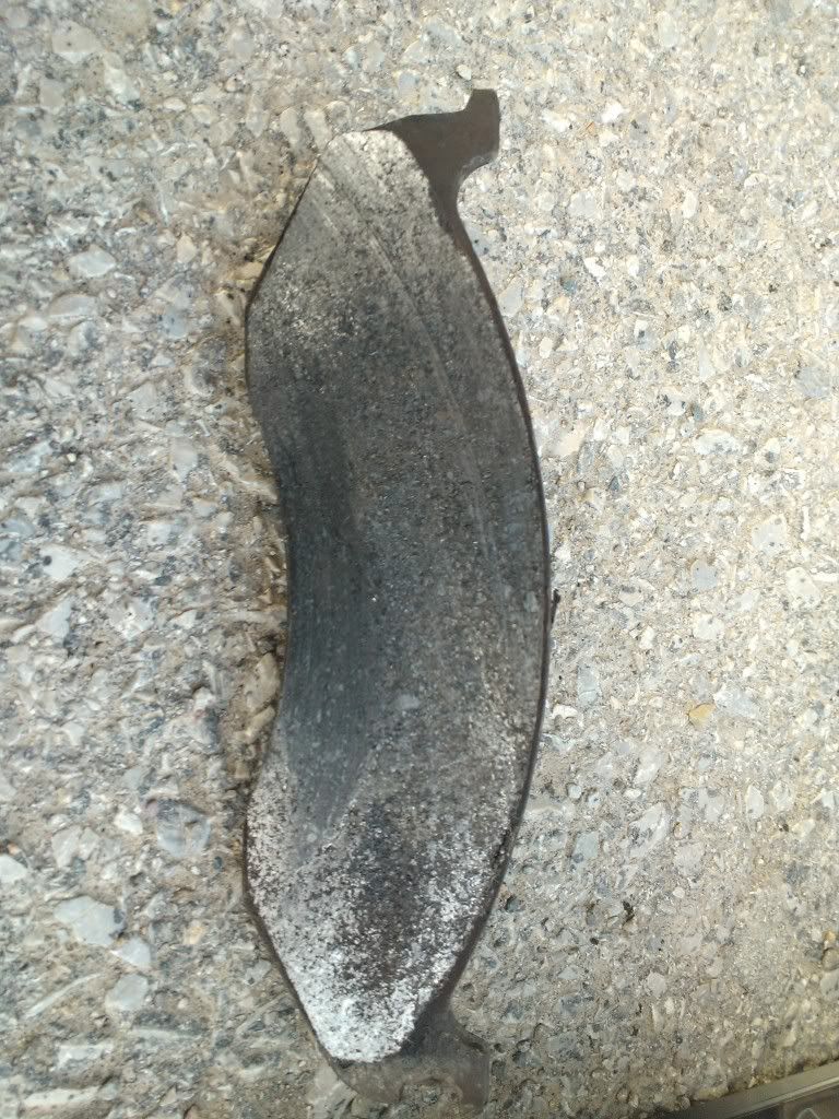

Got back to Asteria and took the brake pads off. The drivers' side looked like this:
The old had uneven wear all around. I'm surprised I had any brakes at all...
All four:

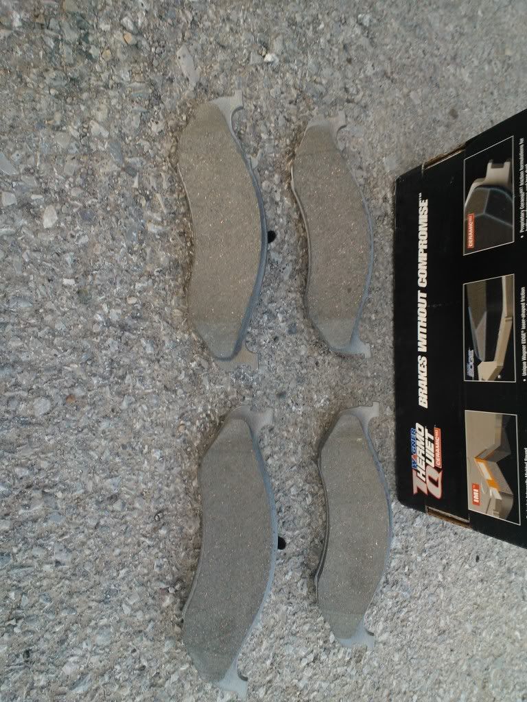

And the new ones:

But when I got to the drivers' side, the lower retaining bolt would NOT go in! Top hole:
Bottom hole:
The previous bolt in the lower hole had sheared off inside, and it's flush. So I get to wait overnight before I can grab a left-hand 9/64 drill bit to drill the damn thing out
