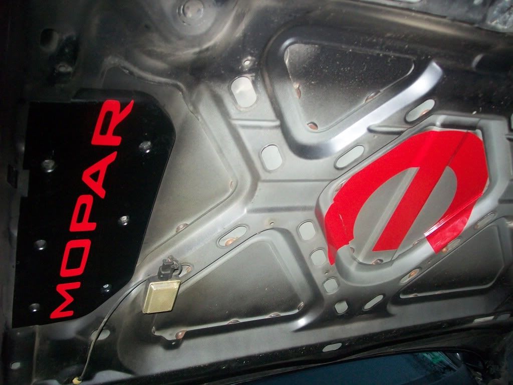

Big thanks to Dumpy for the cubby! Fixed my annoying VIC problem in under a half hour!

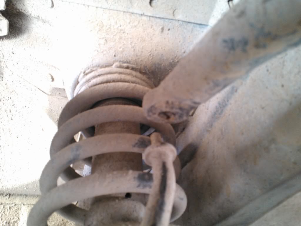

Found the source of the passenger-side clunk...
Drivers-side sway bar end link:
Passenger-side!
So. Gonna be grabbing a new sway bar end link from O'Reillys on Monday, because I don't think I can buy just the bushings and hardware alone. That takes care of one of my problems at least! Now, does anyone know the nut size on the shock mount stem? I can't figure it out to save my life!!

You can buy just the bushings through companies like energy suspension and prothane but that will not help you. That endlink is broken. Needs to be replaced.
