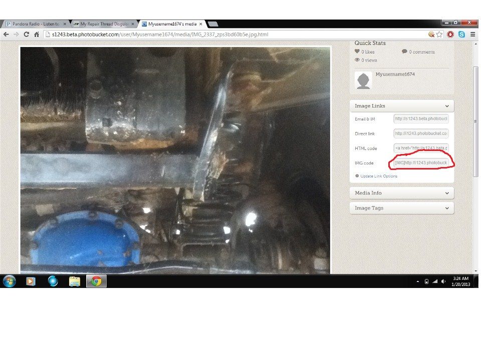

Myusername1674
Location: Chattanooga
Posts: 2,310
Hey man, to post pictures with titles and such, what you do is go make an account on Photobucket, upload your pictures there, and then copy the "IMG code"
Paste it to your post and then it should work for ya
