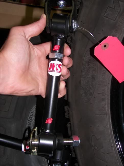

v8 UC ZJ coils for the rear
With .75 inch spacers
and 4.5" RE front coils
And JKS front and rear Trackbars
All this to clear 32" MT/R's on 15x8x4bs Cragar Soft 8's
Waiting for the last couple parts to arrive so I can install the lift and tires starting this coming saturday night and finishing up memorial day monday.
