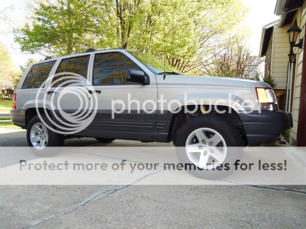

post #74 of 92 Old 05-03-2014, 04:29 PM
E55&98 Jeep
Location: Maryland
Posts: 47
I finally got some good weather to try it out and I'm amazed how great it worked. It looks like a new Jeep every time I look at it. Thanks
E55&98 Jeep is offline
