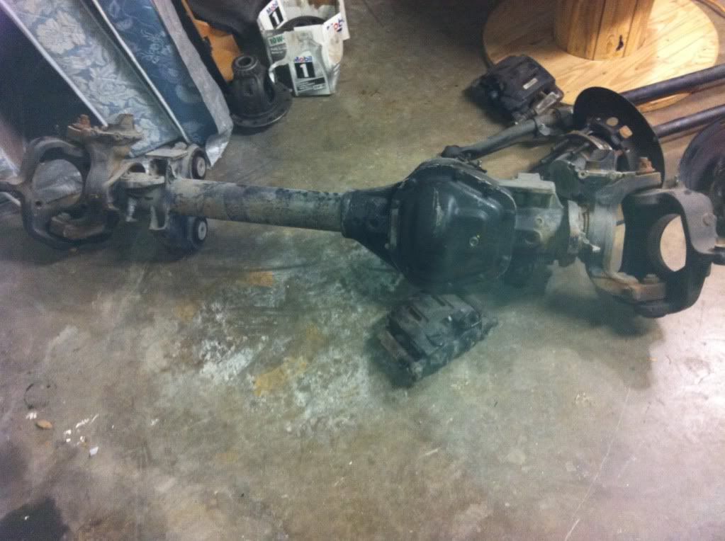

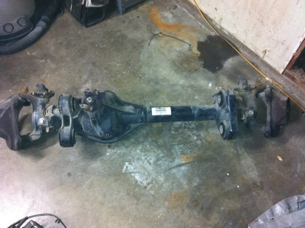

Got my front axle on Monday.
2004 Super Duty Dana 60.
This thing is beefier than a black angus bull.
It is approx. 75" wide from mounting surface to mounting surface (hard to really get an accurate measurement with the shafts and such on it)
Not a bad axle to get for $900. Should last longer than the jeep will with those .5" thick axle tube walls and 1.5" shafts.
Down sides are the weight (which is actually not that bad considering the size, I can pick up the driver side of it without struggling...without the shafts and such on it...), the strange metric lug pattern, and the mounting brackets on it (the driver side is cast in with the diff housing)
I've seen a couple people work around the mounts and cut them off and do custom ones, which was my plan at first, then I got to talking to my buddy about using them and just doing sort of a custom radius arm setup... Still trying to decide what I want to do.

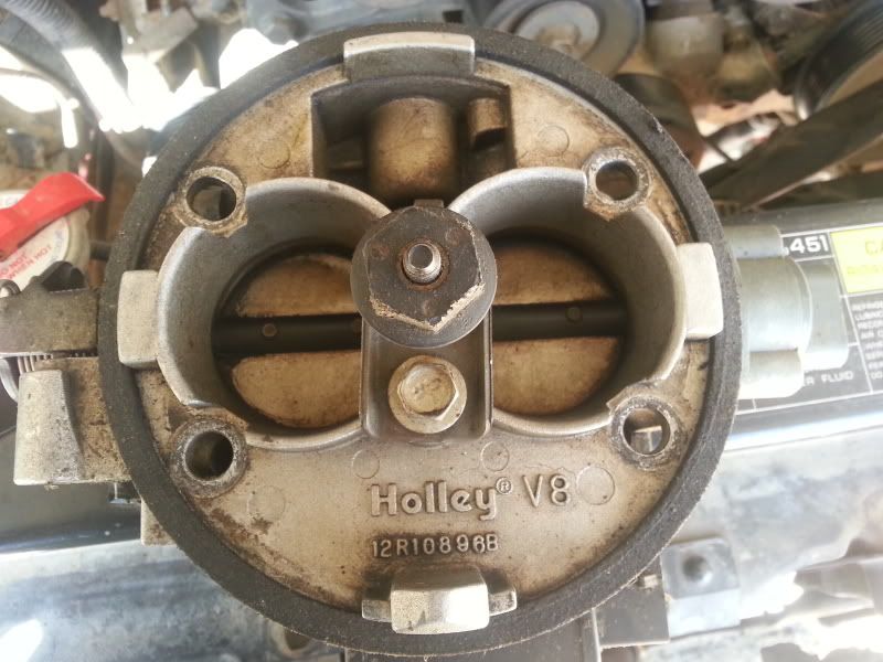

Pulled out my IAC to check and clean it.
Pulled my throttle body to prep for cleaning too, it could use it! pretty dirty on the underside.
Here's a look into the intake, can't see much but I was trying to emphasize on the openings and how dirty they are.
Looked at the Dodge forums to get a good how to on the kegger mod, they say there are only 2 vent ports on each side of their intakes... does anyone else have 3 on both sides?
