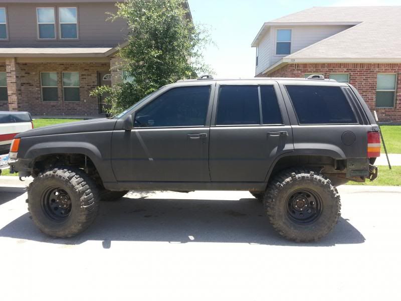

Recently purchased my first ZJ. (About a month ago)
It's a 1995 Grand Cherokee Limited with a few quirks here and there and could use some TLC and the right touch, but I love her!
I bought it for several reasons:
1. I am a Mopar/Jeep lover!
2. I am very passionate about off roading and rock crawling.
3. It was the right vehicle for the cash.
4. It already had a 4" lift and 33" Boggers.
5. I am having my first child in September, so I needed a more "family friendly car".
6. I love the paint!

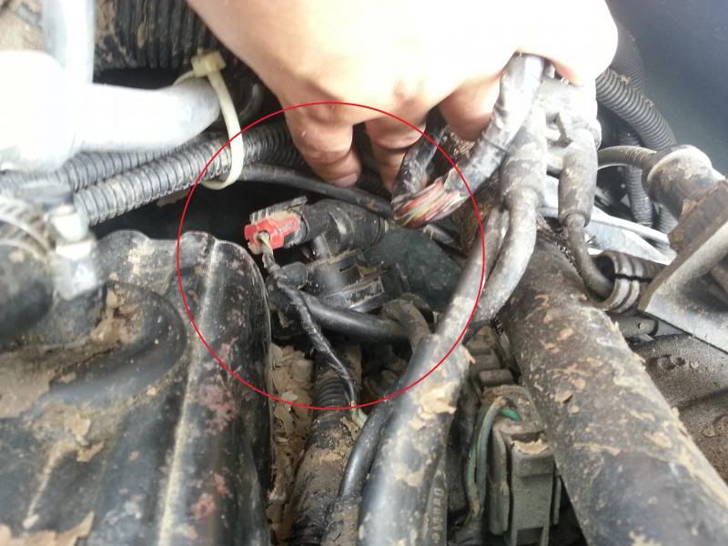

I have a few questions for anyone who reads this. I believe it is part of the vacuum system but who knows?!
What is this and what is it for? (Located on back side of driver side valve cover)

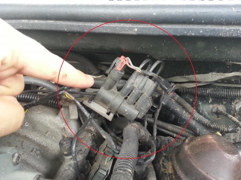

What is this and what is it for? (Located behind passenger side valve cover, has a vacuum looking line that goes to the throttle body)

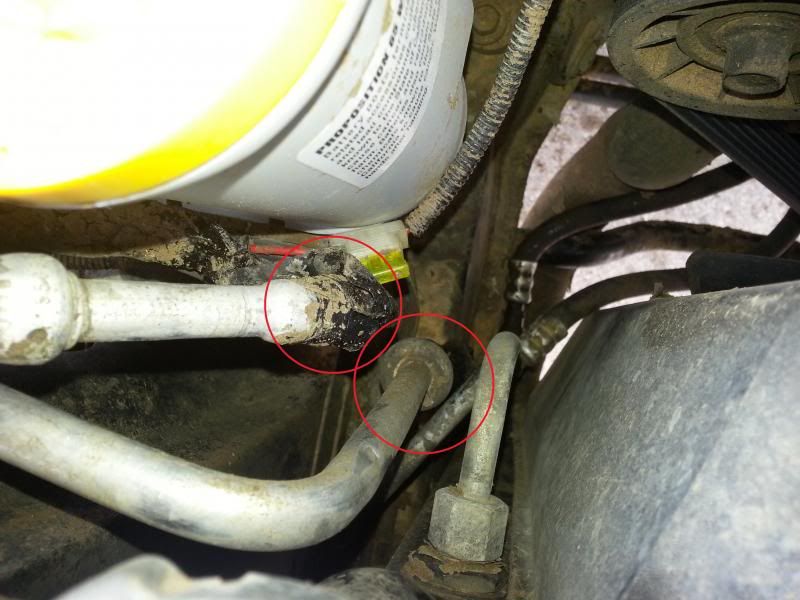

What part am I missing? I believe one of those lines is the low pressure line to the fire wall and the other goes to the compressor.

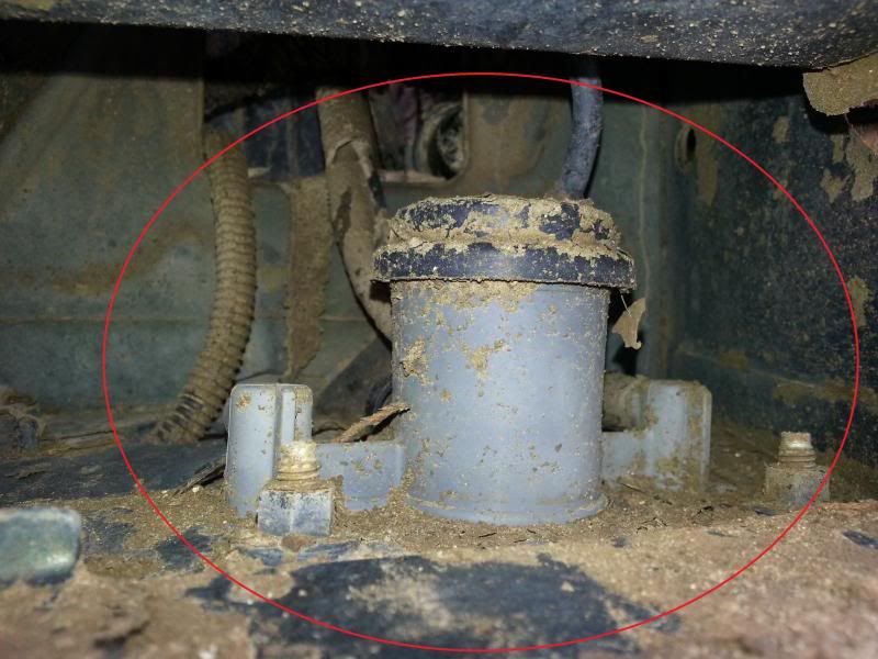

What is SAM HILL is this and what is IT for? (Located behind bumper, under head light on driver side, it sticks out from behind the bumper at the bottom too. It is a big cylinder)

first pic is the vapor canister purge valve, dont ask me what it does because i dont know. second pic is the transducer for the EGR.

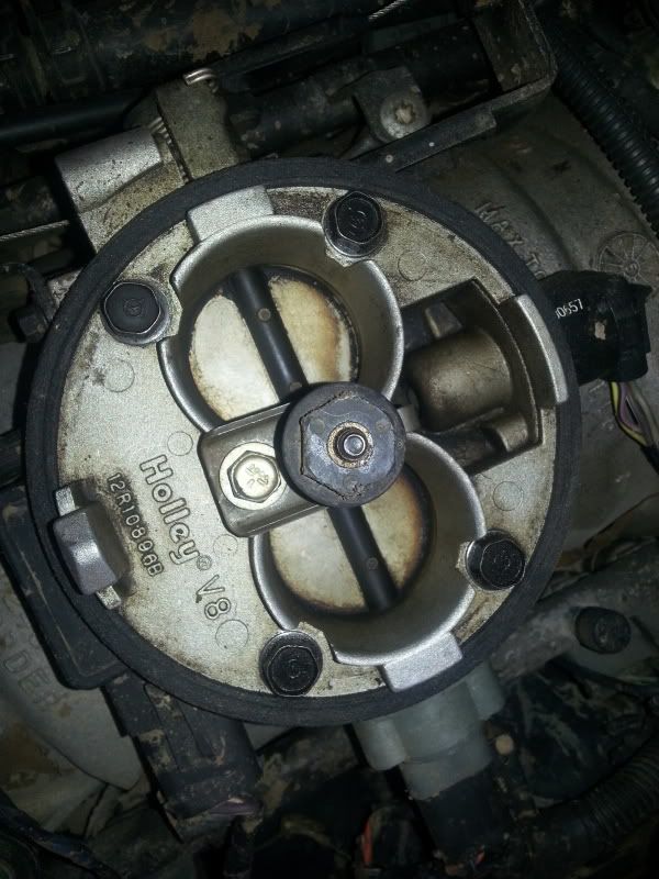

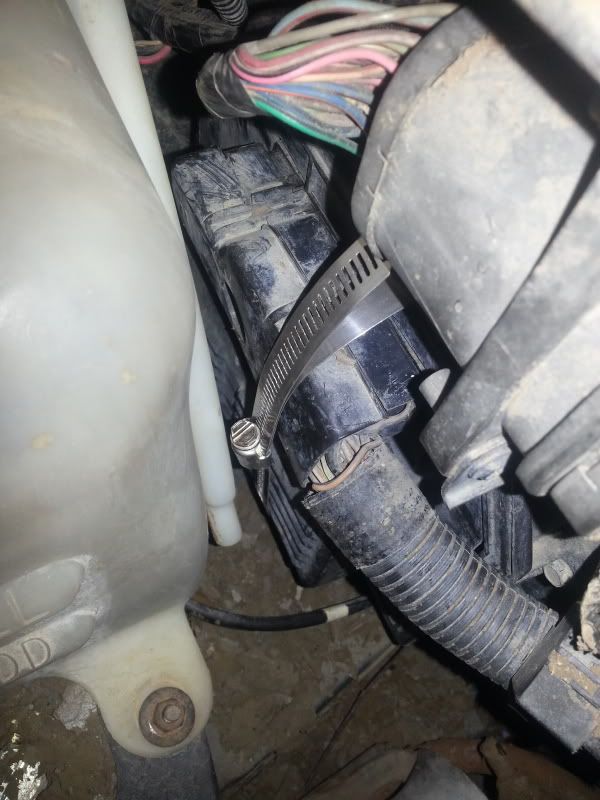

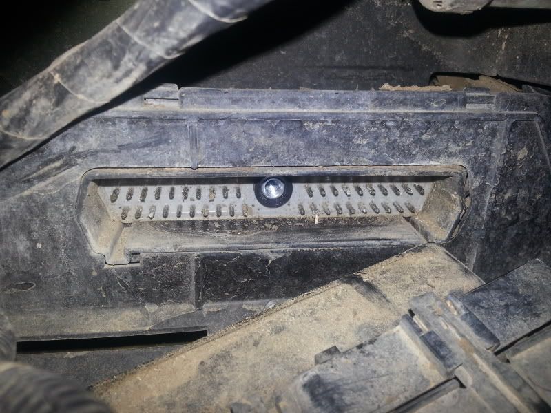

Posts: 24

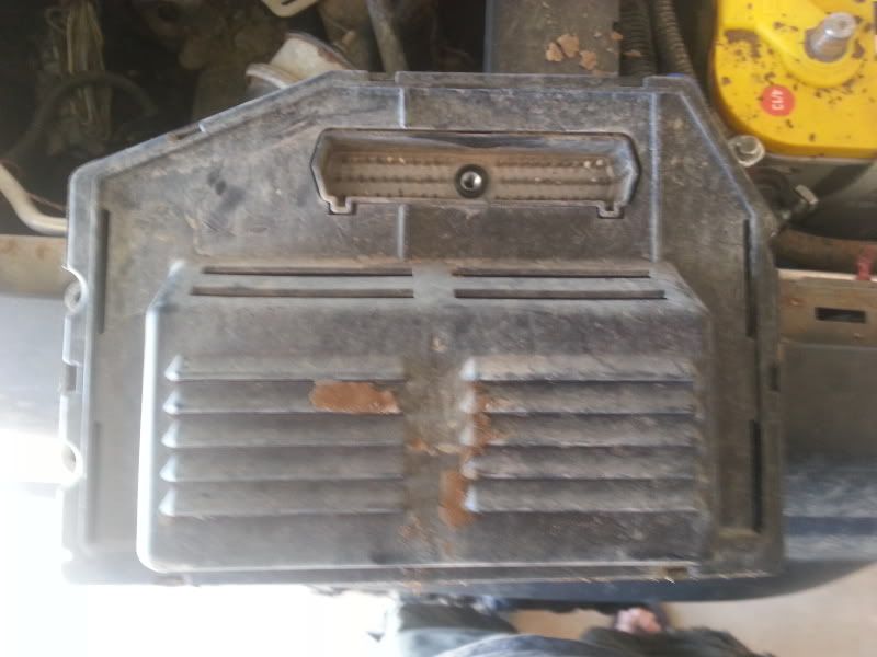

So recently I have been having issues with my ZJ stalling when I stop at a light. Looked around and saw the Dirty Dozen thread. Lots of very good information in there and saw the ECM fix (zip ties/hose clamp). So I went out and got a hose clamp big enough to go around my ECM. Came back, took out my ECM and cleaned it up a bit, it had a lot of dirt from the last time I had went out on the trail with it.
Reinstalled it with the hose clamp on and took it for a test drive. Nothing changed... still stalling, after the jeep warms up, when I come to a stop. Maybe I didn't clean the contacts well enough or not enough contact grease. Keep in mind, mine is a 95 and has the one big connector with the bolt and it seemed to have pretty good contact before and after I cleaned it, so maybe its a bad ECM. I'm not sure but I figure I will just keep going down the list until my problem is solved. I do think I have a vacuum leak though, No real evidence other than my intake is pretty dirty on the inside, I have a slight ticking noise, and it is on the list.

post #7 of 27 Old 08-06-2013, 10:40 PM
dnuccio
Location: Phoenix
Posts: 3,480
try cleaning the IAC valve. thats the sensor lookin thing at the back of the throttle body. theres a write up in the FAQs
