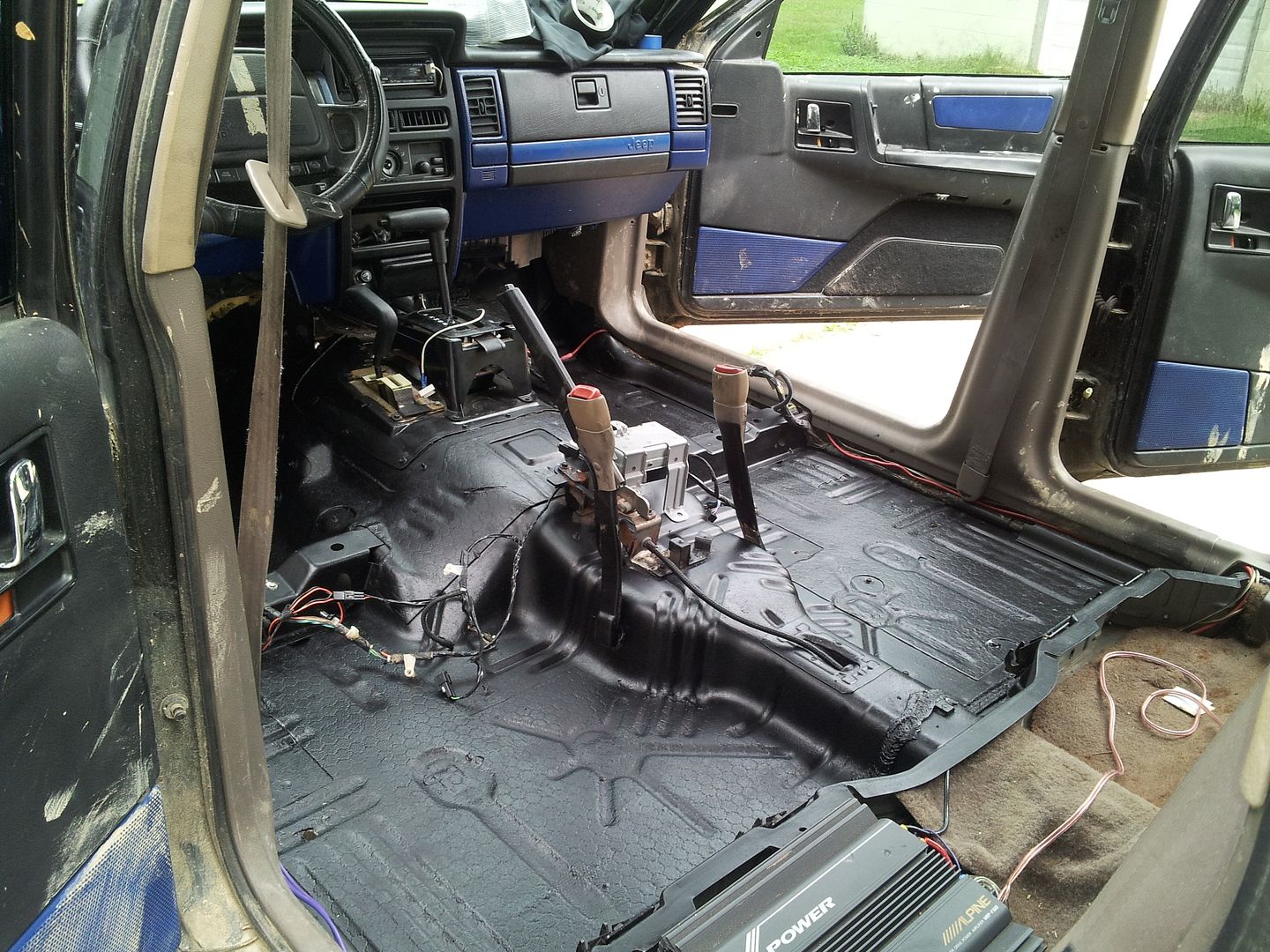

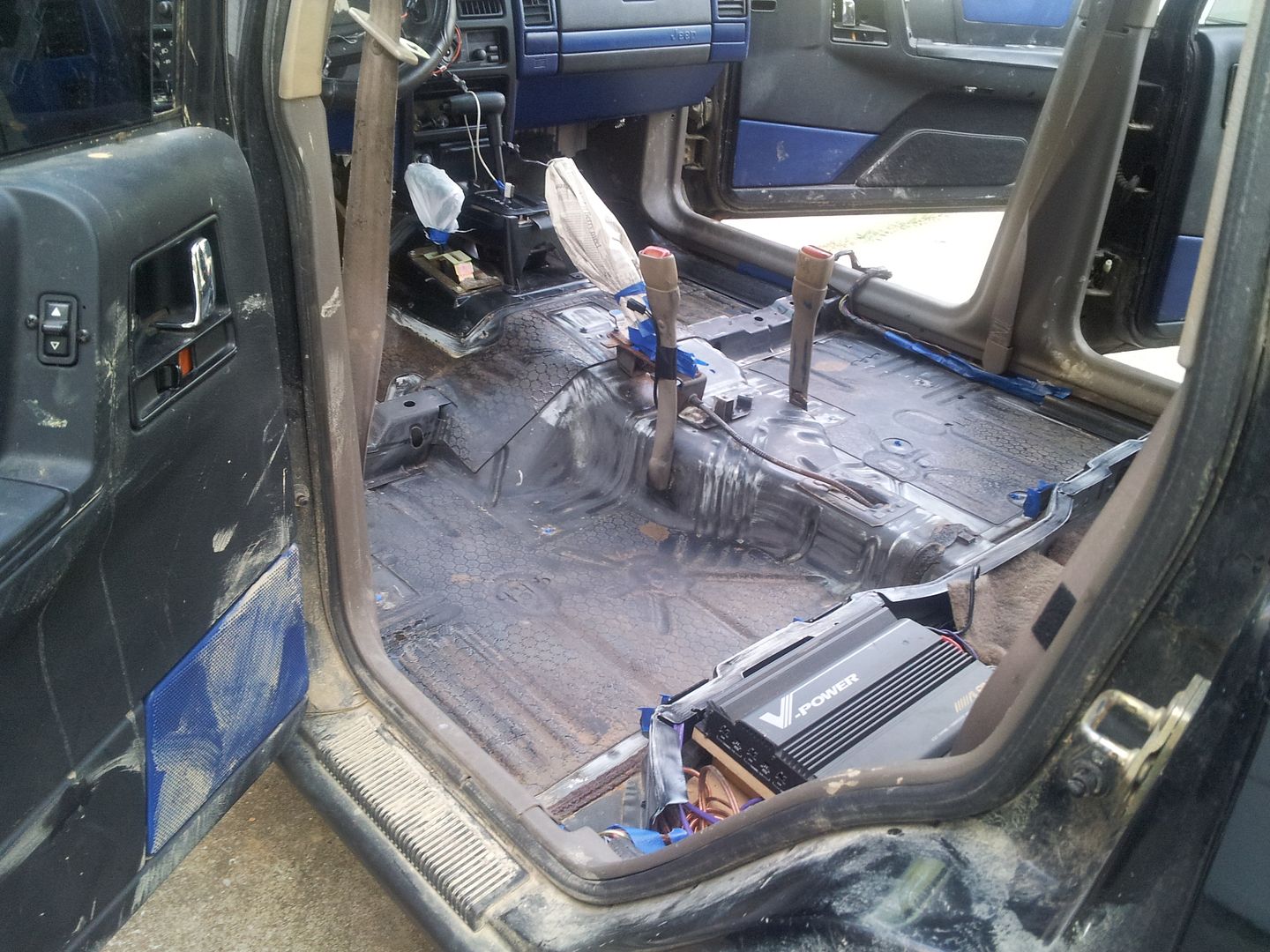

Floor Bedline

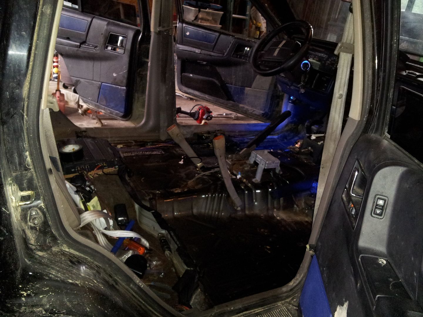

Alright, so I've been slowly but surely working towards bedlining my floor. Started about two months or so ago by simply ripping out the old nasty muddy carpet.

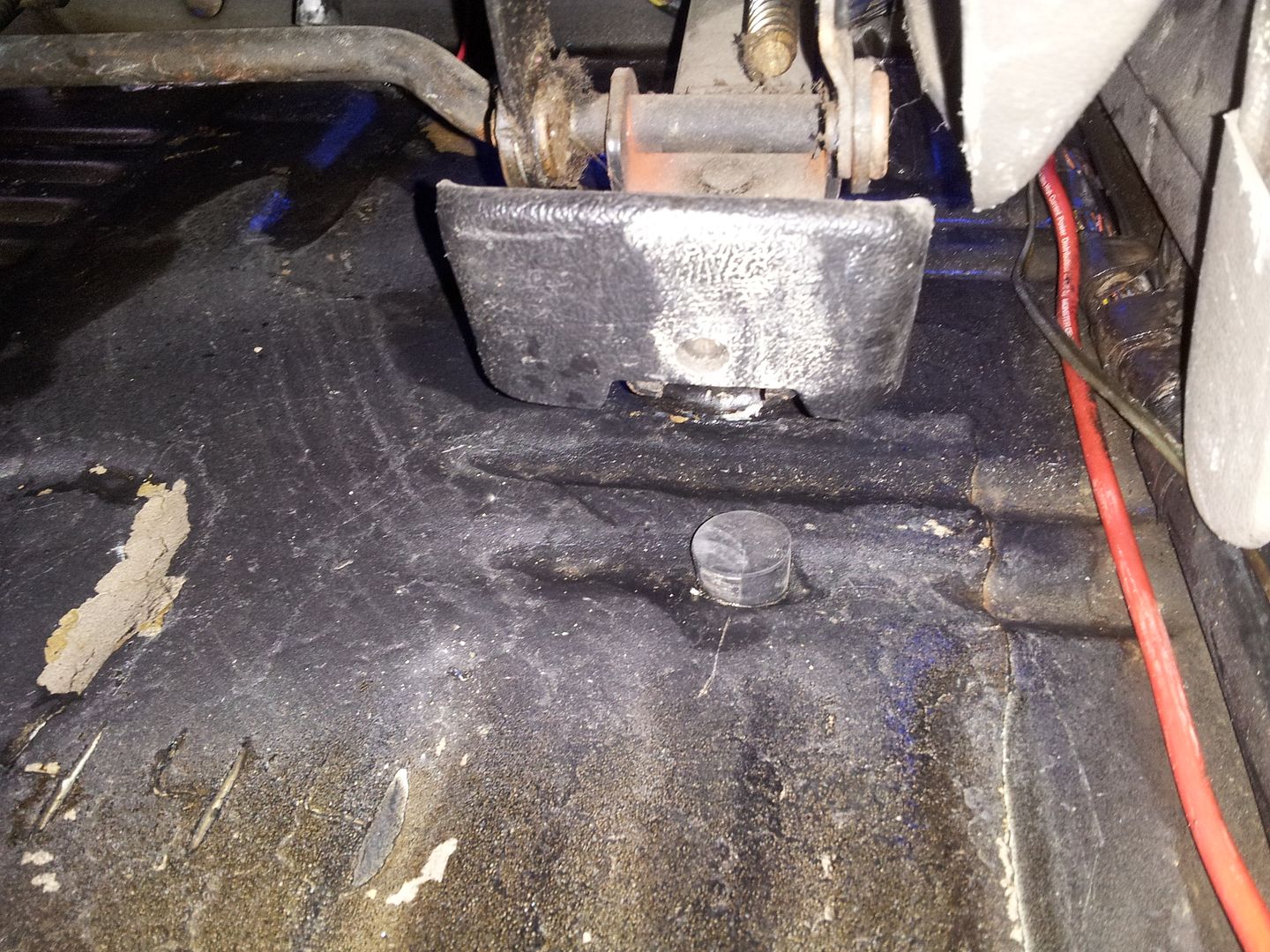

I drilled a couple holes in it so I could drain water if/when I sink it mudding. Just threw some cheapo rubber corks in it, water tight: enough.
I finally got around to sanding it, then cleaned it up so it was ready for lining.

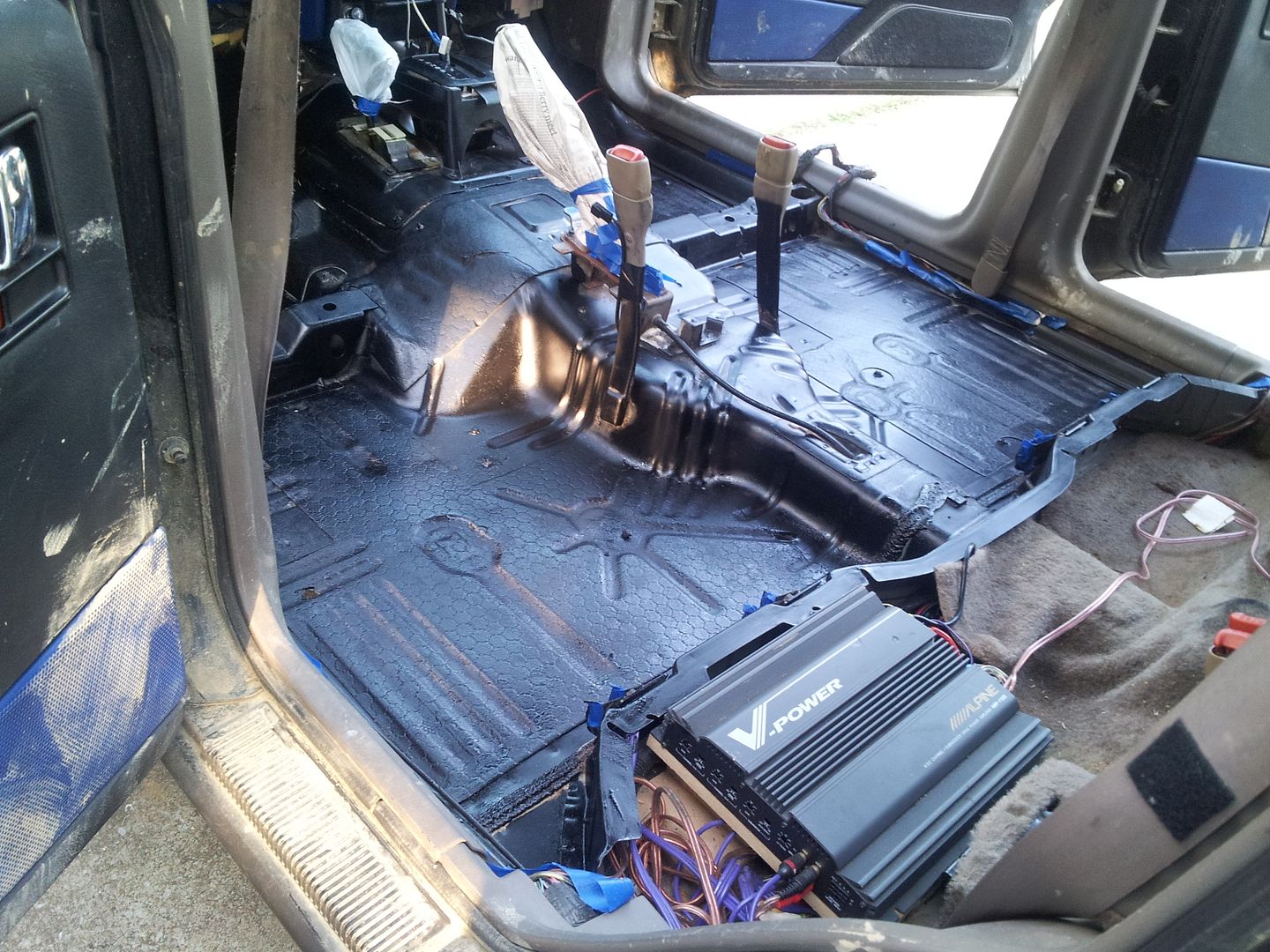

Coat 1
Coat 2
All done and back together
I ended up going the cheap route and used Rustoleum bed liner, I used one quart and it was only $20. I know, I know, it's cheap and probably won't last. But I'm short on cash and needed to get something on my floor before I go wheeling again and I couldn't stand the floor looking so trashy.

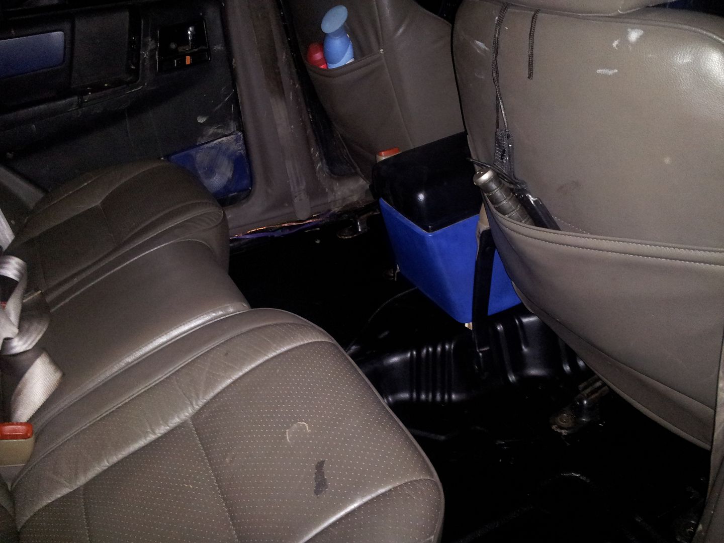

I'm surprised you didn't do under the back seat. I took out the amp out and bed lined under mine. That carpet was smelly and nasty from the PO. Can't wait til I bed line the rest! Looks great!
Thanks man! Haha yeah, honestly, i never even thought about doing that part... I really should have while i had it all out. I may go back and do it later someday when im bored as i've got a little bedline left...

What did you do with all the wires that were under the carpet? I'm thinking of doing the same thing, but unsure of what wiring is under the carpet and where to hide them.
I actually just left everything, The wires going to the seats are hidden enough under them, then I have rubber floor mats in the front to hide the wires in the passenger side. The rest of the wires run along the side below the trim, and I just left all of it alone.
