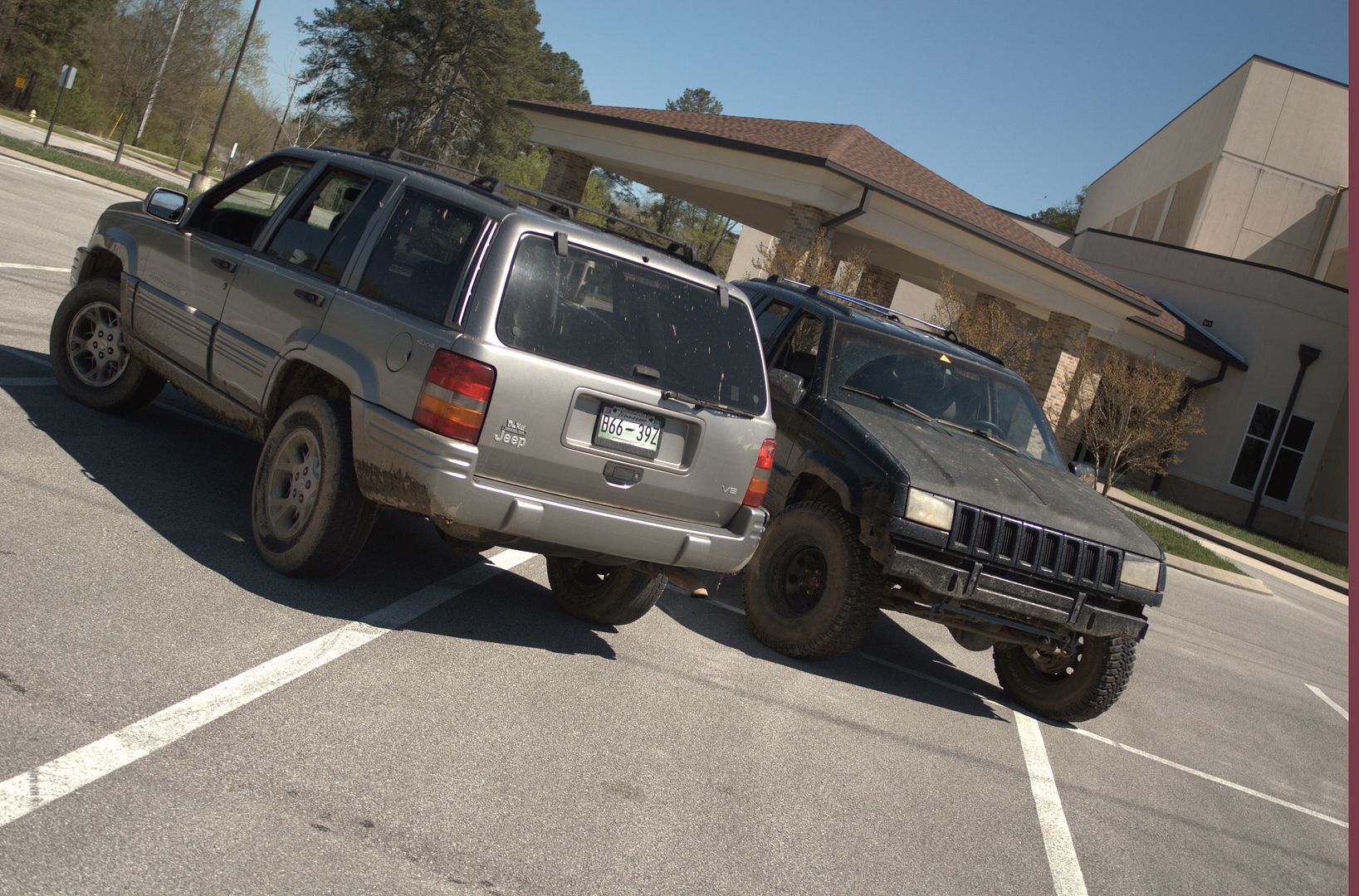

All that aside here's my Jeep when I first got her and then with the current setup
My Jeep:
5.2L V8
NP231
Lockright front
Super 35 w/ Detroit Rear
4.5 front lift, Adjustable CA's
RE front double sheer trackbar
5ish rear, Adjustable CA's
JKS rear trackbar
Trimmed
35" Goodyear Wrangler MT/R w/ Kevlar
Black Soft 8's
RC winch plate+homemade tube front bumper
Smittybilt XRC
KOR d-ring shackles front
Trailer hitch d-ring rear
