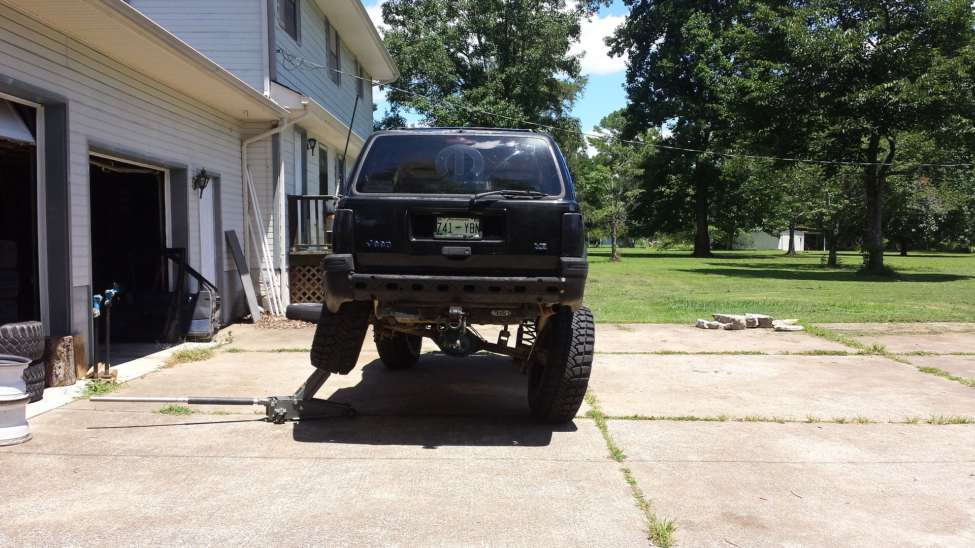

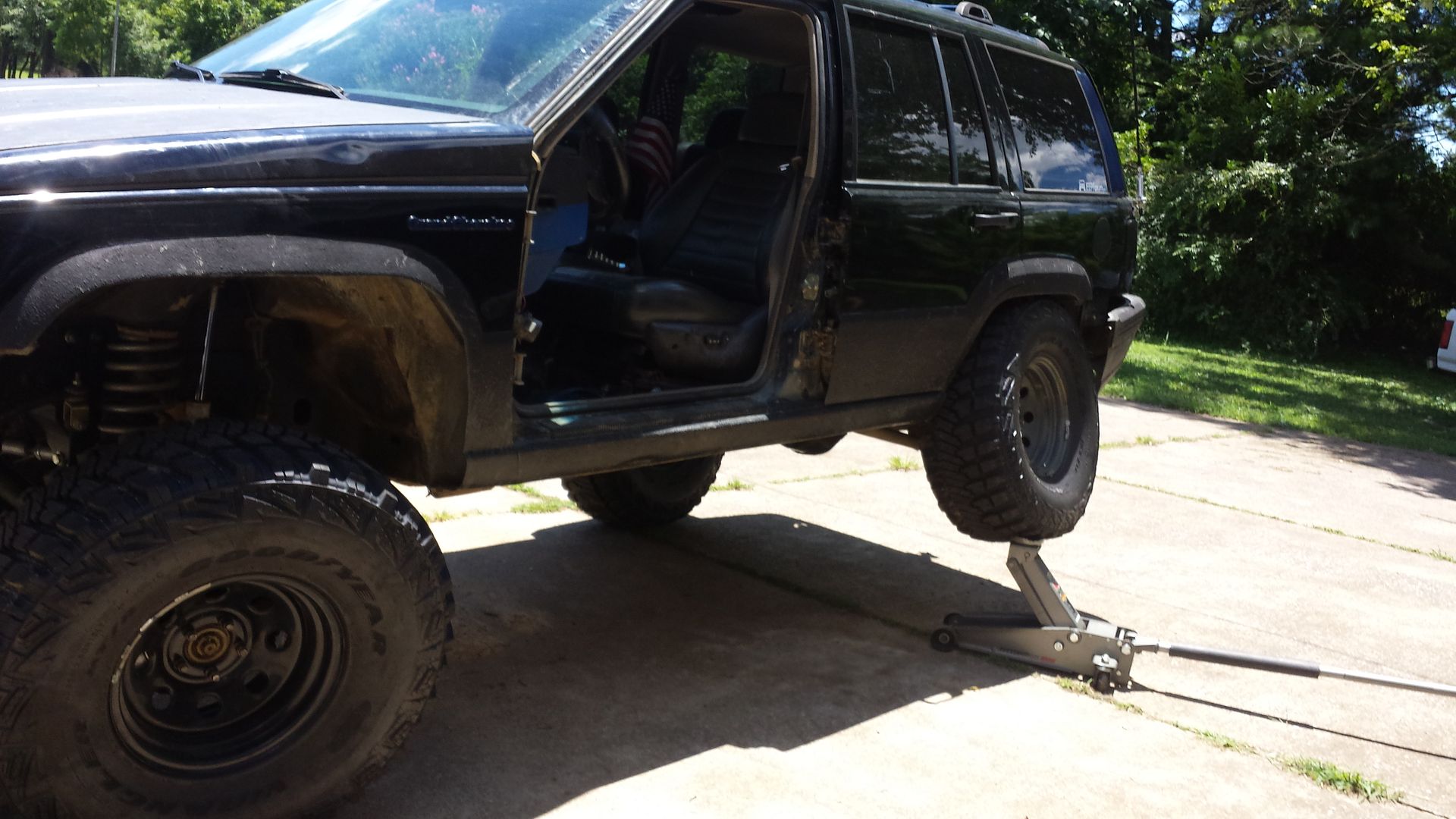

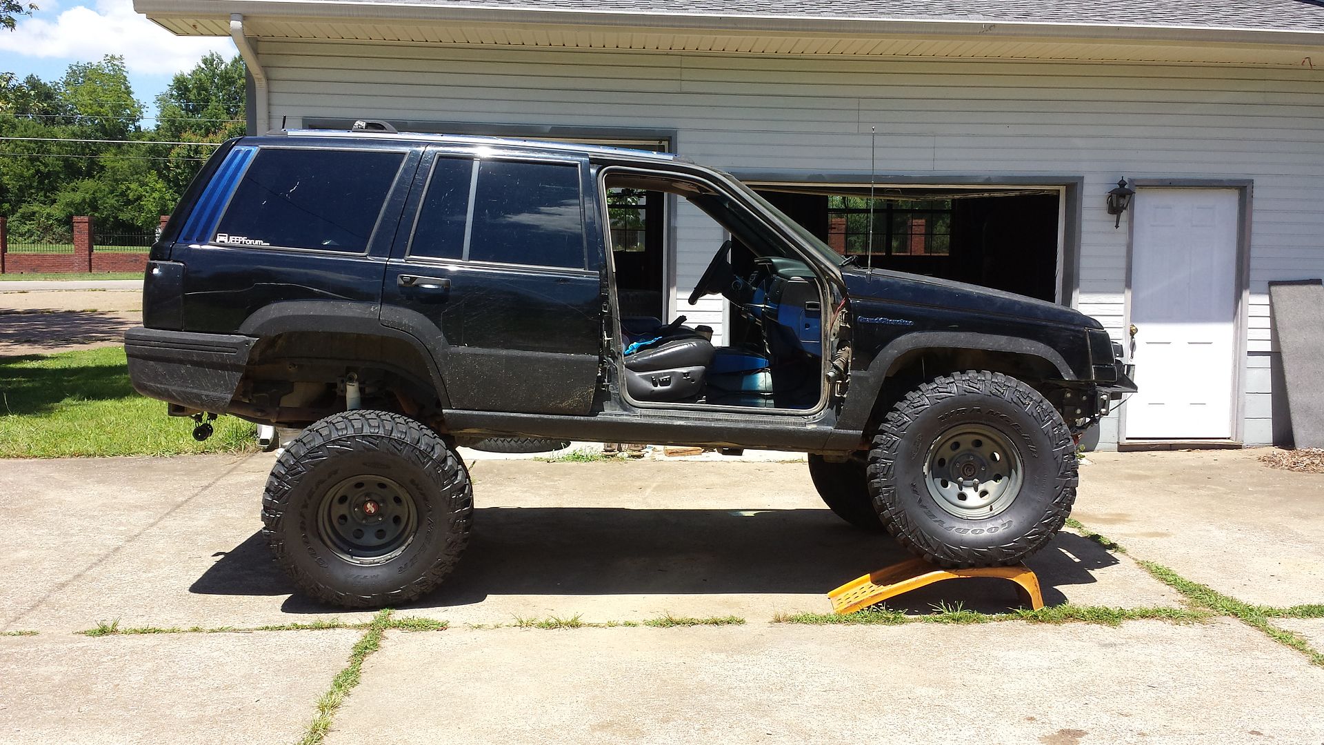

Alright so it's finally time for some measuring on this thing. I'm about to order some rear shocks and new bumpstops that are appropriate for these big *** tires.
(About to go to a loading ramp to do the front, can't get it flexed enough at home...)
Front shocks:
Extended: 28 +/- 1"
Collapsed: 19"
Bumpstops: 6"
Rear:
Extended: 29 1/2"
Collapsed: 19 1/4"
Bumpstops: 6" extension
Limiting straps: 23"

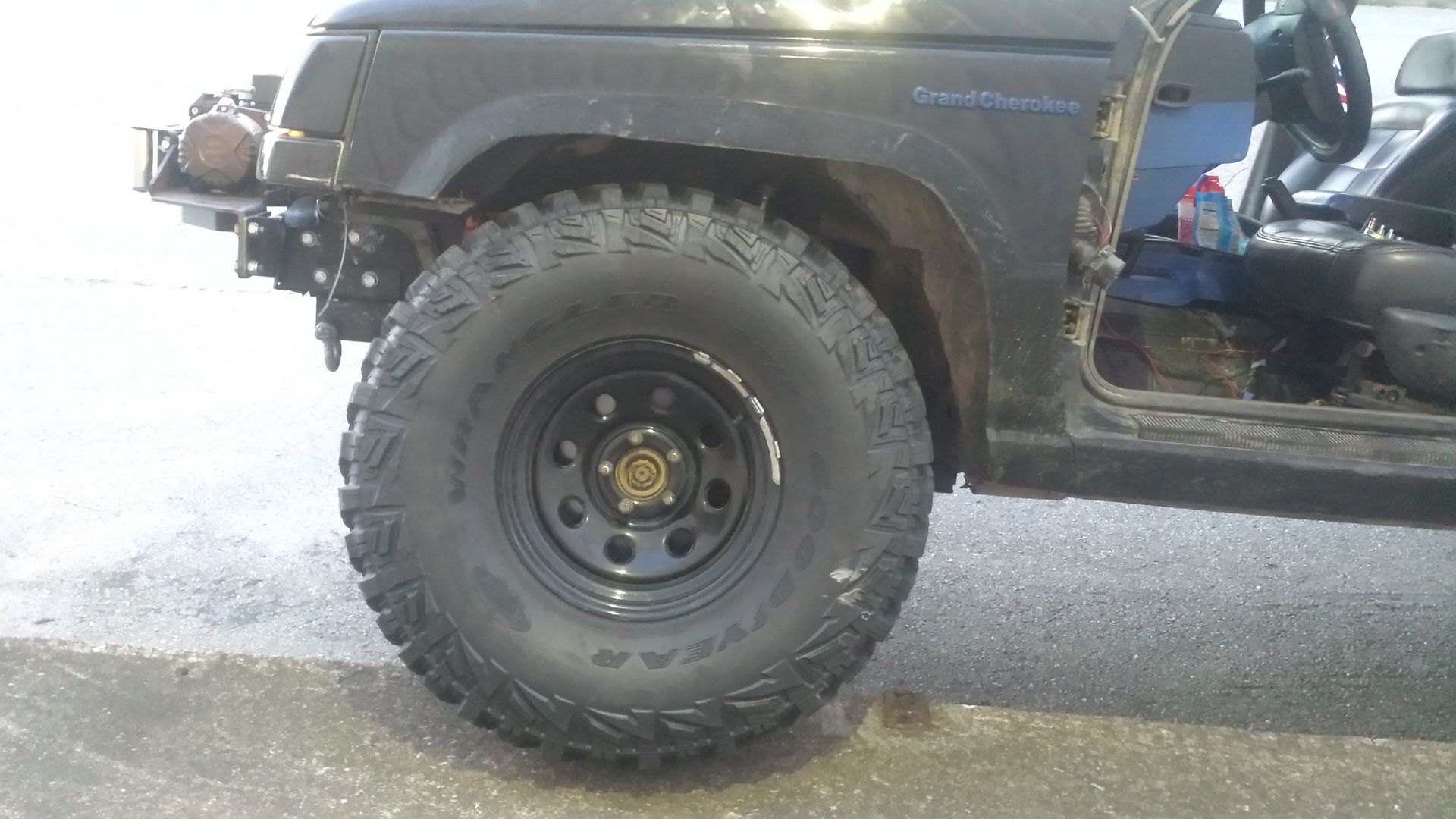

post #352 of 414 Old 08-05-2014, 12:46 PM Thread Starter
Myusername1674
Location: Chattanooga
Posts: 2,310

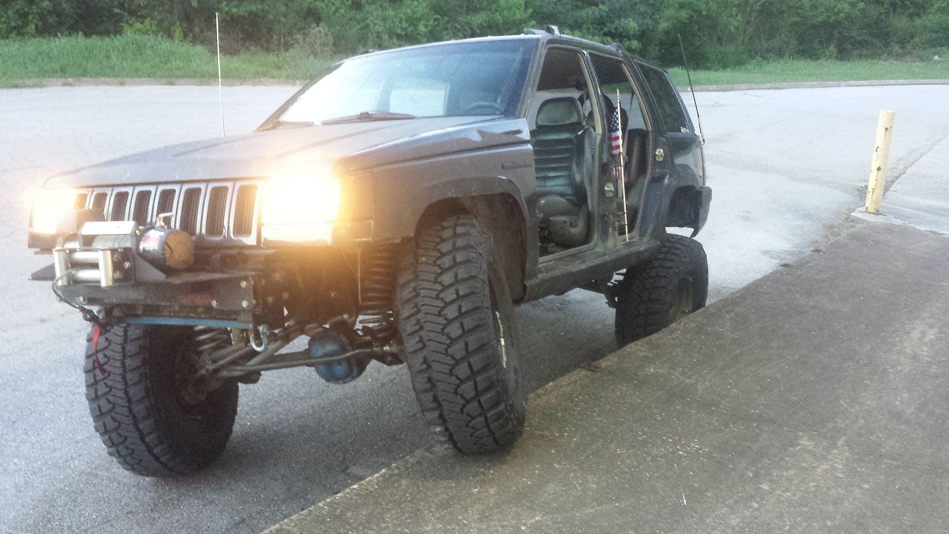

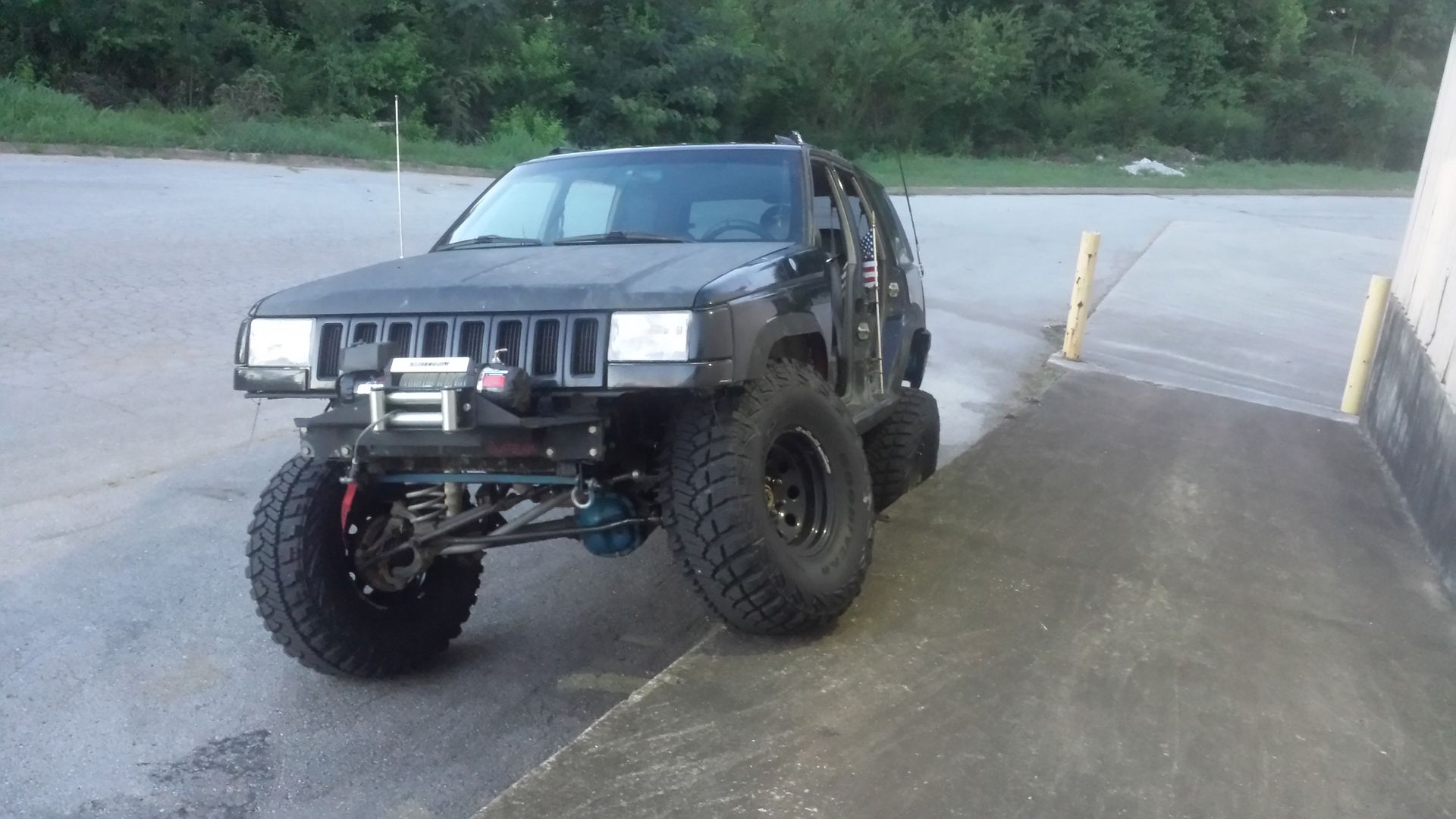

Sooooo much better. After riding on blown shocks for 6 months, this was needed

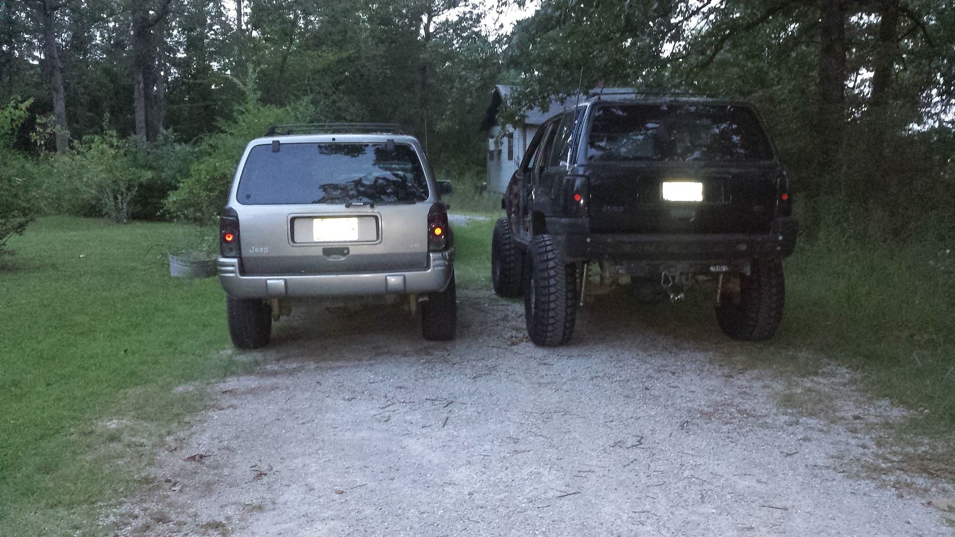

Sometimes I do forget how much taller than stock my zj actually is. This is my buddies ol' zj, mind you it's got a 2 inch bb (stock tires though)
