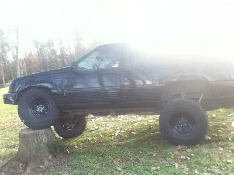

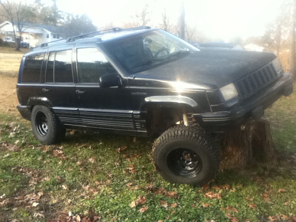

All that aside here's my Jeep when I first got her and then with the current setup
My Jeep:
5.2L V8
NP231
Lockright front
Super 35 w/ Detroit Rear
4.5 front lift, Adjustable CA's
RE front double sheer trackbar
5ish rear, Adjustable CA's
JKS rear trackbar
Trimmed
35" Goodyear Wrangler MT/R w/ Kevlar
Black Soft 8's

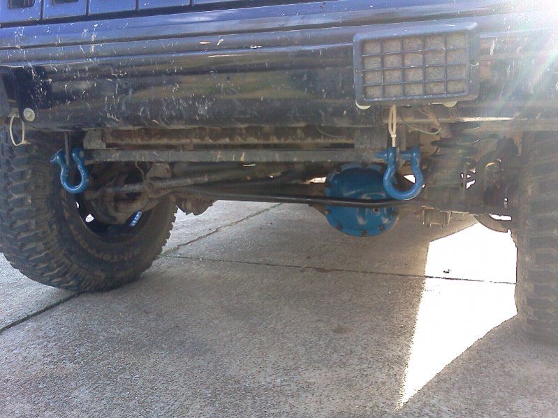

KOR d-ring shackles front

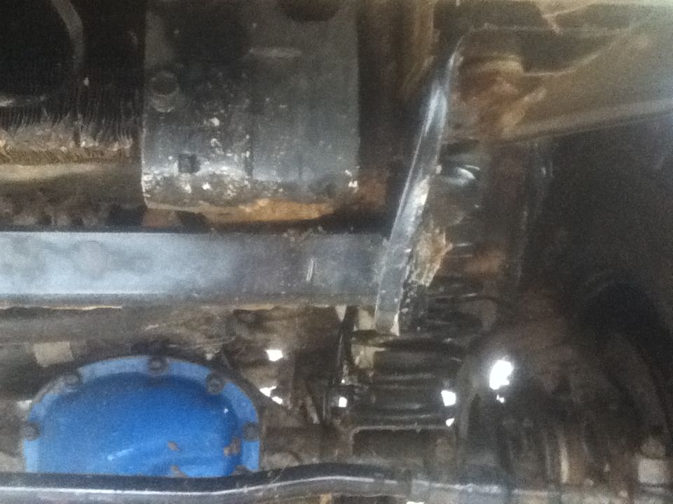

Been wasting money on the stupid dana 35. Oh well, I just need her back on the street.
I'm replacing wheel bearings and pinion bearings. Not a big job, but i've spread the task out waay too long. She's been sitting like this in my garage for a few weeks now.

It's funny, I went in to the rear axle to replace the seal, ended up replacing wheel bearings and pinion bearings. Now that everything's back together, the seal still leaks. :thumbdown: :brickwall: :thumbdown:
I'm thinking about upgrading, I imagine it'd be way easier to replace parts on an axle that's not under the Jeep, plus I can take my time fixing the axle and still drive the Jeep till it's done. Probably will just do a d44 from a newer zj over the summer. LSD anyone? (not that lsd) :highfive:
