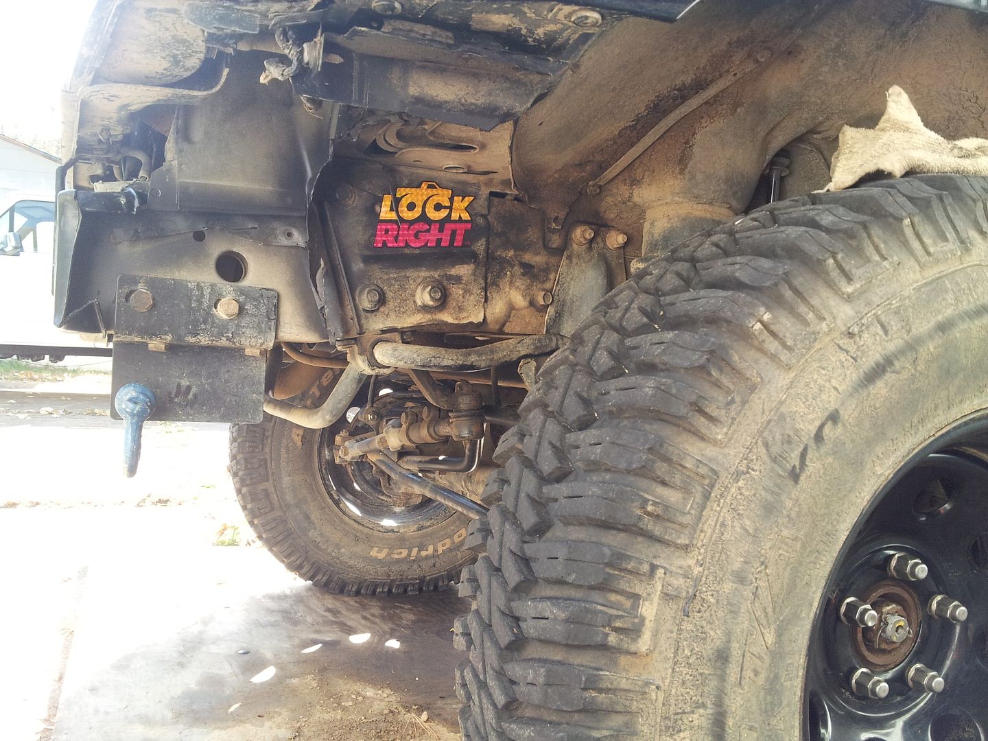

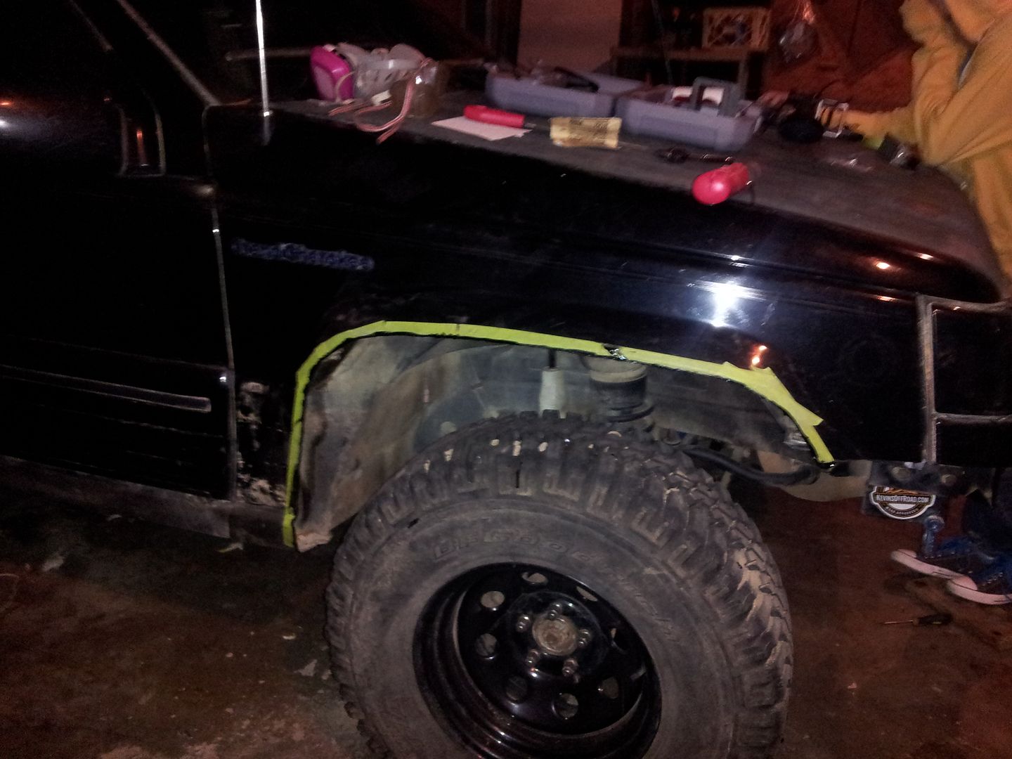

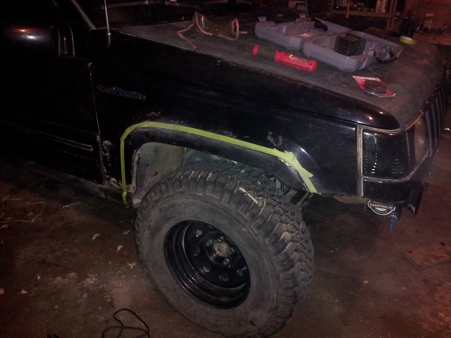

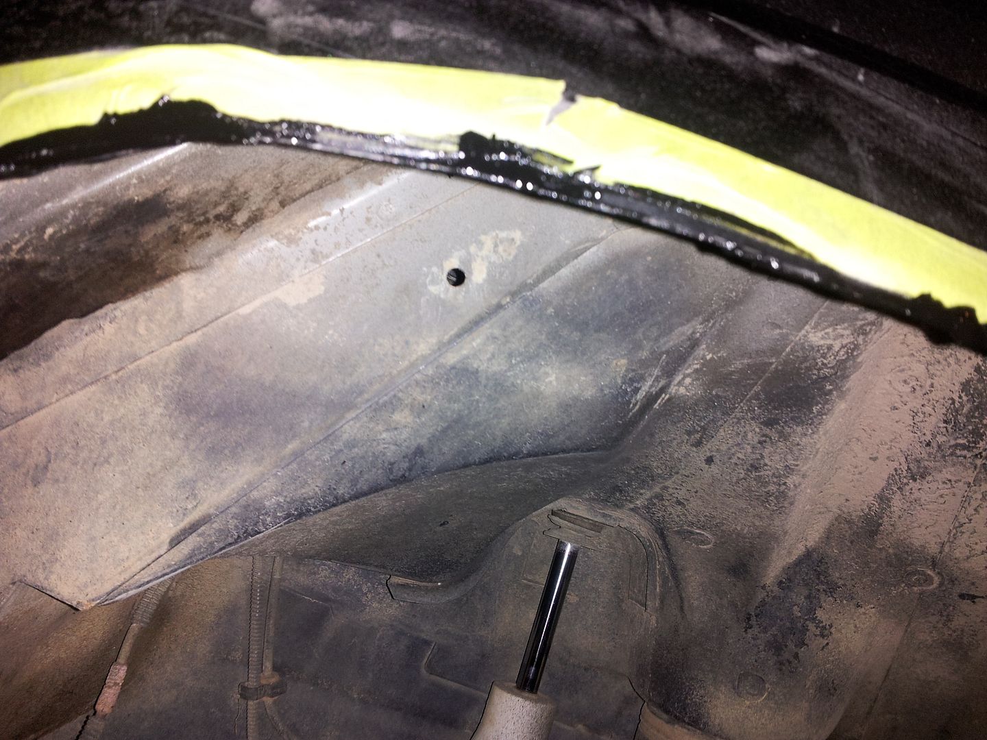

Trimmed Fenders
Borrowed my friends dremmel to trim back my fenders, I still need to clean up the cut some, but who know's if I'll ever do that
Here's some pics, it turned out pretty well all things considered.
I sanded down the edges and tossed some bedliner stuff on to hopefully keep it from rusting.
I'm probably going on a weekend camping/wheeling trip here in a week or two, I can't wait
Also through on my lock right sticker!
