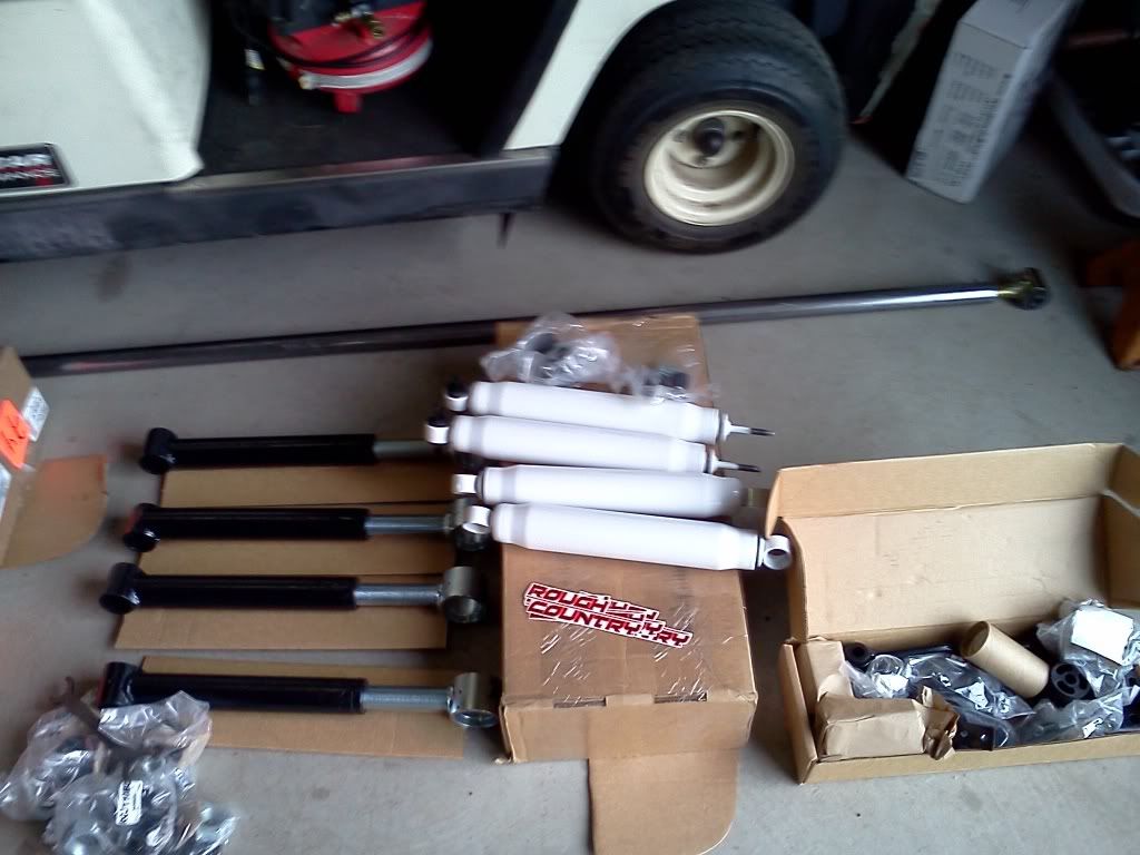

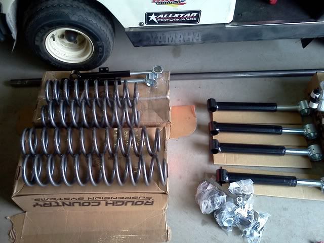

Well got the kit at 4:45pm this afternoon. I was hoping for an AM delivery but what can you do. I worked on it until 12am. We got about six hours of work in so far. The front is done, thankfully no broke bolts up front. Afraid I wont be able to say the same for the rear. Well I will find out in the AM. Probably another 4 hours or so. Hopefully have pics up tomorrow.

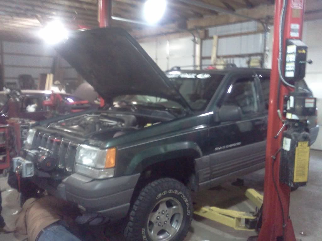

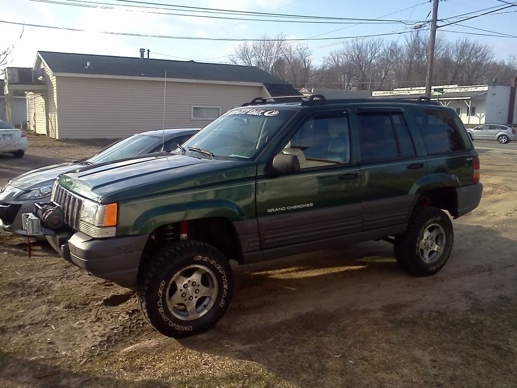

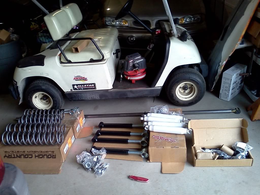

Started working on it today at 9:30 am. Pulled it of the hoist at 3pm. Total of 11.5 hours and only one broke bolt, rear track bar lower bolt.... But it pretty smooth other than that. Alignment Monday morning, wish I could go wheeling tomorrow!
Here is a few pics First all the goodies, It was Christmas in March for me lol. Then some of the new look.

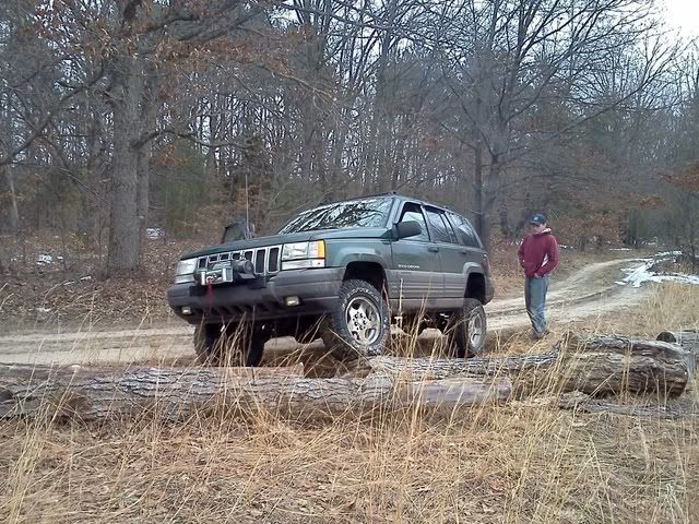

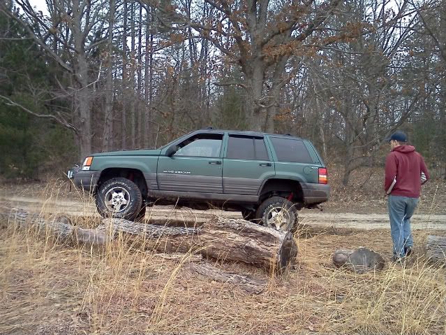

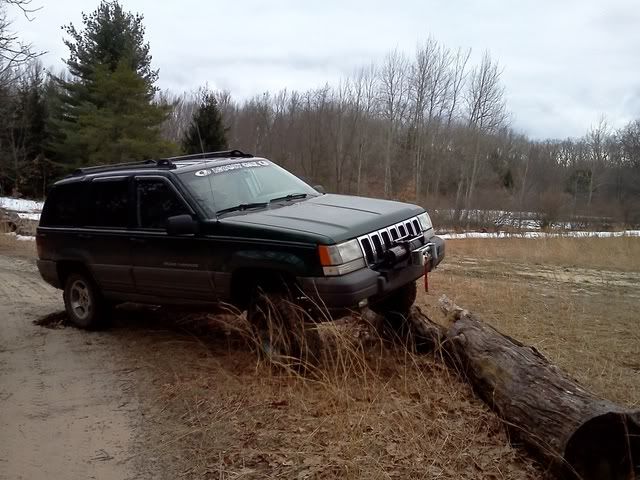

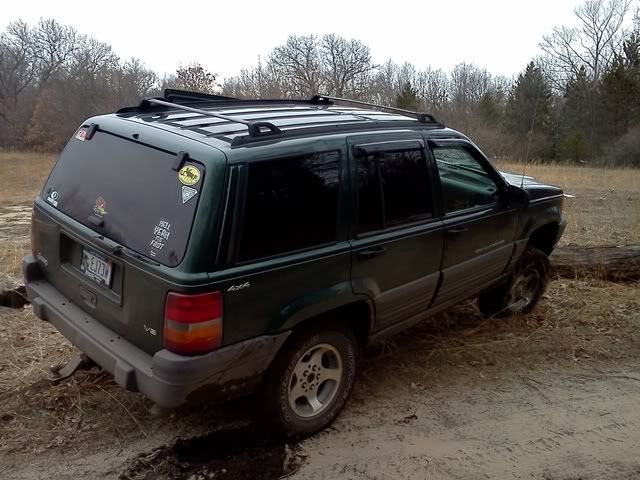

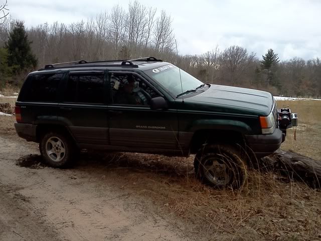

Got to take it out for a test today!

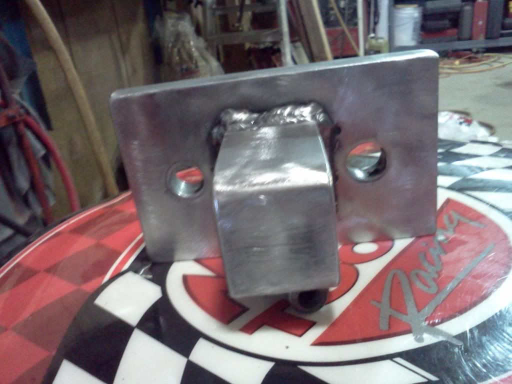

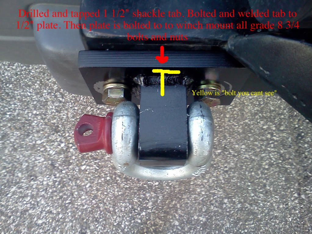

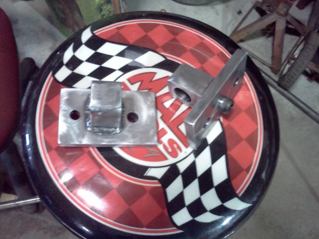

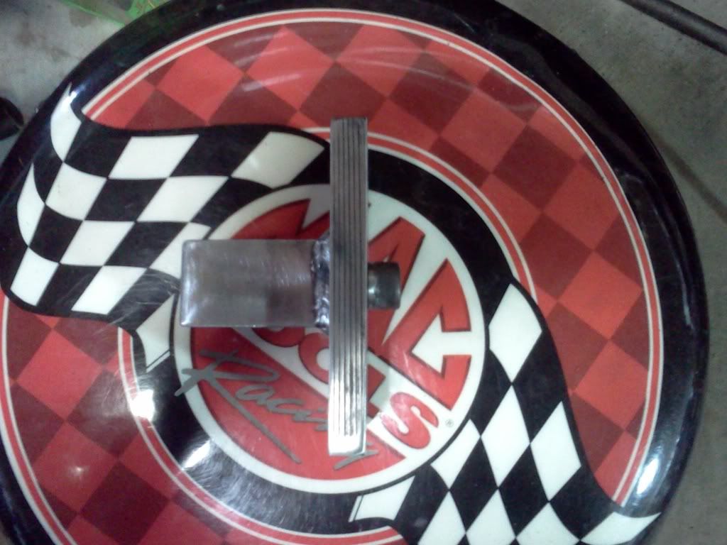

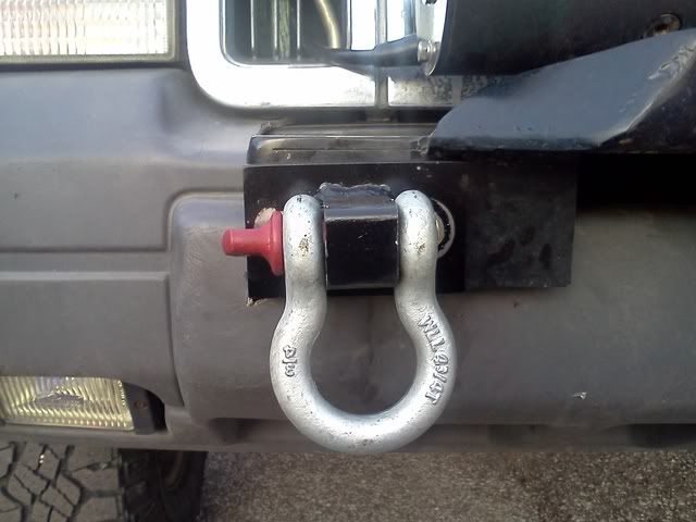

Got the shackle tow points made and mounted today!

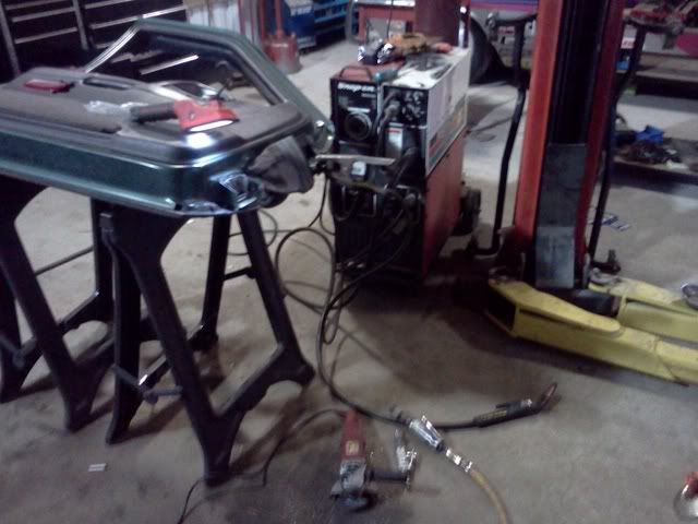

Spent about 3 hours welding broke driver door hing and putting new pin and bushings, also had to weld door up around the latch. It had been messed up for so long it was tearing the metal. No more broke door now! Sorry no pics of it finished, I will try to get some tomorrow. It was getting late on me.

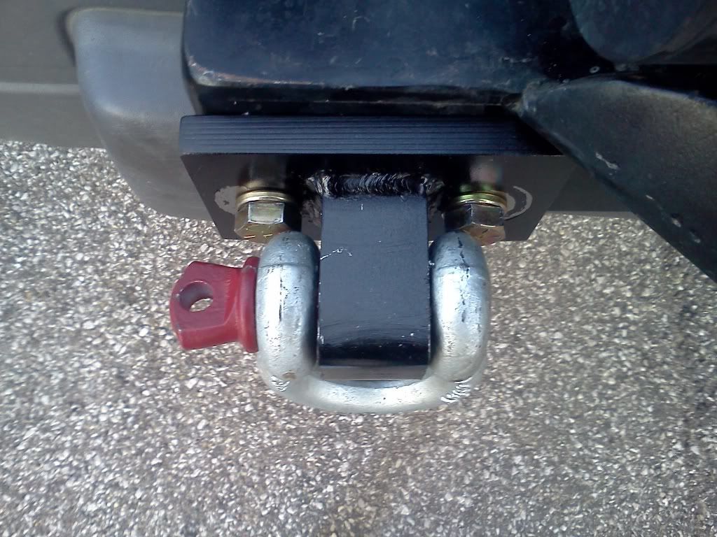

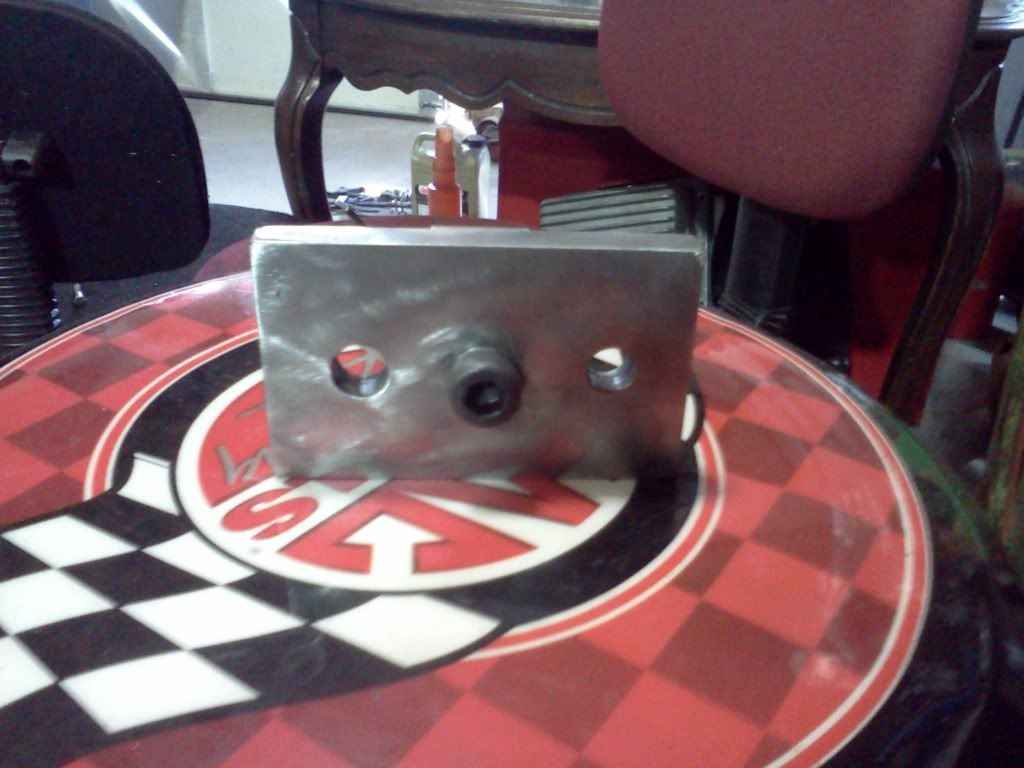

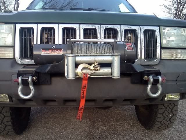

Finished shackle mounts for winch plate today.
