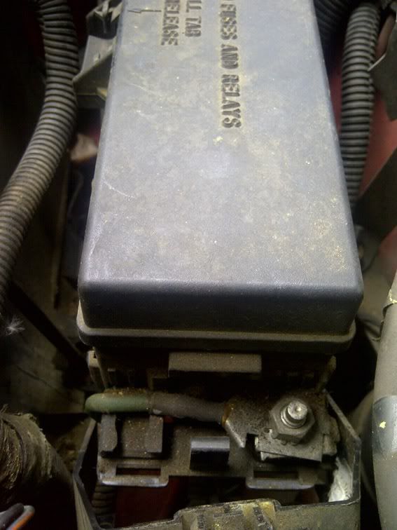

So the previous owner has taken out whatever was under that cover and bolted the two plates together. The 'fuse' seems to go between the alternator and battery.
What's the fuse for?
Should I be thinking about putting something in there that is a bit more 'fuse like'?
Cheers for the thoghts.

According to that paper you posted the mega was replaced with a fusible link. I don't know if you have one by looking at your pics but it doesn't look like it. They are there to blow when there is tremendous draw on the alternator, usually rated slightly above the alternators max output. This prevents duty cycles over 100% which as you can imagine leads to a dead alternator fast.
The fusible link melts when the rated load is exceeded and in this case was more problem free when compared to the mega. I'm assuming the reason Chrysler did away with the mega fuse was do to fatigue problems. I know overtime they may sometimes crack (not due to overload) and cause strange hard to diagnose intermittent problems.
I'd install a mega fuse just to be on the safe side. A common one in many places is the 32v 175a. Or perhaps you can get a cheap fusible link from the dealer.
