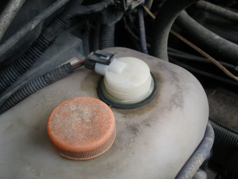

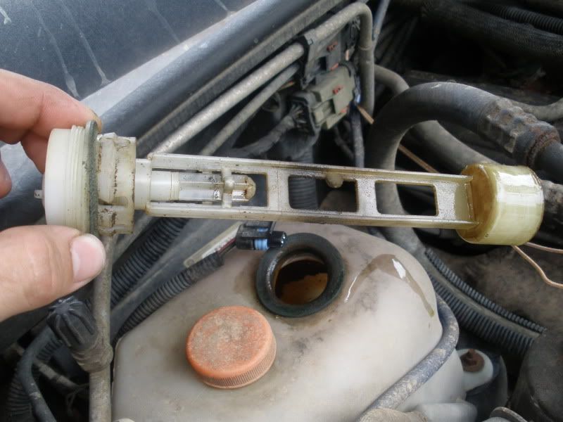

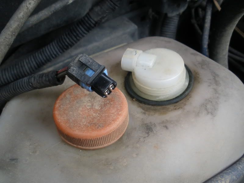

Here ya go -
1: Locate Coolant Overflow Tank. The Little plastic piece that a wire plugs into is your Sensor.
2: Unplug the wire from the sensor
3: Pull out Sensor
4: Repeat steps backwards to replace with new sensor.
