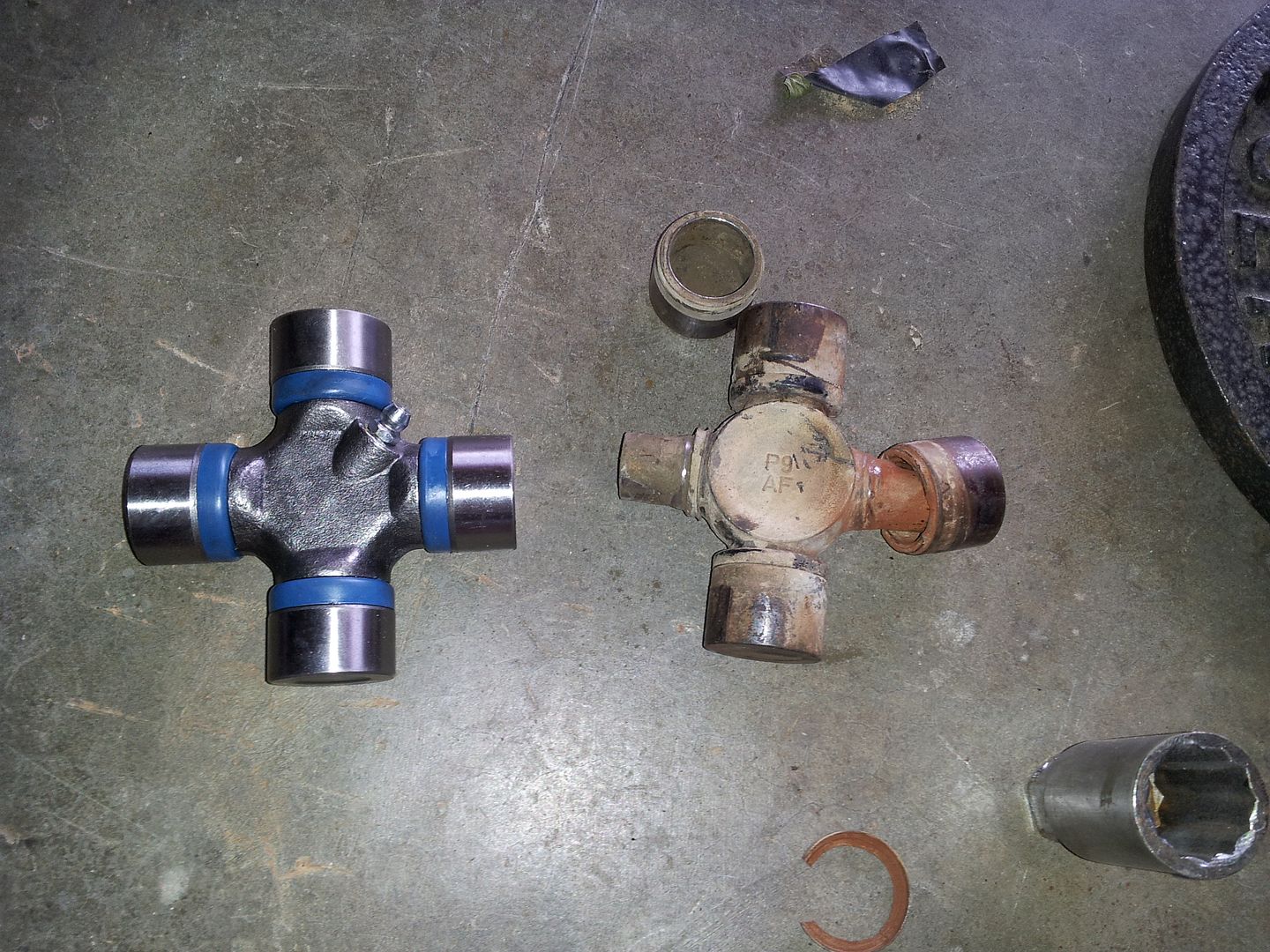

I pulled both drive shafts and inspected them. Replaced the front drive shaft u-joint:
I also replaced the rear seal on the transfer case while I was at it. Just finished this today, put it all back together and test drove it, still same popping sound.
