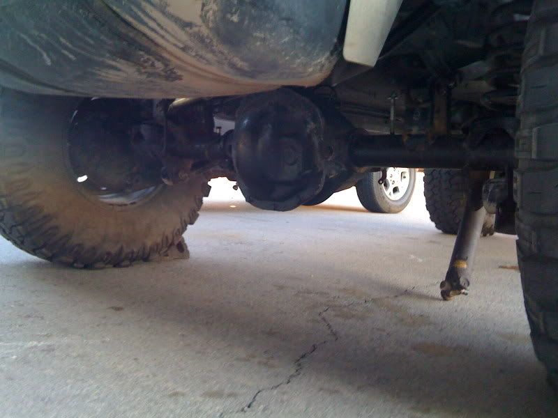

Go out to your Jeep and look, if you have an oval shaped diff cover and it has a rubber fill plug, youve got the 35, like this
Dont have a picture of the 44A but obviously if you dont have the 35, its that.

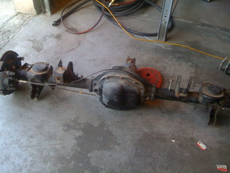

look at your rear differential. if it is more of an oval shape, it is a dana35..
and if it looks more like this, then its a dana 44a
