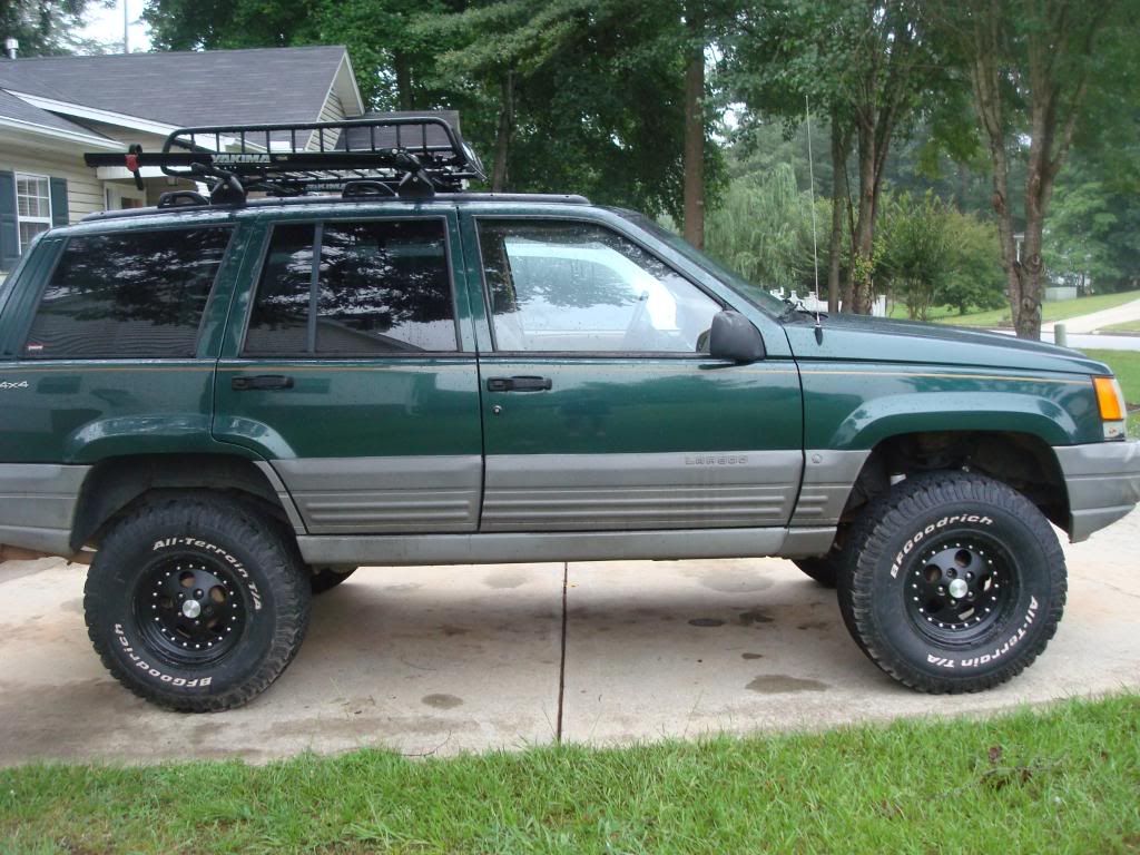

Jeeeeepster
Location: jamestown
Posts: 156
my jeep with 4.5 inch lift and 33 by 12.5 tires

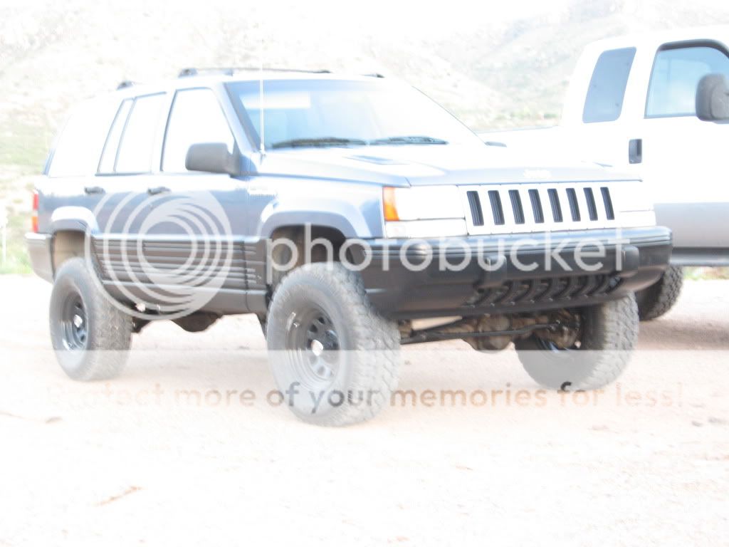

im running 31x10.5's for now, but when ever i finish saving up ill be running 33x12.5's but yeah i love the kit so far... i put 1" spacers on top of it too for just a lil extra height though
99 WJ,4.0, stock
93 ZJ,4.0, 5.5", 33x12.5 mts

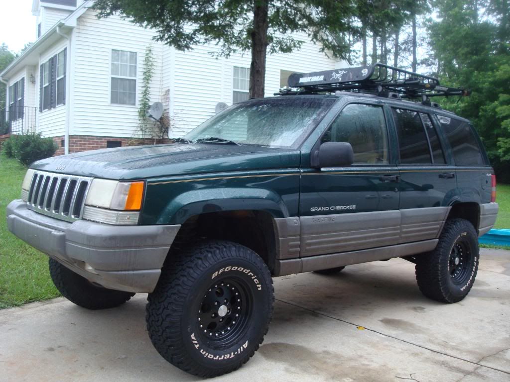

ben98zj
Location: Greenville
Posts: 30
4in lift 32/ 11.5/ 15 all terrains

post #27 of 30 Old 08-05-2009, 01:52 PM
Travis873o
Location: Detroit
Posts: 941
they dont rub do they? and 4" of backspacing i assume?
Travis873o is offline
post #28 of 30 Old 08-05-2009, 02:04 PM
ben98zj
Posts: 30
They rub a little on sharp turns, not really much. Just have to know my limits. The rims I got with the tires off of a 94 yj really could use some spacers. it's on the to do list.
