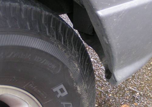

Yea if you go with 265/75/16, all we had to trim was a little bit of the wheel liner and bottom part of the bumper where the passenger side tire hits it. they will also rub slightly on the inner fender and control arm on the passenger side at full lock, as you can see by the silver parts in the picture.
and here is where you will need to trim, i just used a razor blade, worked great.

yup, you will definately rub on the front control arms
but this could be fixed with 1/2" wheel spacers (don't worry, as the tires won't stick out the fenderwells even with the spacers), but you will have to knock out your current lug bolts and press in longer ones. Or just buy some aftermarket wheels with less than a 6" backspacing.
edit - oh yeah...here is a closeup of the flappy thing you gotta cut off on the front fender-well liner....just straight across from the notch -
