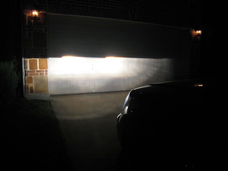

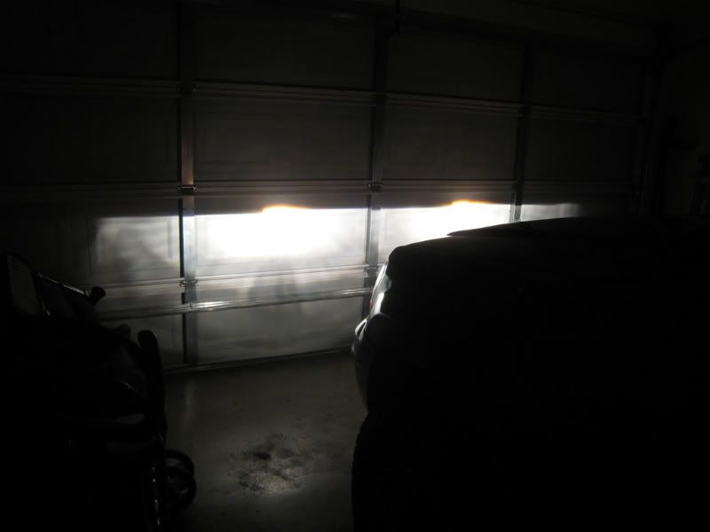

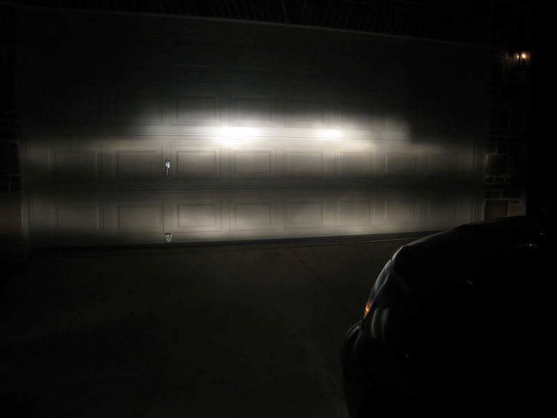

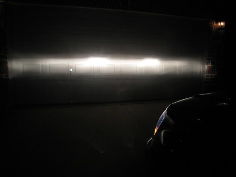

Completed projector headlamps/HIR bulbs/9005-fogs and iPod/iPhone adapter last weekend and wanted to share some pics.
I had posted pics of the headlamps upgrade on the wdydtygc-today thread earlier this week but finally took some nightshots.
Some before and after for comparison.
before with stock housings, low beams > low+high beams+fogs
after with projector housings, HIR low beams > HIRs + 9005s in fogs.

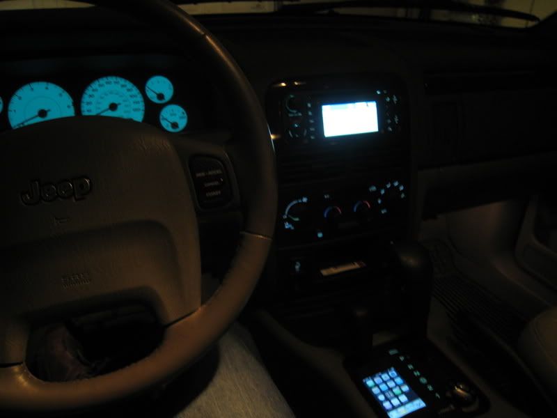

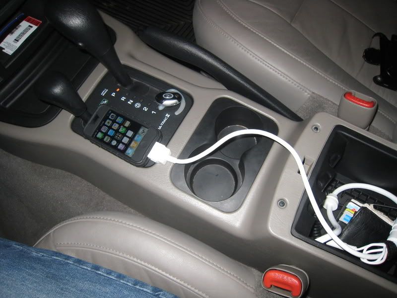

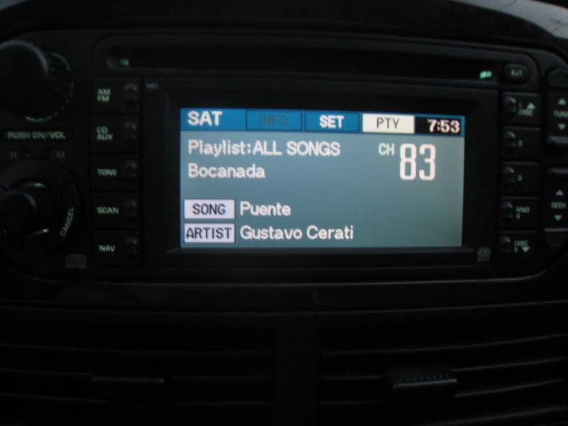

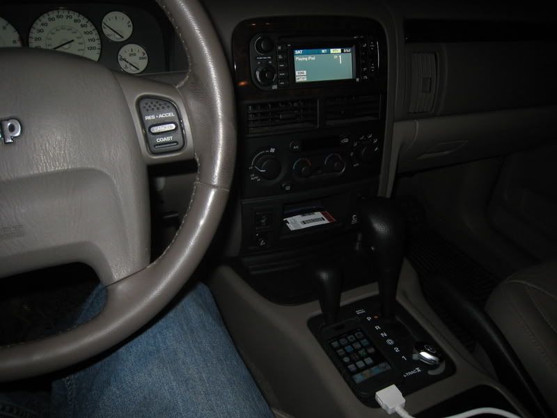

Then the iphone adapter.... man I love this thing; get to browse using the steering wheel controls, keep the CD changer and the music dims/pauses with incoming calls then picks up where it left. I followed Cebby's excellent write up here: http://www.jeepslimited.com/index.php?option=com_content&task=view&id=18&Itemi d=94
That's all for now, let me know what you'all think.... oh, and yes, I do wheel my WJ, I just use tape

Wow! Big difference in brightness....
Very nice
The difference while driving is notorious, the amount of light from the fogs with 9005s is insane and the HIRs work really good on the projectors; it's not HID, but good enough for me, and the extra money will go for LAs instead.

WOW, they're so bright that in picture #3 you can see the INSIDE of the garage doors
Ooops, sorry, I forgot I turned on the X-ray beams on that pic
I just did not have a good pic of the low beams outside so had to use that one.

The cutoff on those projectors is awesome. If i wasnt going total hid conversion, i'd want those.
Did they come with the amber LEDs or white that you modded out.
Yup, I love the cutoff, nice color on it too (hard to see on the pics). It came with ricey white LEDs for the side markers that I converted to amber LEDs.

thats a really nice looking setup. i like how white those HIR's are. that cutoff is very nice too.
Of course, HIRs only, no Silverstars crap on my rig j/k.
Dont start that again. And, As i had a few industry papers open on the hirs, the toshiba ones actually are brighter then DOT's limit (at least for low beam) by about 350 lumens... so in retrospect, i'm going to stop recommending them for low beam applications.
Of course, with the cutoff on those headlights you have, it shouldnt affect oncoming traffic at all.
How'd you do the LED conversions? Did you just find some ambers at the same rated voltage, or did you have to do some re-wiring?

As far as the side markes, was easy, just pulled the stocker white LEDs (194s style), put new amber LEDs, done.
