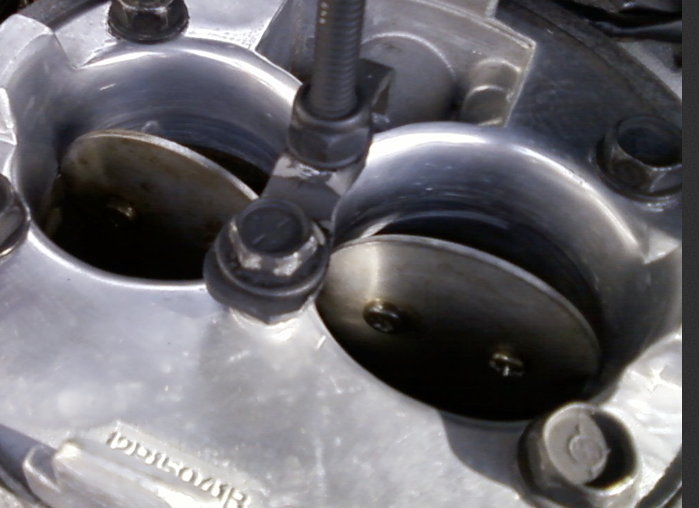

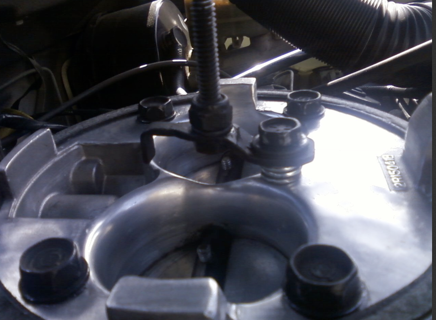

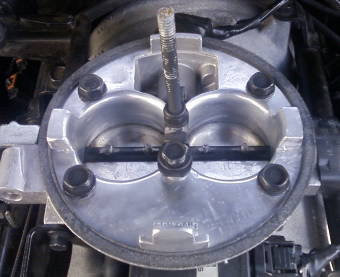

You can take that throttle body and shave off the air dams with a dremmel then use a brake honer to bore it out. After that sand it with several grades of sand paper until it's nice and smooth then use mothers aluminum polish. Just don't bore it where the plates close or you will be fabbing new plates. I know this from experience.
Here is a pic of the first one I did on my old ZJ and my current one. You can see the gold color on the plates on the old one. I had to make new plates from a brass door kick. I spent a lot more time on the first one. Something to do if you are bored and it's free.

I used a metal-use hole saw to more mine out when I did it. It scratched up the sides so bad I spent four hours smoothing it all out by hand with a file. It was a PITA, but it did come out real nice. Definitely a good way to kill some time and get something useful--you could spend hours working on it. This is the only pic I have left of it:
