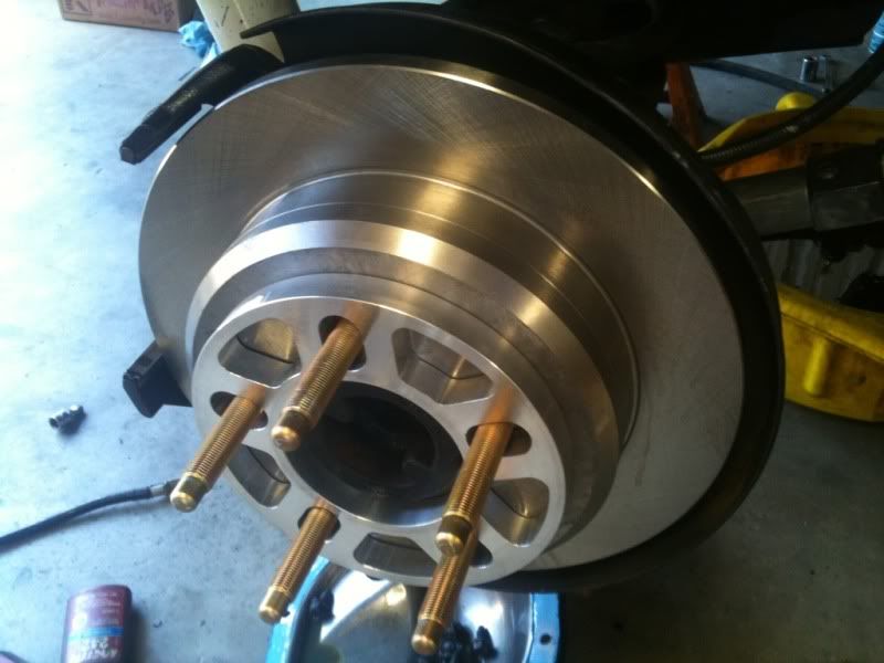

The guy couldn't get 1 of the wheel lugs off. It broke 2 of his wrenches. So he gave be both wheels on aluminum rims, was a nice bonus. Overall the axles in real nice condition just a small amount of surface rust.
Do we know what this electric plug is (located top center & a little to the right) in the first pic?
Trick440 is offline
That sensor was used for speed input for ABS and/or VSS.
