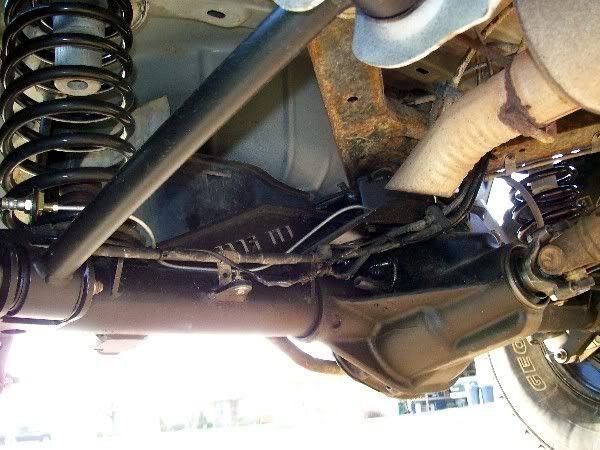

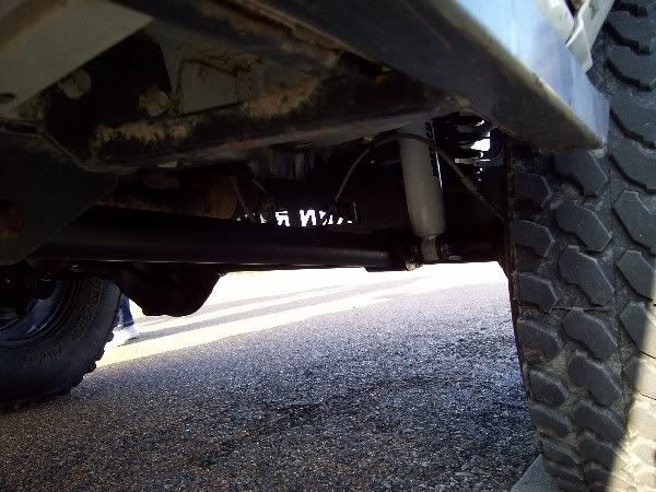

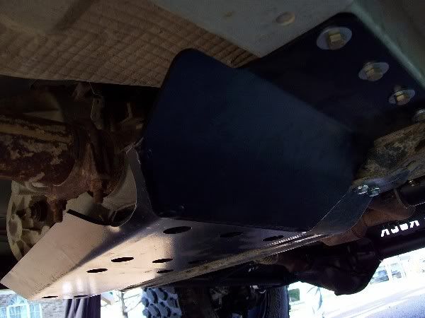

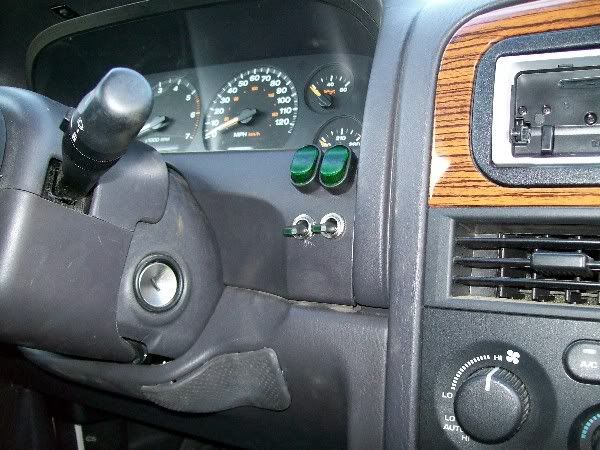

Posts: 9,443
10achik I think was one if not the first to have it done by IRO.
Illuminated Switches:
Shot to show ground clearance:
Still running SA's in the rear, but check out the beefiness of that axle:
Awesome skidplate, worth every penny:
