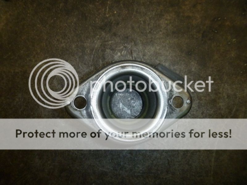

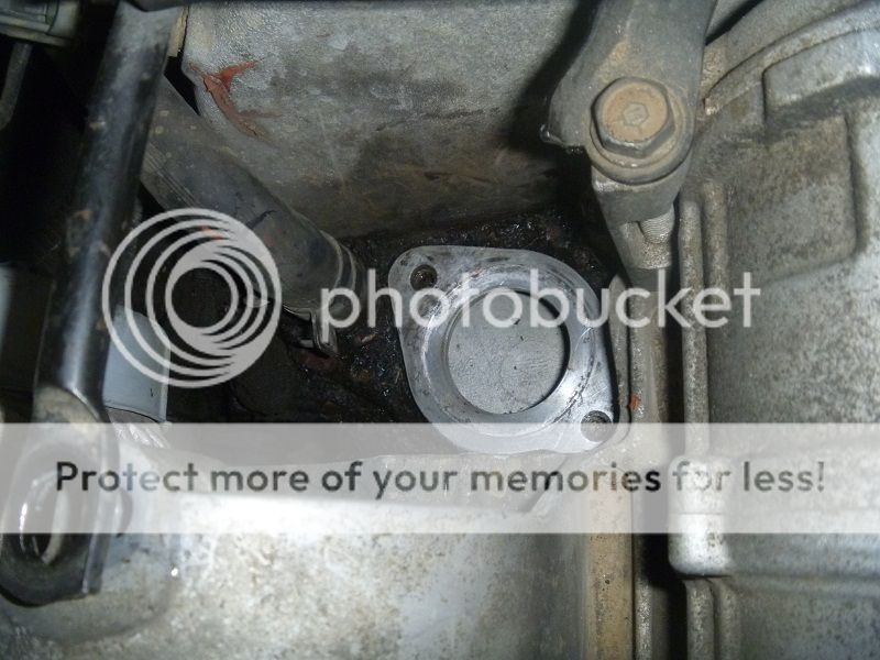

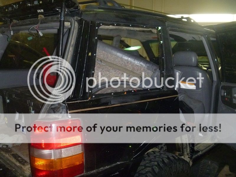

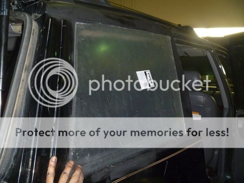

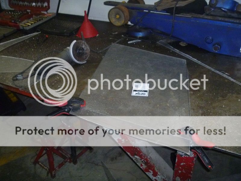

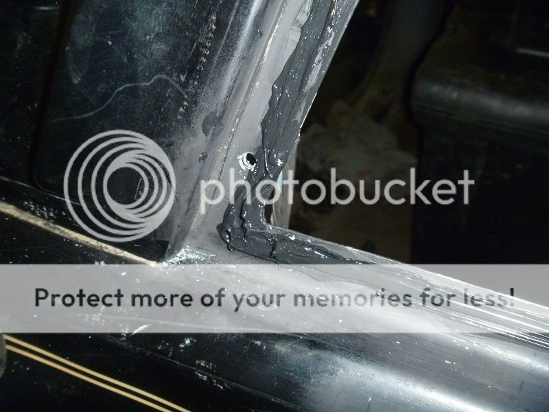

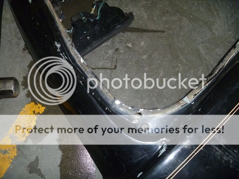

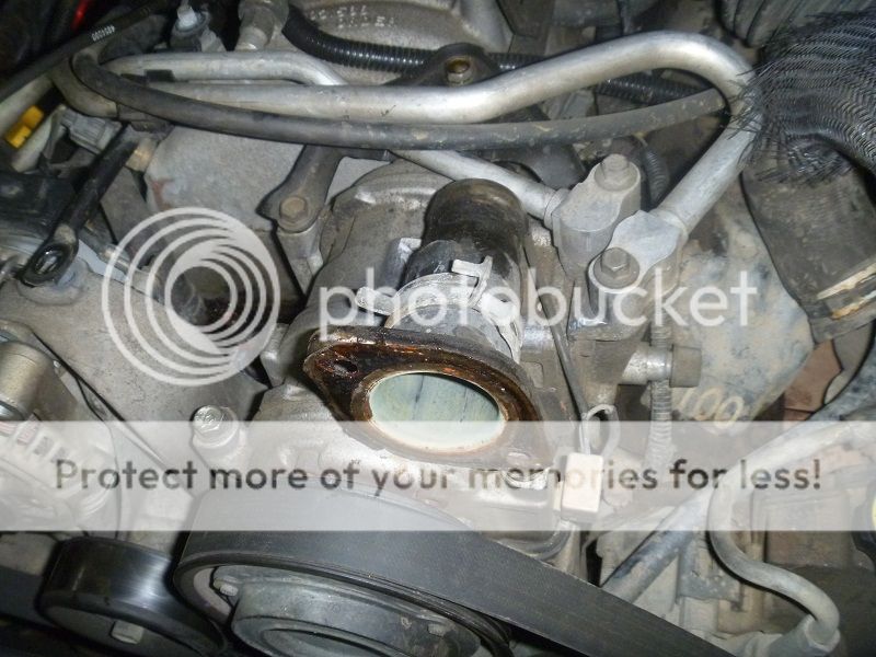

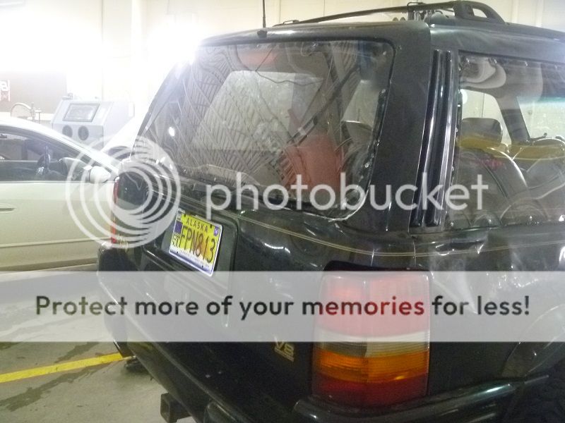

SUN 04NOV2012 - Coolant Flush / Thermostat Replacement / Window Repair
flushed the cooling system and changed the thermostat. ohhhh myyyy goodddddd my heat is insane now. should've done this a long time ago instead of freezing my butt off for half an hour every day. also installed a plexiglass window on the lift gate. i was really short on time, so didn't get to take many pictures. i'll take more pics when i finish it up tomorrow.
undoing the belt tensioner
nasty
surfaces cleaned for gasket
torquing it
rough fitting the plexiglass
spent a lot of time straightening the lips out and cleaning them.
fine cut with a grinder. got pretty good at it really fast. i'm pretty confidant in shaping plexiglass with a grinder.
anyway, i installed it already, but didn't have a chance to take pictures. it doesn't look too bad but ugh, i already cracked it. put in one of the screws in too tight and it cracked. maybe i should've been patient and just go with lexan. we'll see how this looks in 3 months or so.

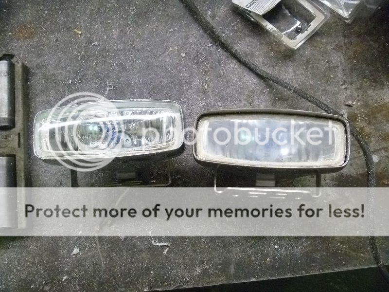

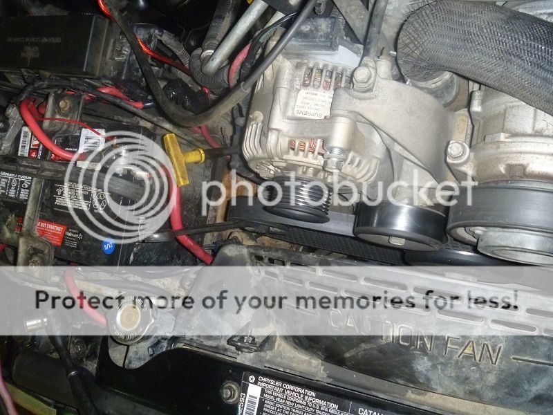

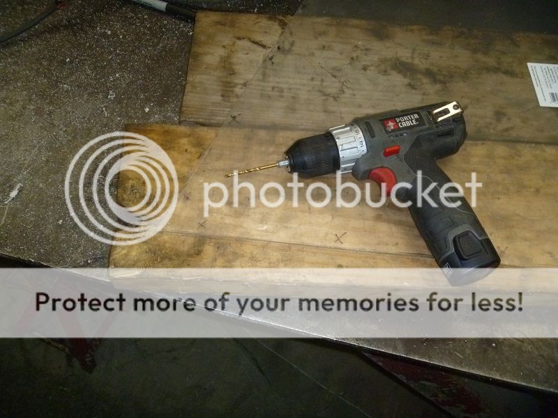

MON 05NOV2012 - Window Repair Continued / HID Lights
continued repairing the windows with plexiglass. got the rear passenger window made. i definitely do not recommend plexiglass to use as windows. i should've definitely gone with lexan. plexiglass is cracking like crazy. the liftgate window is already cracked in half just from metal contracting from being in the cold.
then i had some time to kill so decided to tidy up the battery posts/wires and install the hid lights i've had for a loooooong time.
dropped one of the lights a day after i bought it. replaced it with plexiglass.
