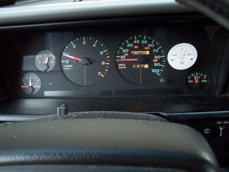

The left side of the gage has different increments then the right side (past the 210 mark)
This is where it should be in a perfect world. Mine is just off the 182.5 mark, so I guess I run about 10 degrees colder then one would expect.

I used that picture to determine where I was to begin with. Great diagram Steve.
