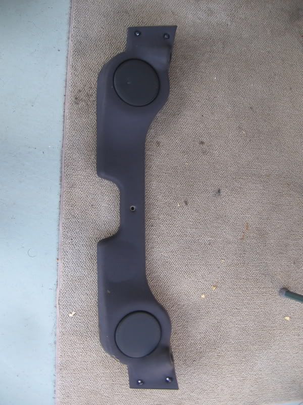

total of 4 speakers in the sound bar.
David.
