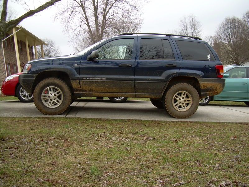

265/70/16 works on a 2" BB. I run it. You may need to trim just a touch of the underside of the bumper, but you can't notice it.
Your factory backspacing should be somewhere around 6" (check wjjeeps.com to verify). I wouldn't kick the wheels more than an inch or so, so stick with ~5" of backspacing or you'll be more likely to hit the bumper.

Originally Posted by BLKSVT View Post
Thats exactly what I want to do, looks good! Do you have wheel spacers on there?
Thanks I do not have wheel spacers. It would improve the stance to do so, though.

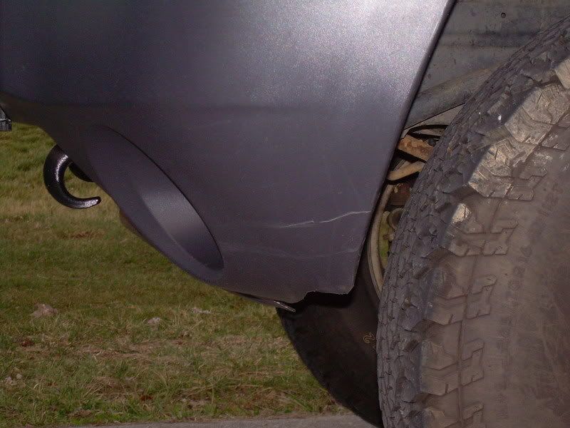

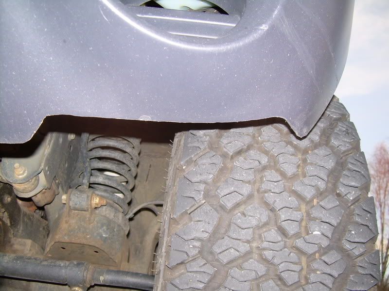

Originally Posted by KateWJ View Post
tennesewj
your jeep looks awesome!!
how much triming is needed to run a setup like that?
Thanks
I trimmed this:
on both sides, and that was over-trimming. It could have been smaller. You have to literally be on the ground looking for it to even notice.
No rub while flexing.
