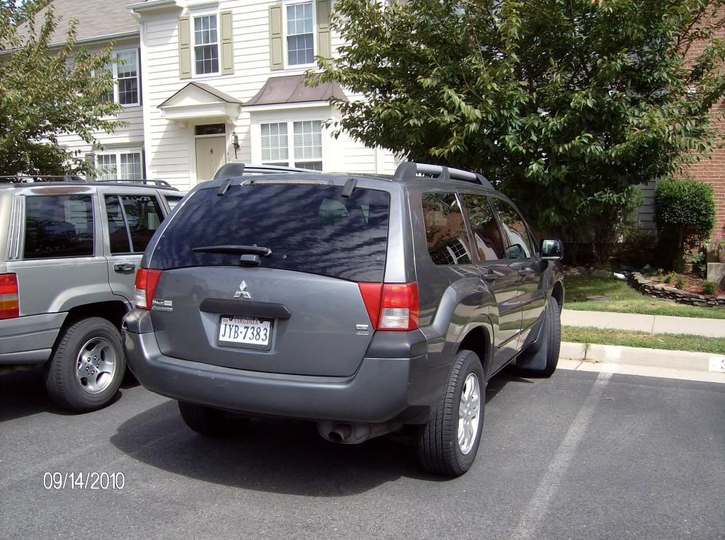

I've sanded down the 4.0's rusty area's... It was showing all over the roof and near the roof rack on the side's of the Jeep.. I just got some high grit sand paper sanded it down to bare metal.. wipe it down with a spong dried it off, and primed it with rustolium primer, and then painted with a paint close to the color of the Jeep... I did the side by the roof rack like 2 1/2 years ago.. paint is still there rust hasnt returned.. I did the entire roof like a month ago... Looks good actually.. I'll get pictures of it tomorrow or something..
But here is the rust before sorry this is the only picture i have but you can see the huge rust spot on the Jeep

Thats an odd place to rust at

Yea it is, the Jeep the whole body is pealing. everywhere, doors, roof, sides of the Jeep, the hood... It sucks... As i said i painted the entire roof 2 months ago.. The whole roof was riddled with spots of rust.. The wierd thing is the Hatch isnt peeling lol and the hood is what started first but the hood still has paint and primer on it no clear coat but paint when it rains or has morning dew on it i can rub my fingers on the hood and get primer and paint on them lol.. Im not sure why its peeling this badly... My mom spent like $3500 on a new paint Job about 11 years ago because her Ex-bf scratched the hell out of it with keys and stuff when it was only 4 years old.. But whoever did the paint job did a real ****ty job because as i said the ENTIRE body is peeling...
I might had to eventually remove all the panels, the rocker panels the roof rack and trim and paint the entire car and sand down the peeling parts.. I do not want the body to rust through. Thankfully since the roof is painted now there is no more rust anywhere.. Altho I didnt remove the roof rack in fear it might cause leaks inside the Jeep so i might do that next year to see if it needs painted under it.
