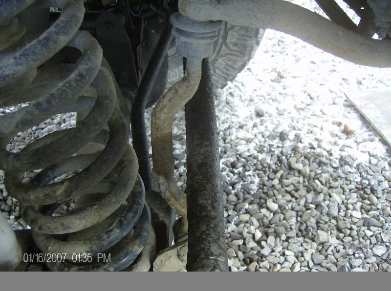

So after countless hours of thinking, and staring at my sway bar i have figured a way to have quick discos. I know that you really only need to disconnect one side to get a full flex. The problem i have is, i have a high steer knuckle so i cant just get stock or aftermarket discos.
theres the passenger side sway bar link and thats the problem i have.

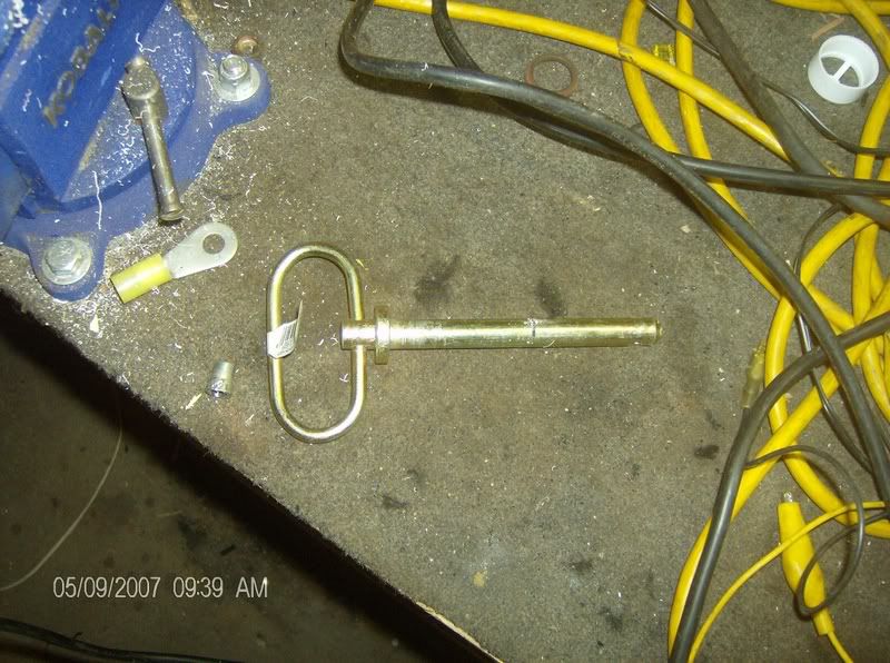

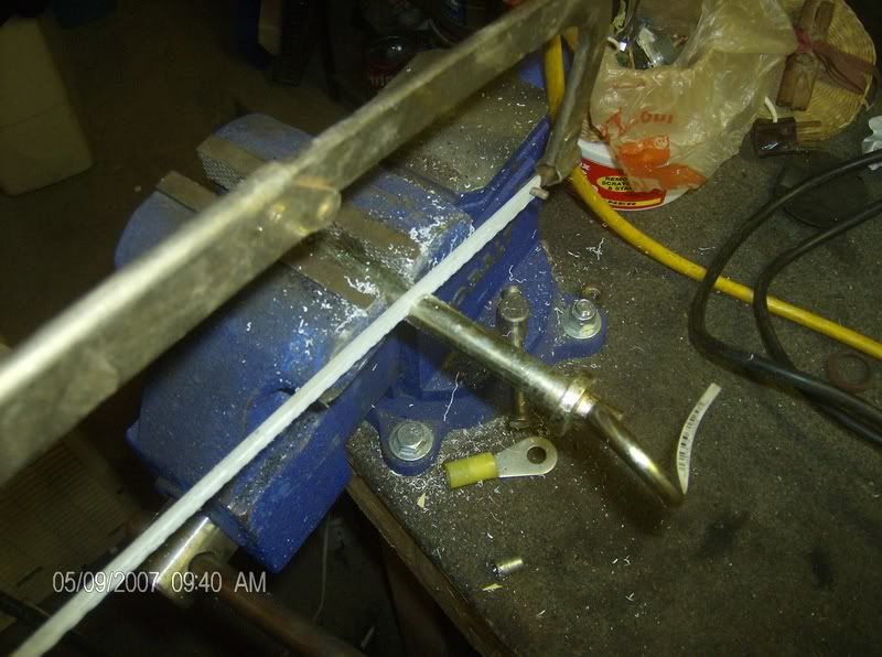

so i decided to go to lowes and see what they had. and i found this

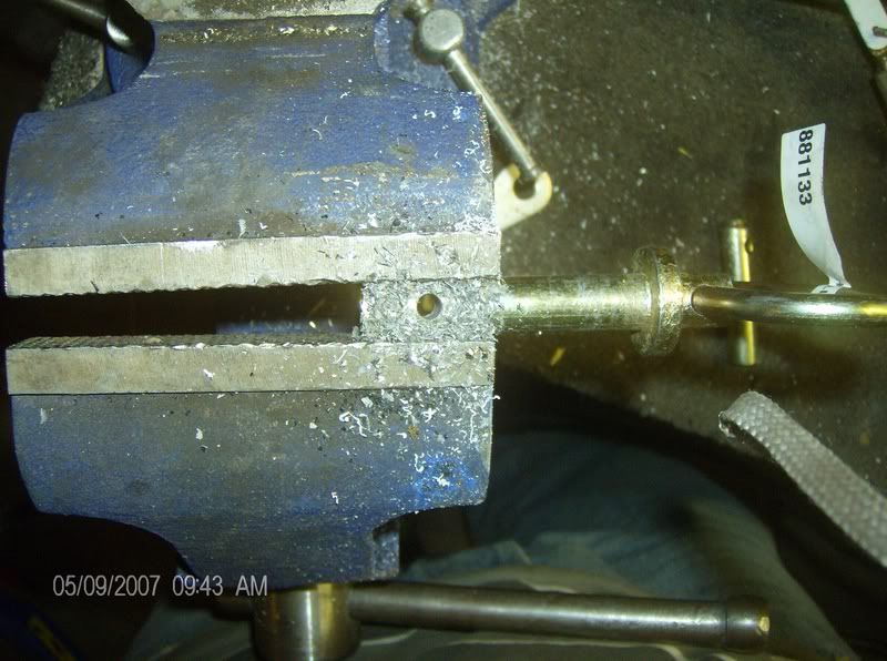

and it was to long so i had to cut it down.
drilled a hole.

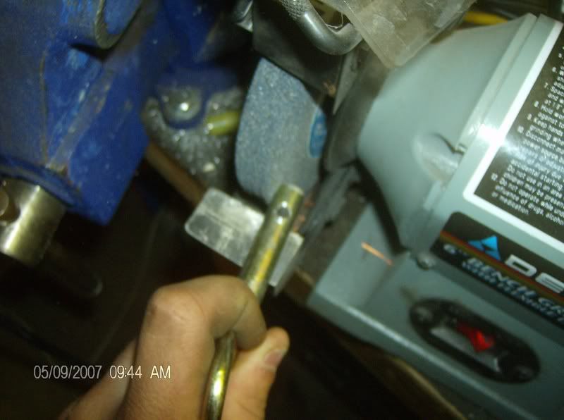

I went out to test it but it was a just a hair to big so i had to grind it down just a tiny bit.
sanded it down to make it nice and smooth

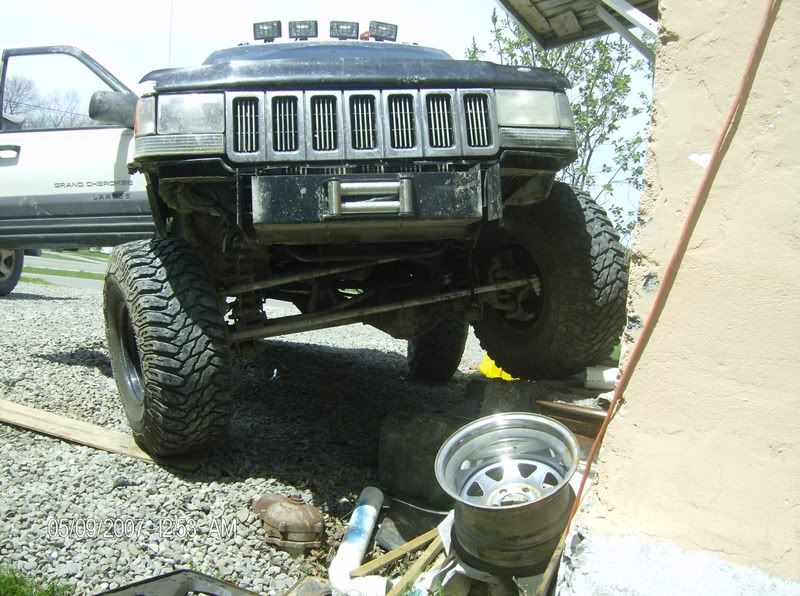

and i had to test it out by using the stairs of m[]y shed

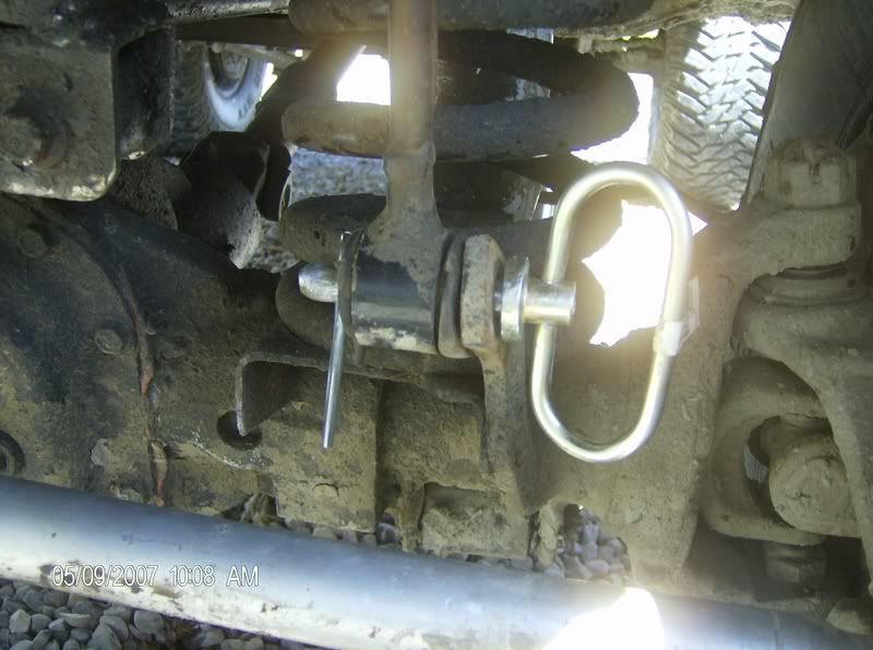

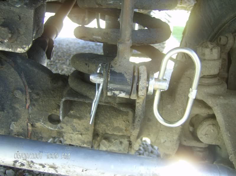

And there you have it... i still gota test it out to make sure the other side doesnt hit when i flex it up.

So you're leaving the top part connected of the discos ??? They're gonna flail around hit stuff.

That's gonna clunk something awful.

i drove it down the road and i was actually surprised that they didnt. and thats the only way that i can think of doing it for and the top part wont come out if i could get it out ill put a wing nut on it so i can take the whole thing off

sure do...your sway bar will move up and down...i honestly didnt know that untill one of my friends told me liek a month ago...thats when i decided to do this mod
edit* look at the last picture and you can see the passenger side still connected

Disco'ing one side will work in theory. But when my ZJ was on the lift to install my IRO kit, I noticed that once the sway bar was disconnected, the axle dropped down another couple inches. This leads me to think that the side you don't disconect won't be able to droop quite as much as if you disco'ed both.

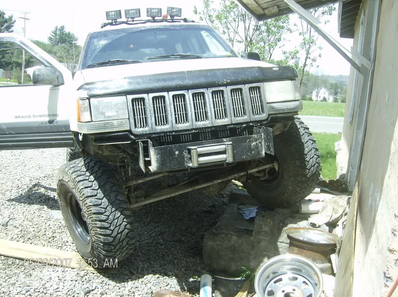

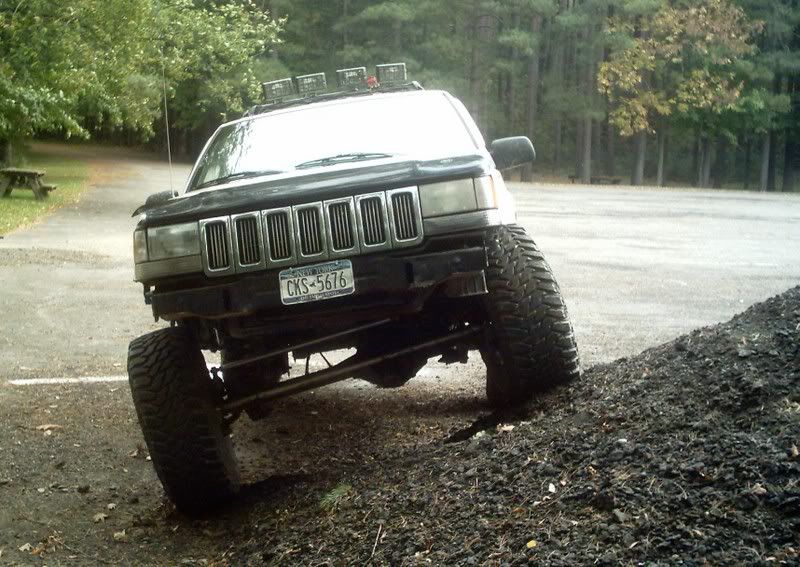

this is at my maximum flex, i mean i had the rear passenger side wheel well literally resting against the tire while the drivers side rear was barely touching. the front i had the driver side tire hitting the back of the fender.(ive trimmed that since) and this is with NO swaybar. ill try to get another picture at the same place probably in the same tread pattern i was in before, but i cant do it for a while cause the place i did it has that section closed off for now. I will get a picture of the articulation with just one undone problably this weekend soe time and you guys can be the judge, im actually curious too.

your bumper looks different in every pic?
sandman is offline
post #13 of 13 Old 05-10-2007, 11:44 AM Thread Starter
legend6009
legend6009's Avatar
Join Date: Mar 2006
Location: binghamton, NY
Posts: 1,041
that last picture was takin last september whewn i didnt have the winch mounted
