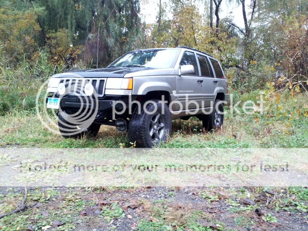

i am running that same lift with 285/75 16's (33s), the back wheels rub the rocker cover a little bit, the front digs the front bumper and control arms when turning, i removed my front bumper cover, trimmed the rocker cover a little bit and will be getting wheel spacers for the control arms... by the way the control arms only rub at full turn

Your running those tires with stock arms?!

looks like it
