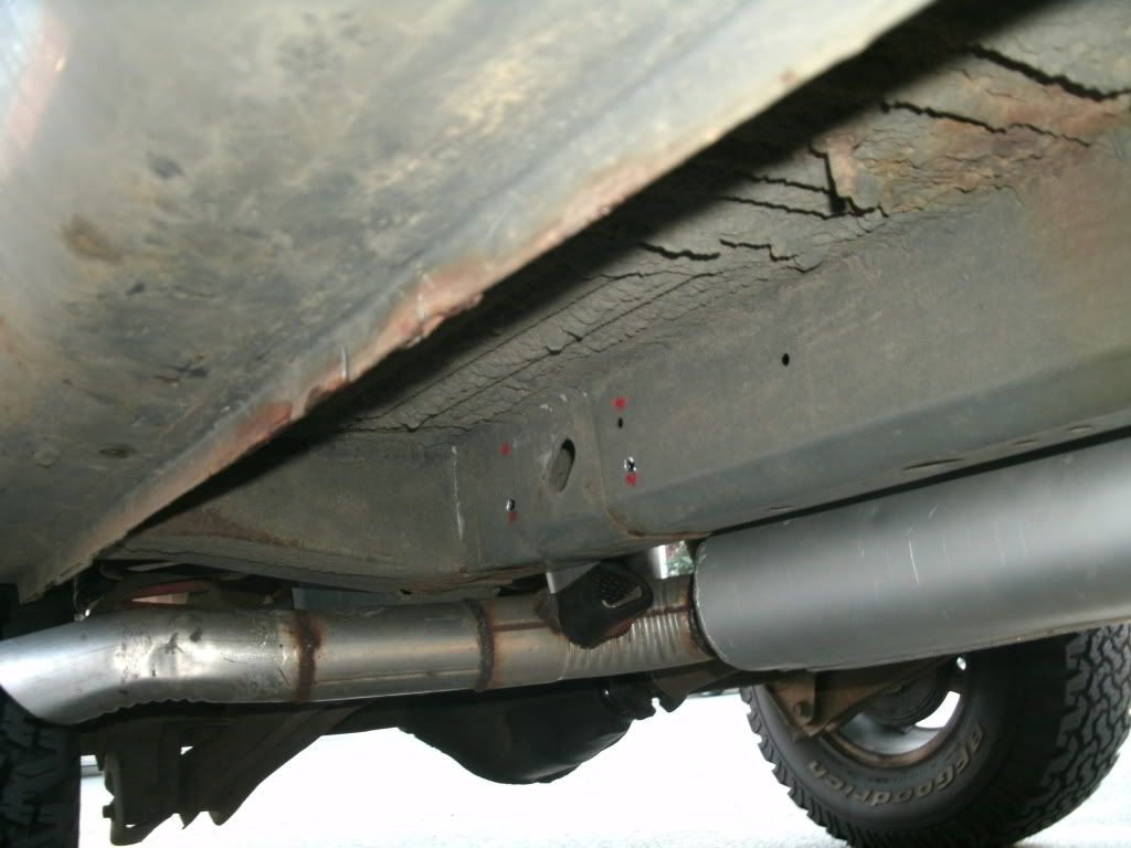

Now if it were me, I would use a y-pipe with the same size inlet as the outlets on the header. IIRC it's about 2" or just under. I would have a 2.5" outlet on the merge pipe, running 2.5" piping w/ 2.5" inlets/outlets for the muffler and cat.
I ran a cheap ebay header and cat w/ a dynomax muffler. I added a big tip(3.5-4") on the end, it gave it a nice low growl.
3" is way to big for a 4.0.

they are slower but I was told 2.5 " is optimal for that motor by a mechanic. He said the 3 inch is overkill. I would want to believe him because my gto exhaust is only 3" and good up to 700 hp before having to go bigger. I made my exhaust short and out the side because the p.o before me put a regular Cherokee tailpipe and I was having clearance issues. I went with a chepo thrush turbo muff and she sounds like a tractor......lol

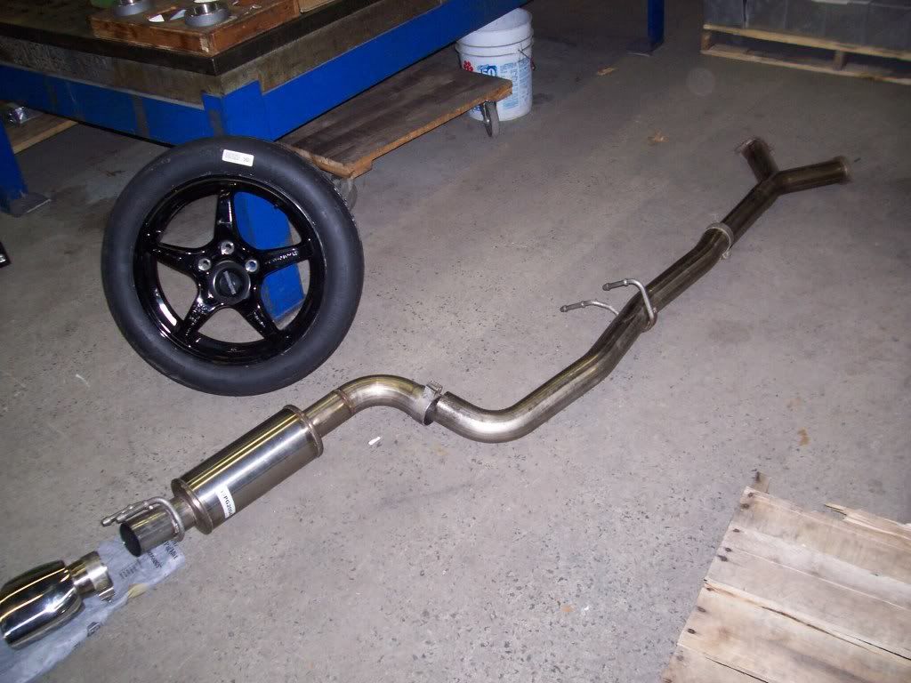

True, but with the (2) 2.5" pipes going into a merge, you're going to have more velocity and better scavenging affect vs. 1 single 2.5" pipe.
Well my theory is coming from my Trans Am. I make with this set up 420 RWHP and 385 RWTQ.
My exhaust is as follows:
QTP 1 3/4" x 3" LTs + Custom Kooks 3" O/R Y Pipe + 3" x 3.5" Flowmaster Merge + 3" x 3" x 25" Powerstick Bullet Muffler + DMH 3" E-CutOut + GMMG Catback

that's pretty much same way my gto exhaust is set up also with slp headers and corsa exhaust
