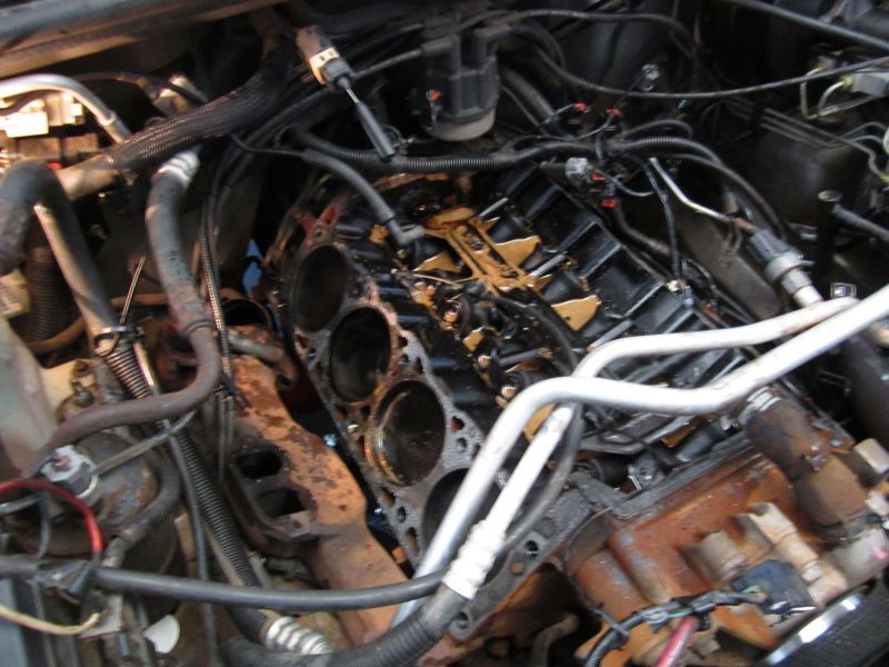

post #6 of 13 Old 12-25-2012, 09:58 PM Thread Starter
ural
Join Date: Dec 2012
Location: montevideo
Posts: 7
Thank you very much for all your help my friends!
Before...
And thanks to you, after!
The gasket was very BAD burn, and the radiator have a leak in a hide part!
Hope that everything goes well!
Thanks again my friends.
Merry Christmas for all of you!
Henry
ural is offline

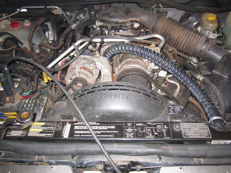

Lookin good, now the fun part is cleaning it up and puttin her back together!
On a side note, make sure you check the plenum pan for a blown gasket, now's the time to tackle that job since you have it torn down that far already and I can all but guarantee you its probably leaking, they all do sooner or later. Things to look for are oil pooling inside the intake manifold as well as pinging, lack of power and bad gas mileage. Save yourself the trouble and time and get a Hughes/APS/Ebay aluminum plenum plate and FelPro gasket set and never worry about it again.
Lastly; make sure to replace the hose I circled in green in the picture, they have a tendency to leak after they're re-used and they are a pain to get to!
Keep us informed on your progress or if you have any questions. Merry Christmas!
