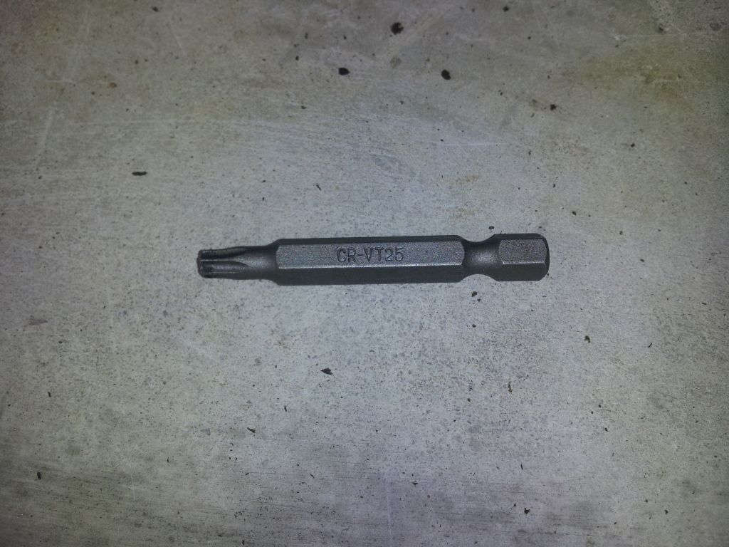

here is a pic of the one that fit for me it shows as cr-vt25

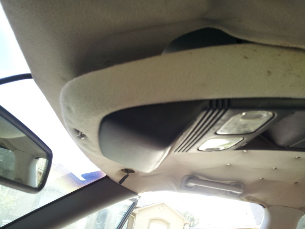

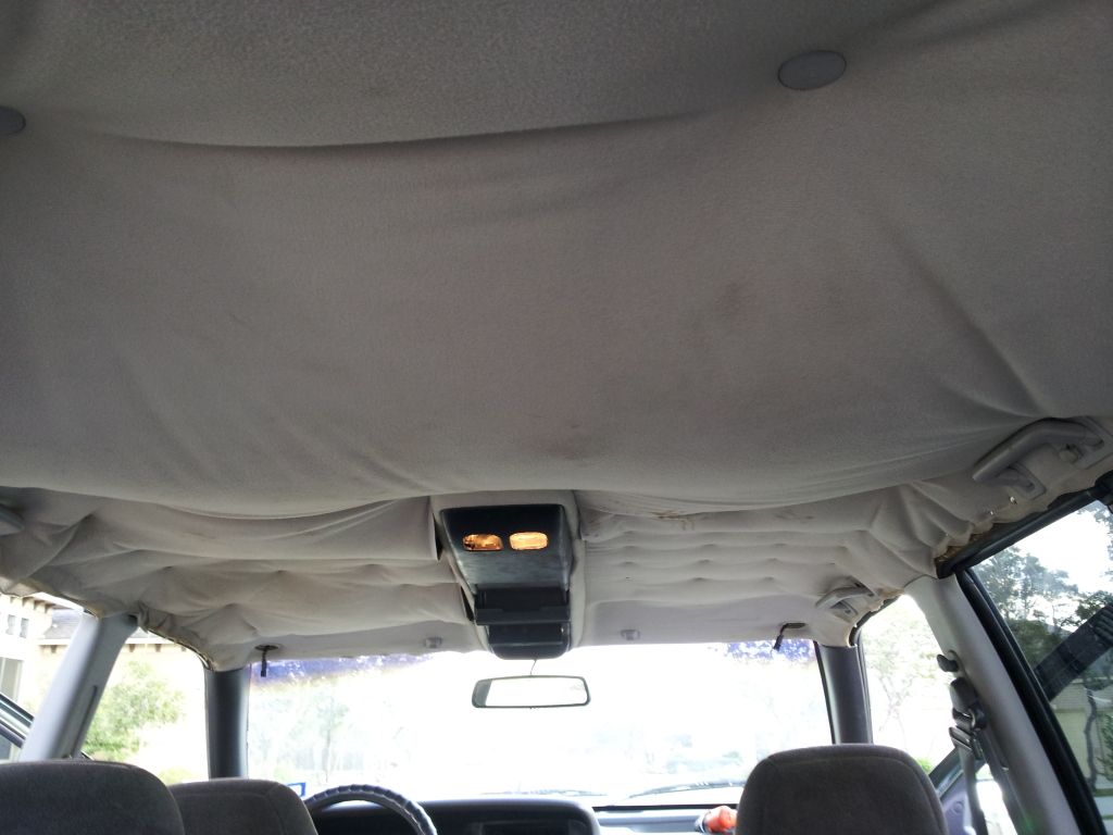

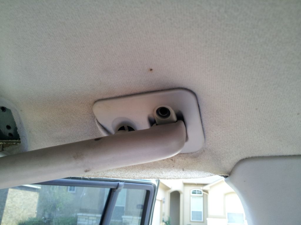

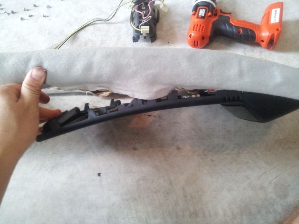

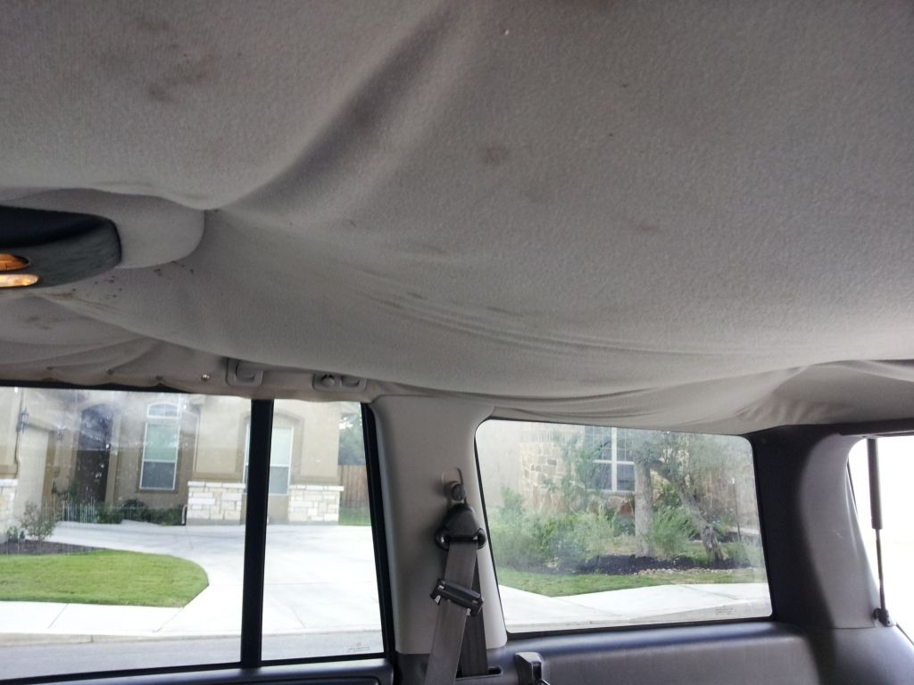

starting off here is what the headliner originally looked like, ha you can see where i had used thumbtacks in the front to reduce sagging until i could finally get around to doing this.

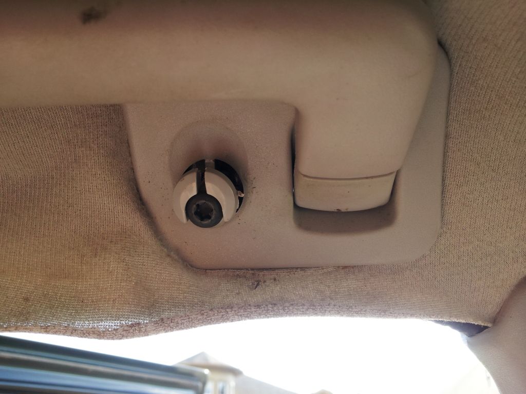

the first thing i did was go around and remove all of the visors and handles using the torx driver
on the back handles their is a little plastic cover over a 3rd screw that you need to remove to get to the head of it

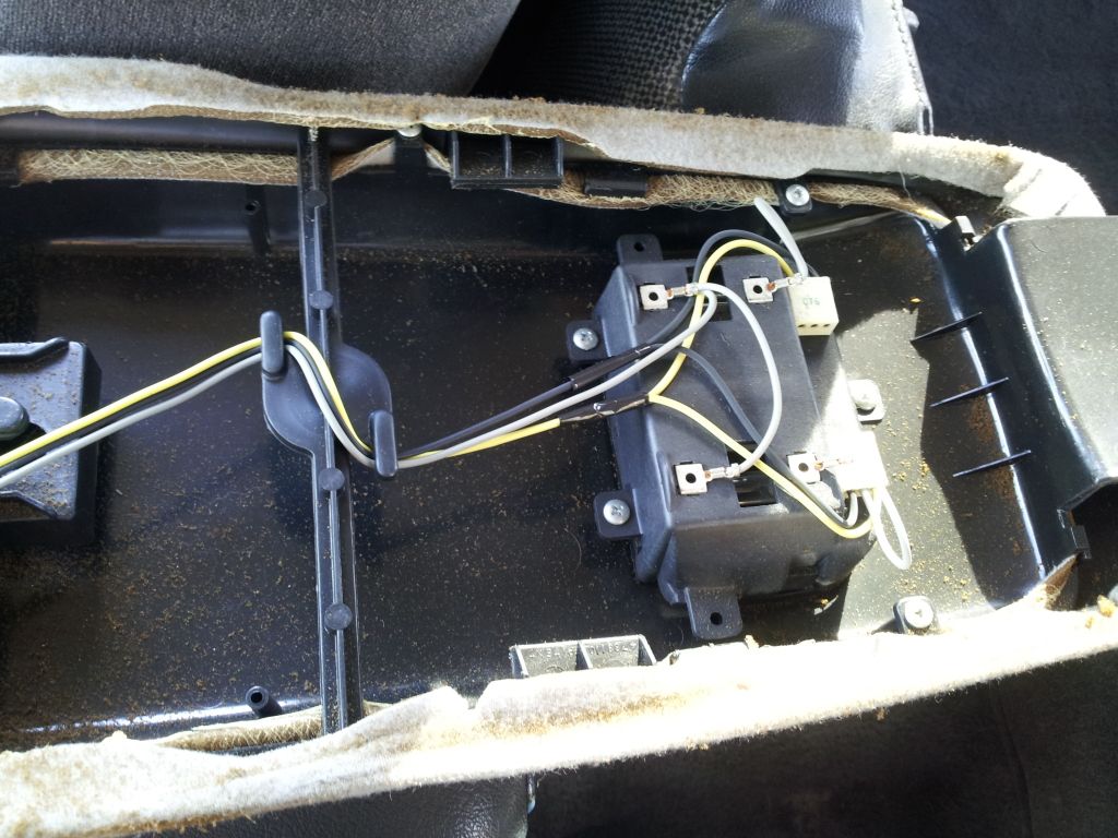

Next i removed the center console by first unscrewing the phillips head screw located at the front of it

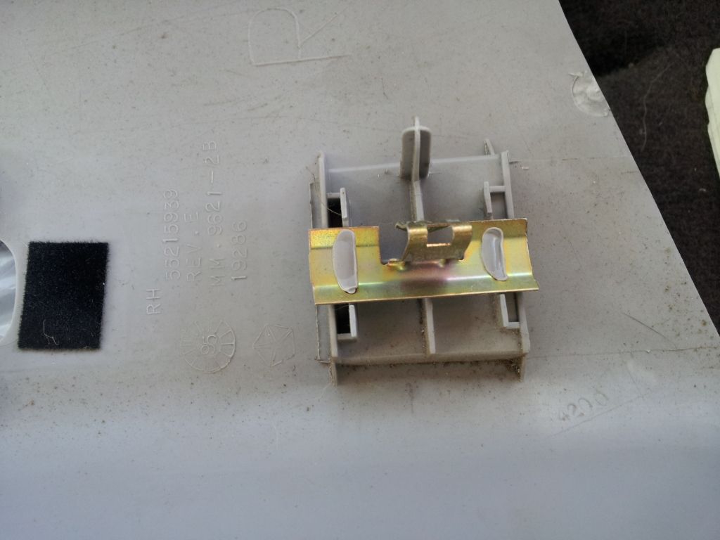

once that is removed you will see the front start to hang down, the back part of the console is held on by like clips and you can slide it forward or backwards and it will slide or kind of pop off
here is a picture of what they look like

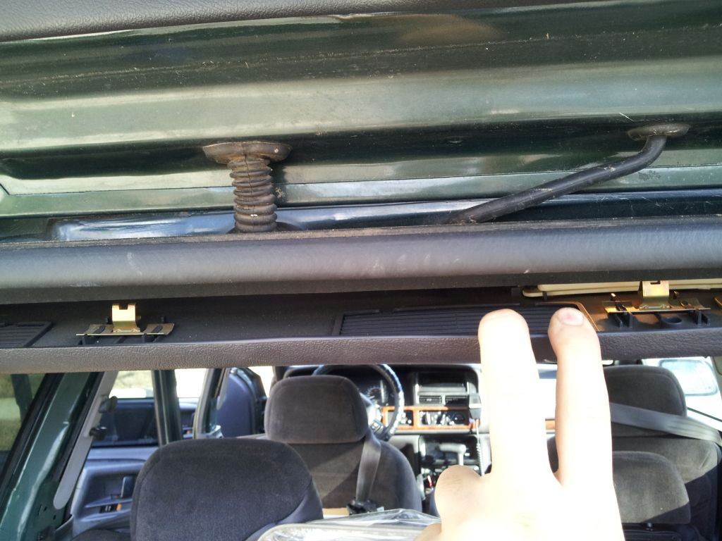

once that was removed i went to the back of the jeep
and started removing the plastic that was screwed in along the tailgate edge
this had 2 screws, one on each end and three clips in the middle that just pop out. i didn't realize this until it was too late but their are also 2 screws inside the rear light that you would have to remove the clear plastic cover to get to, i ended up breaking the part that attaches to the light because i thought it was just going to pop off to separate

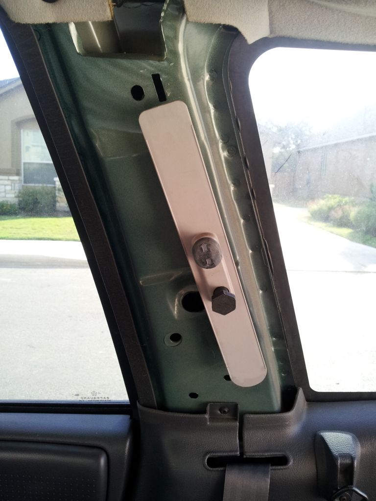

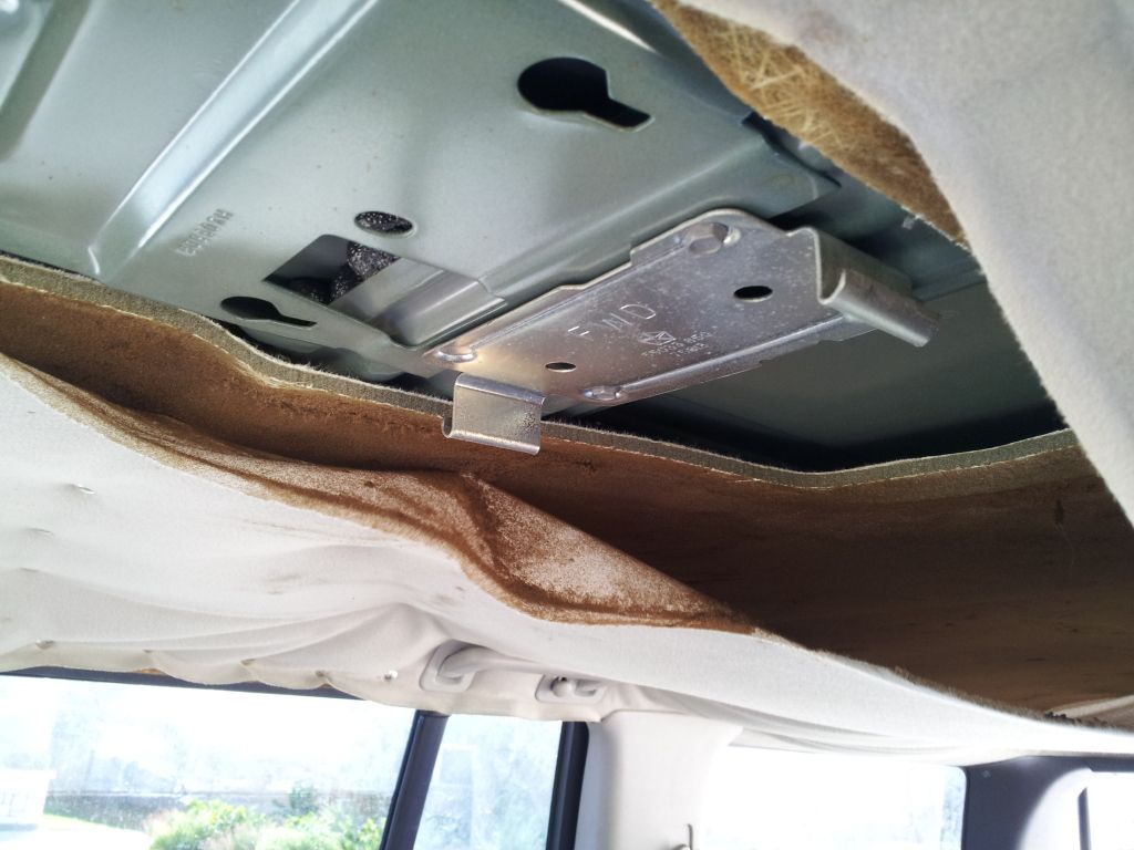

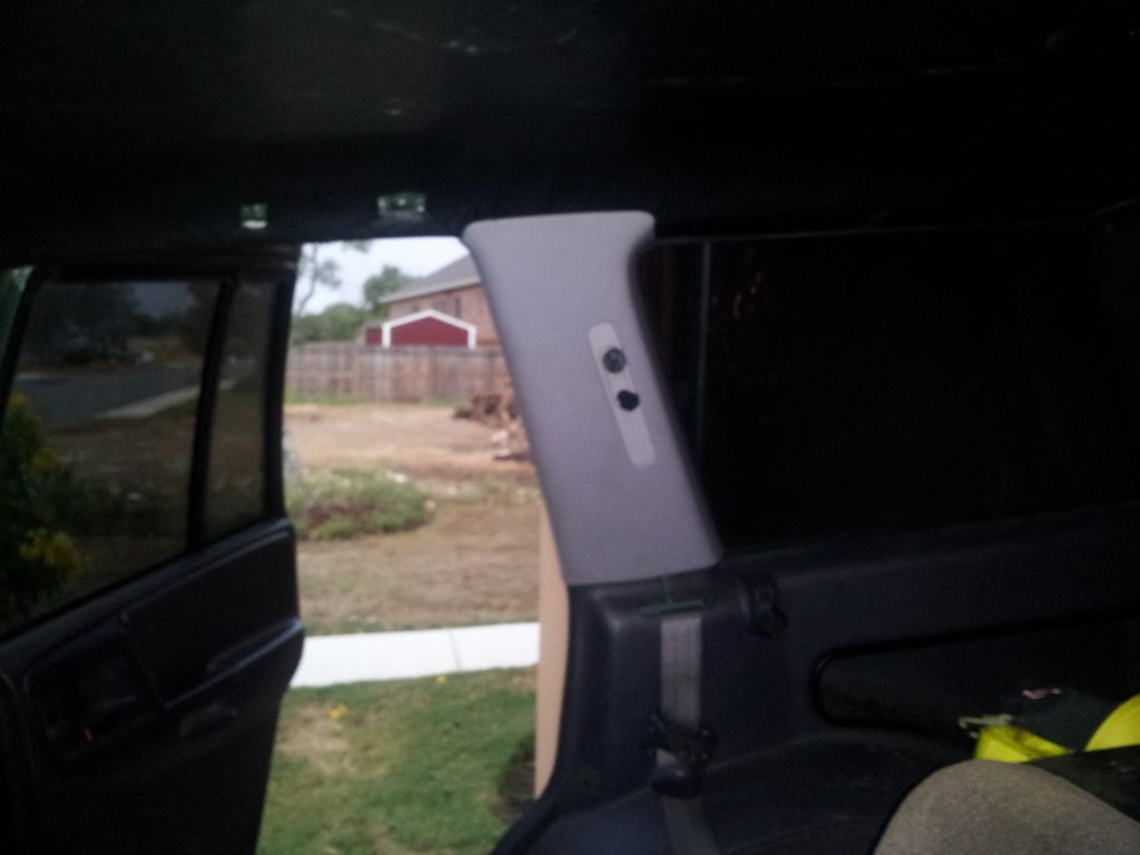

once they were removed i began popping off all of the plastic pillars that support the headliner piece up. Their are no screws involved with these they all use clips that look like this. I found its best to grab from either the top or bottom with a hand on the left and right side and slowly just pry it off. Dont forget to also remove the clips located in the center of the headliner in the back. i started them with a flat head screw driver and used pliers or just my hands to pull them the rest of the way
once all of them are removed the headliner should begin to separate from the roof and fall down. you then can maneuver it out of the back of the jeep.

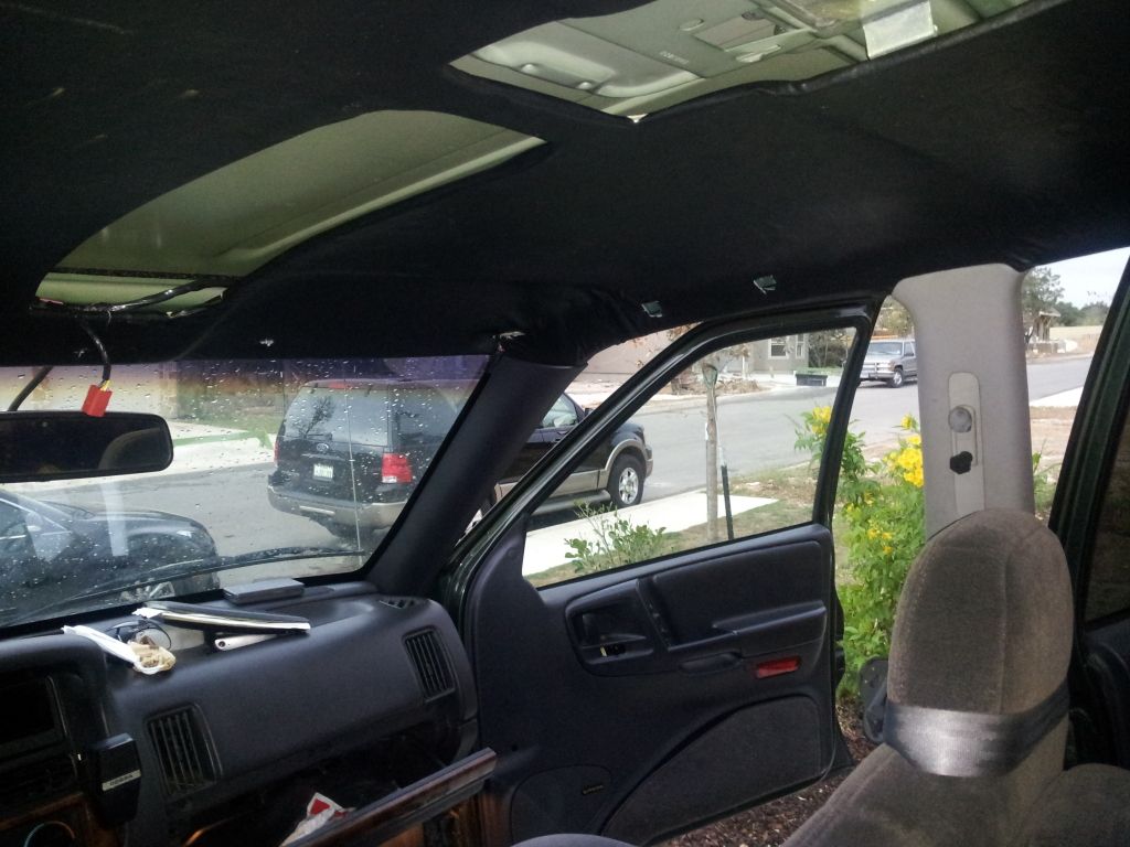

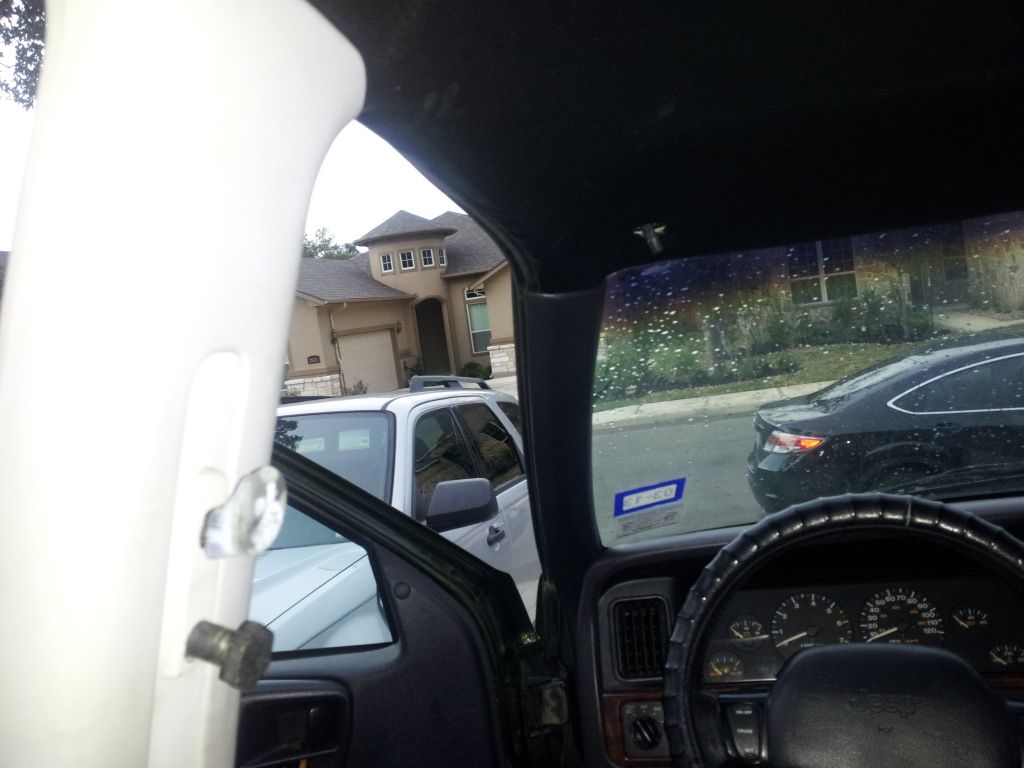

for those interested here is what the jeep looked like without any headliner

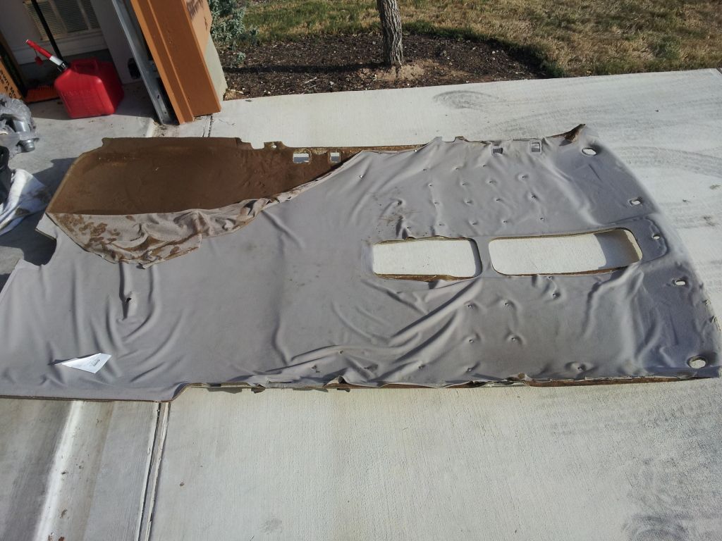

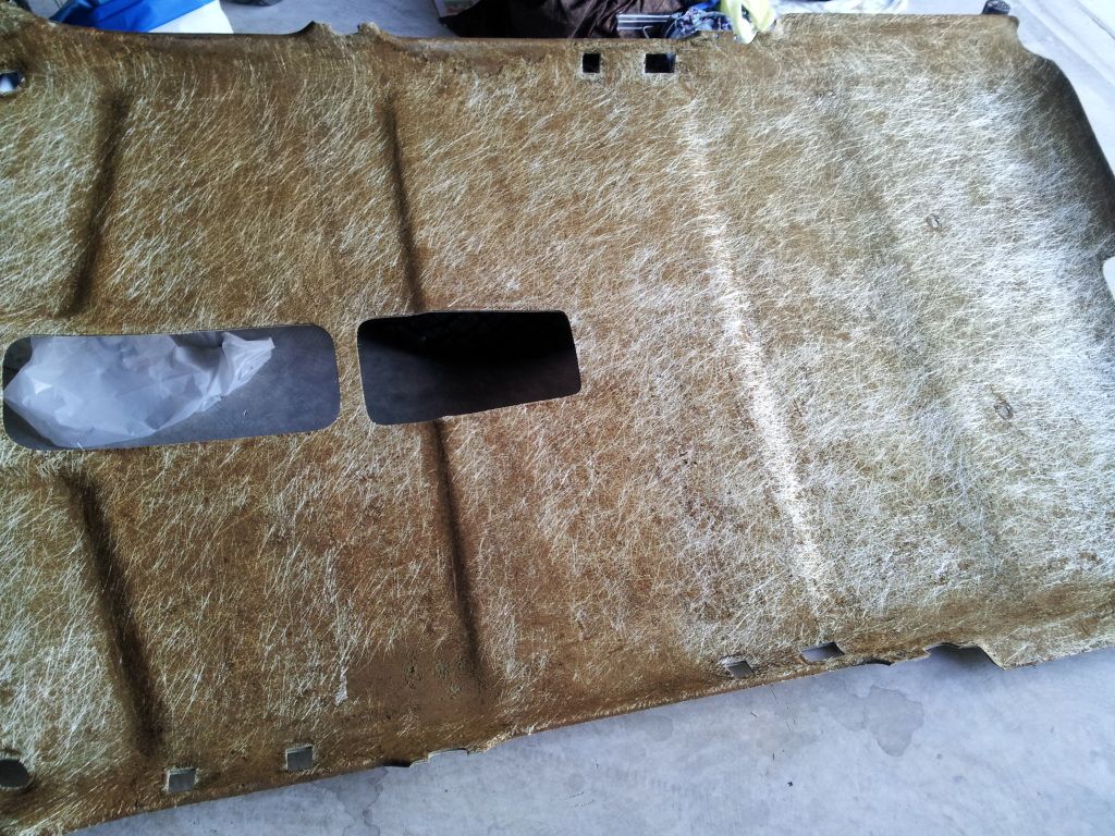

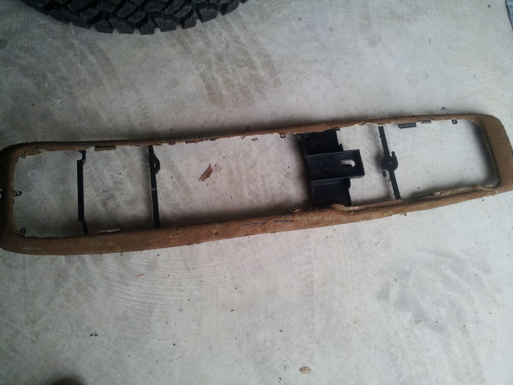

Here is the headliner removed from the jeep. Once it was out i just peeled off the old fabric

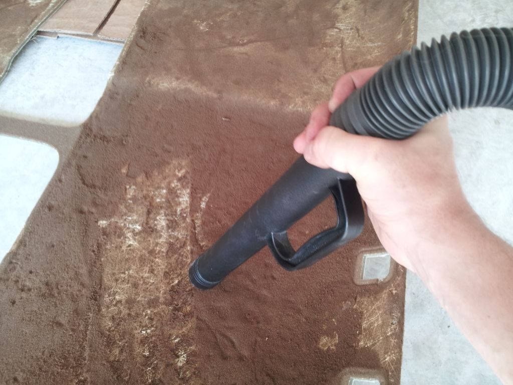

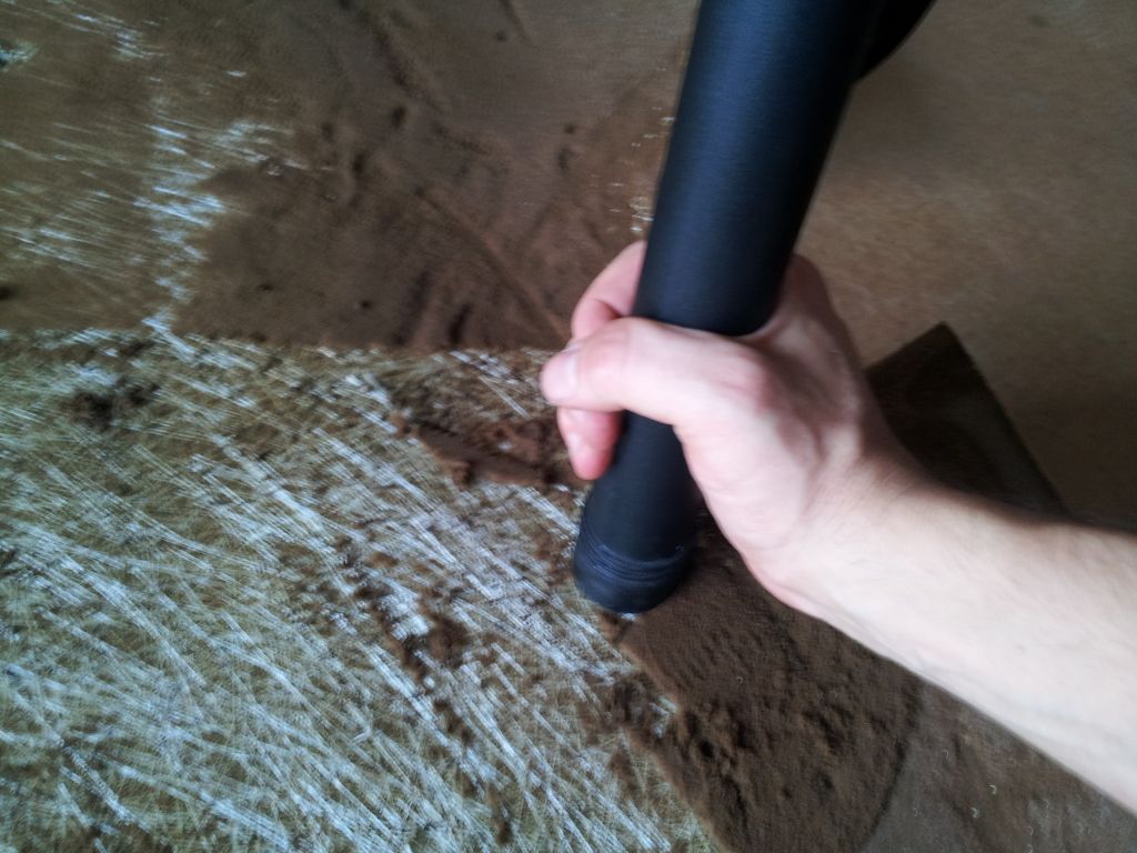

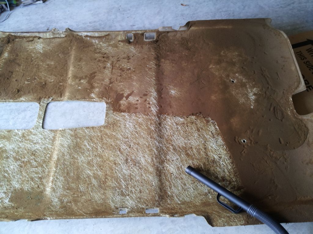

Once it was off i began to clean the old foam off the of fiberglass piece. I used a vacuum and just use the hose to rub off the foam while sucking it up
some people say they rub the foam off and i tried this but i found that the vacuum seemed to get more off.
once it was complete i did run my hand (in a glove of course) over pretty much the whole thing while it was on its side to clear off any loose debris the vacuum missed. and ended up with

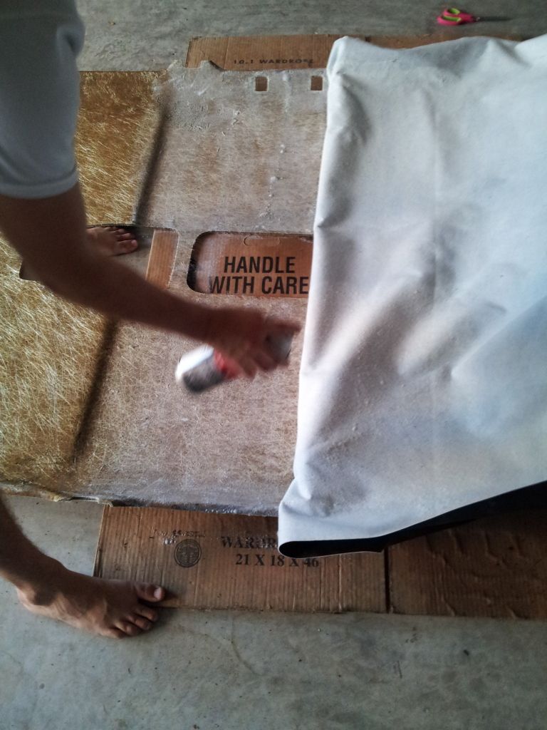

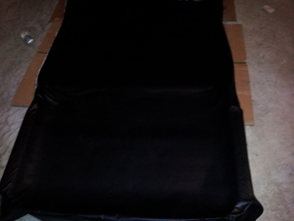

Once that was completed i grabbed my fabric and placed it over the top of the fiberglass piece and lined everything up. i left about 6 inches hanging off the front and back ends
and the width was perfect at 54 inches

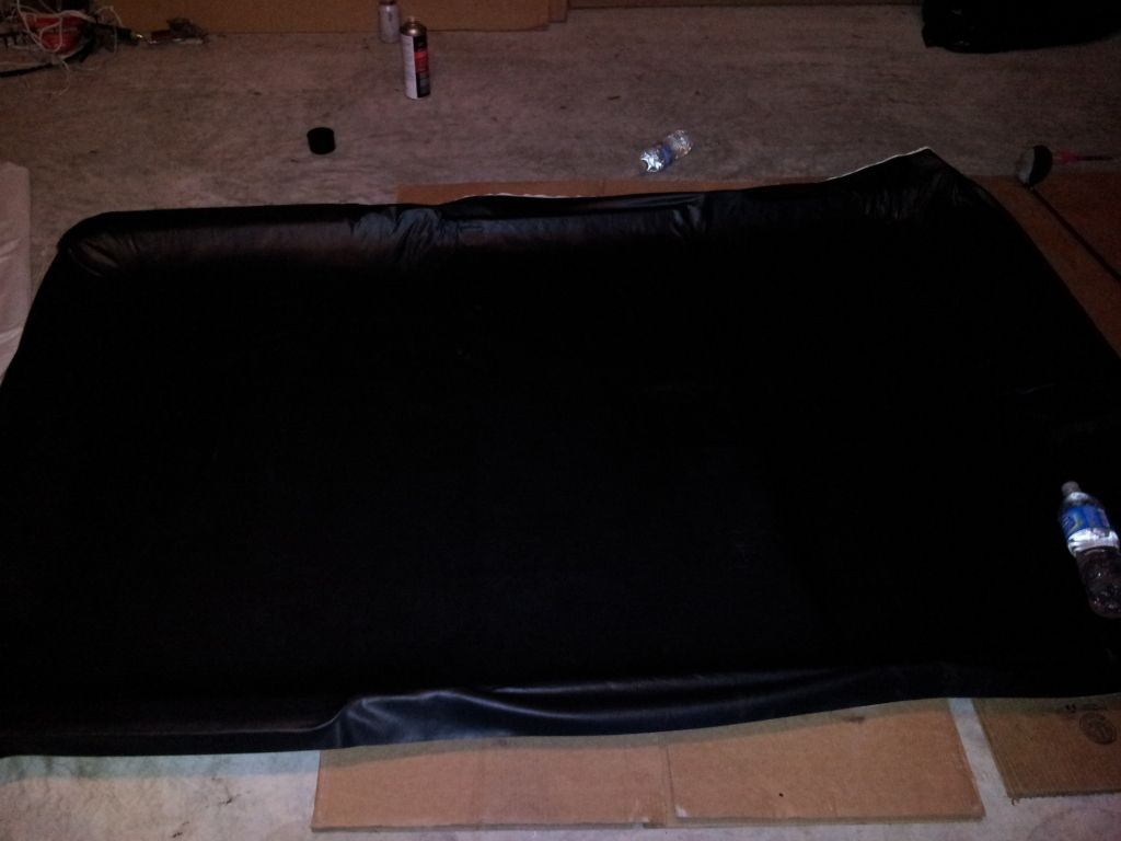

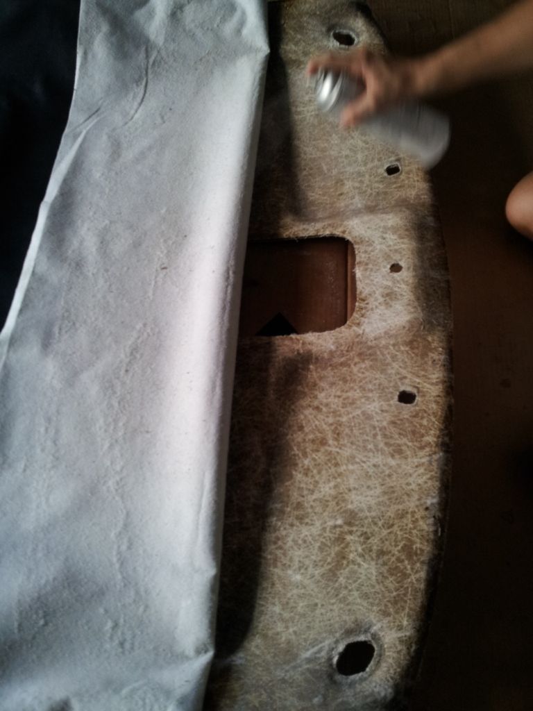

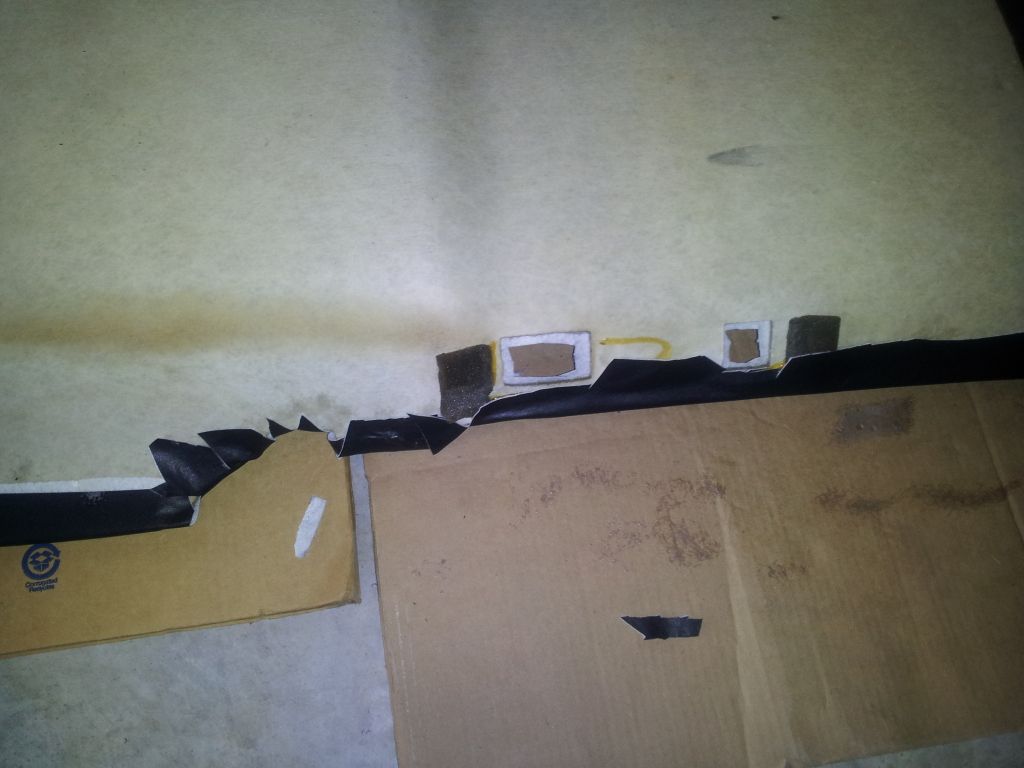

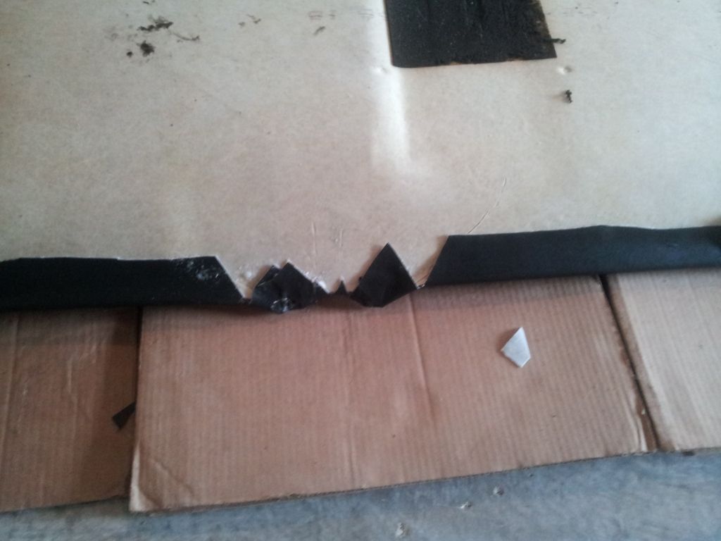

i started at the front of the piece by folding the material over onto itself and applying the 3m adhesive to the fiberglass and to the material
then i pushed all of the material into place starting in and flattening it out towards the edges. The front i found to be the hardest because of the contours on the fiberglass
once this had dried for like 10 minutes i folded the material over itself again so now it is hanging off of the front of the piece and i would spray the adhesive in 3 foot increments spraying both the fiberglass and the fabric

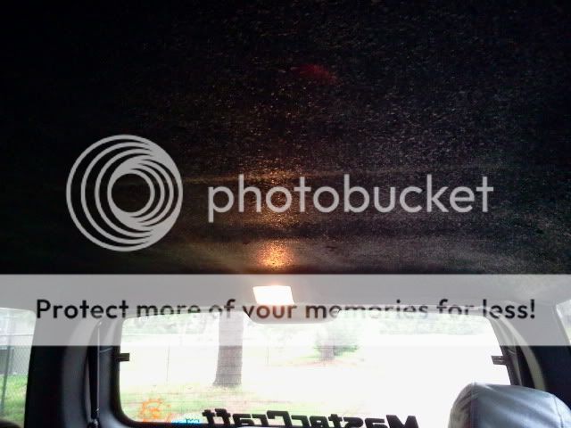

i did this all the way down and ended up with
sorry that material didn't photograph well because it was dark when i was taking those last pictures
I will be finishing it today, what remains it cutting the edges of the material around the fiber glass and using an exacto knife to cut out the whole in the material for the handles and visors etc.

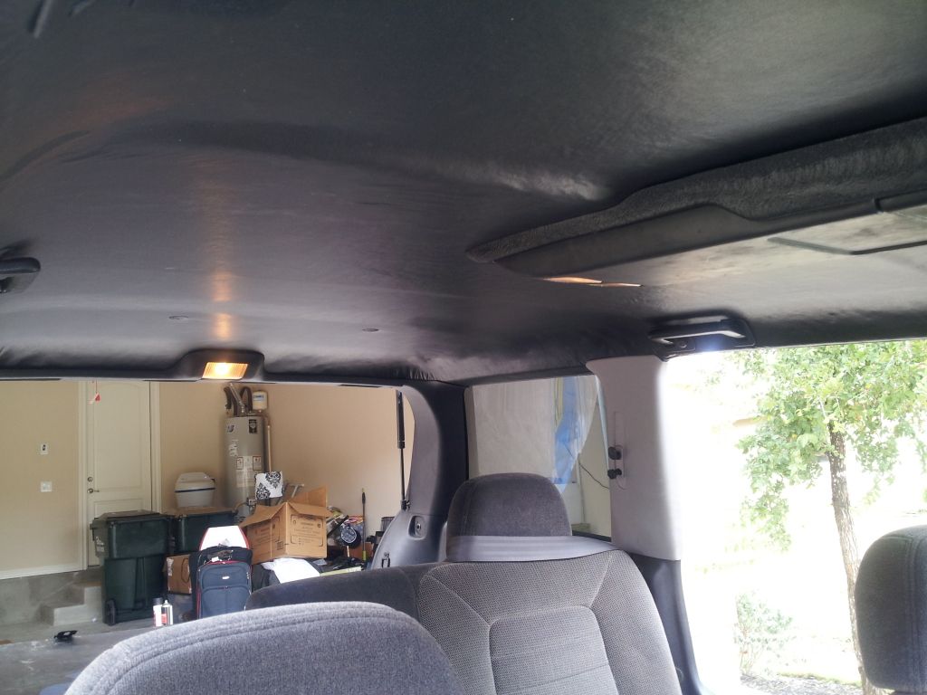

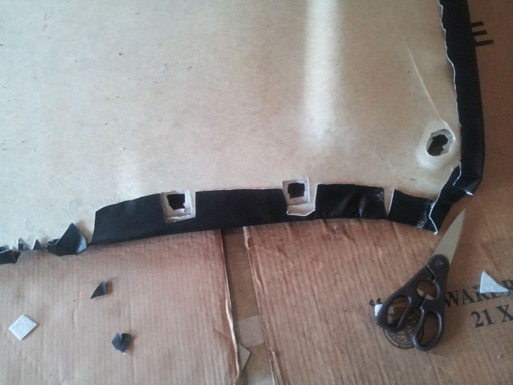

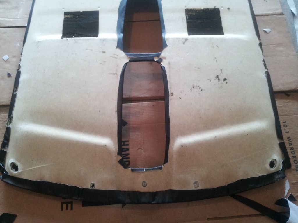

I flipped the headliner over and finished trimming the edges of the now that it was attached to the fiberglass piece.
once they were all trimmed and the proper holes for things like handles and visors were cut out i folded the edges over and used my spray adhesive to attach the vinyl so that it would fold over the edges and give it a nice appearance. i didnt notice that it was like this on the original fabric but i figured while i was doing it i might as well put a little extra work into it so that it would give a a nice appearance. This was more tedious than anything.
And the curved parts of the fiberglass i would have to cut a line into the curve (Im not sure if that makes sense) but you can see the triangle like pieces that are attached to the topside of the fiberglass piece

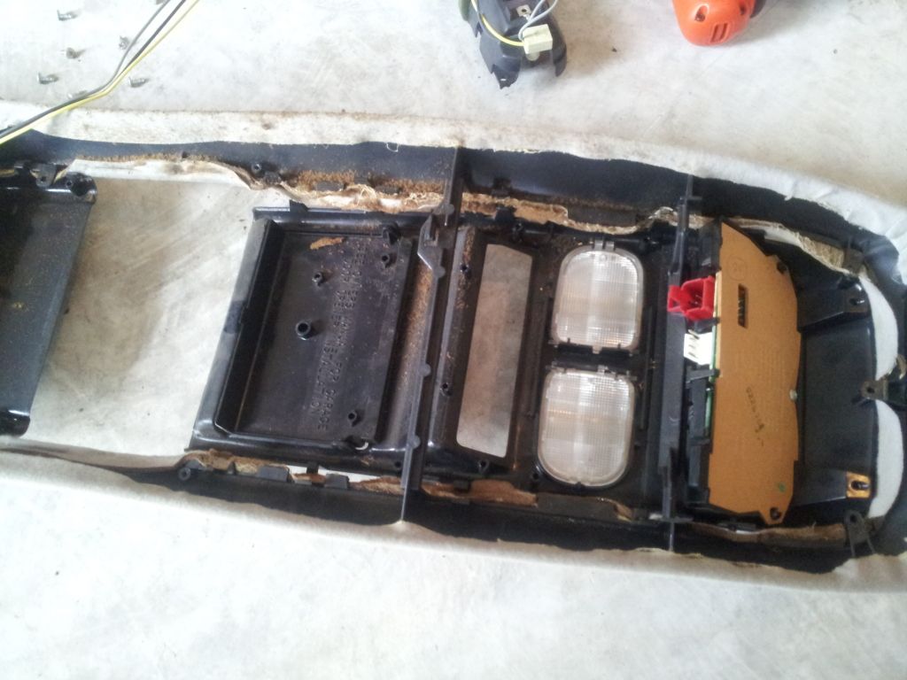

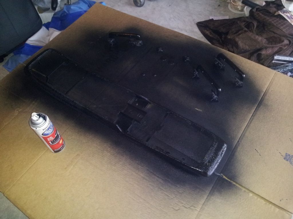

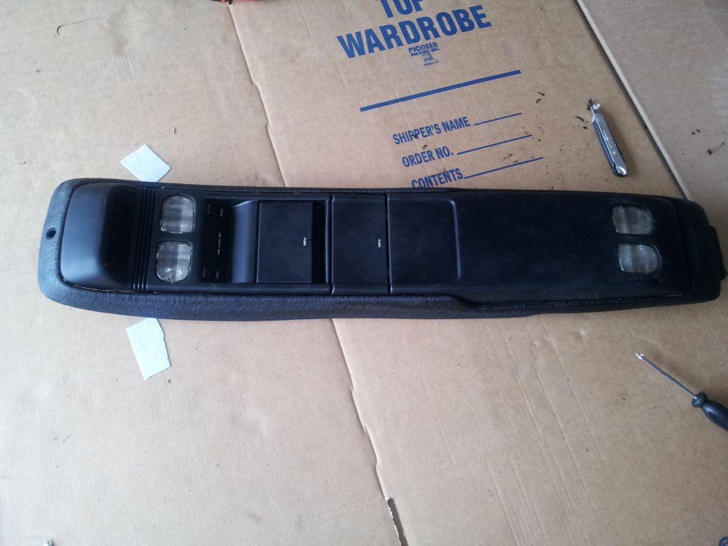

now the headliner is pretty much complete but i wanted some of the accessories to look a little nicer so i decided to do some work on those. The first piece i looked at was the overhead console. it also had that old gray fabric and just was not very visually appealing.

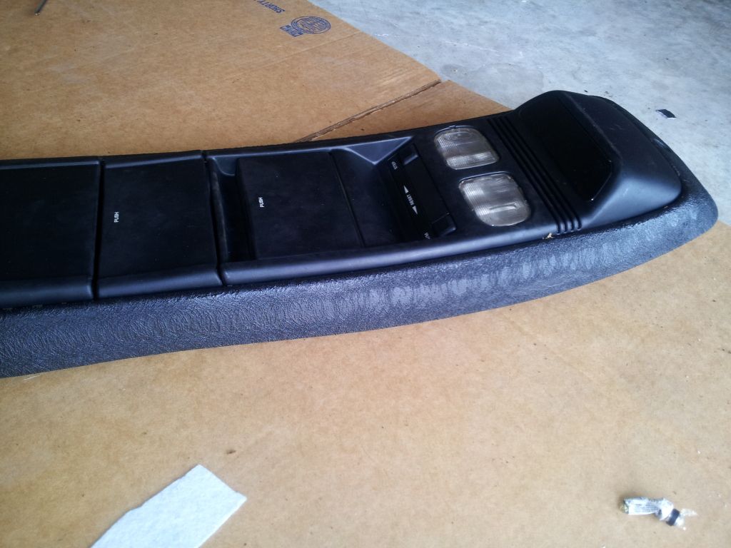

i started by unscrewing all of the screws along the inside of the console, their were around 20ish. Once they were all out you can remove the light fixtures and the controls for your mpg stuff if you have them. Once that stuff was out the part that holds the sunglasses and everything along the center of the console was able to kind of pop out to separate. Once this is completed to can easily begin ripping off the old fabric and rubbing off the previous adhesive in pretty much the same manner of the headliner. Once it was cleaned to the best of my ability by just rubbing it was ready to paint.

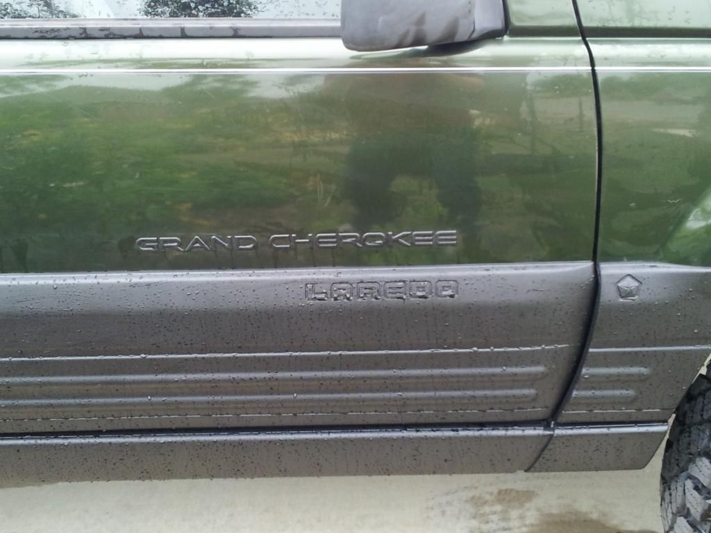

So along with the center console decided to paint the handles, visor clips and the back clip things that push into the headliner. i ended up using a spary-on truck bed liner from autozone that i have used on previous projects

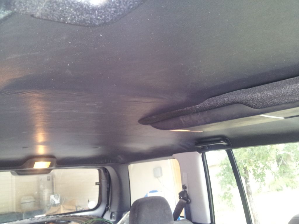

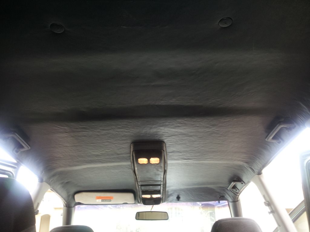

While i was waiting for this to dry i went ahead and maneuvered the headliner into place and used the plastic pillar pieces to hold it into position

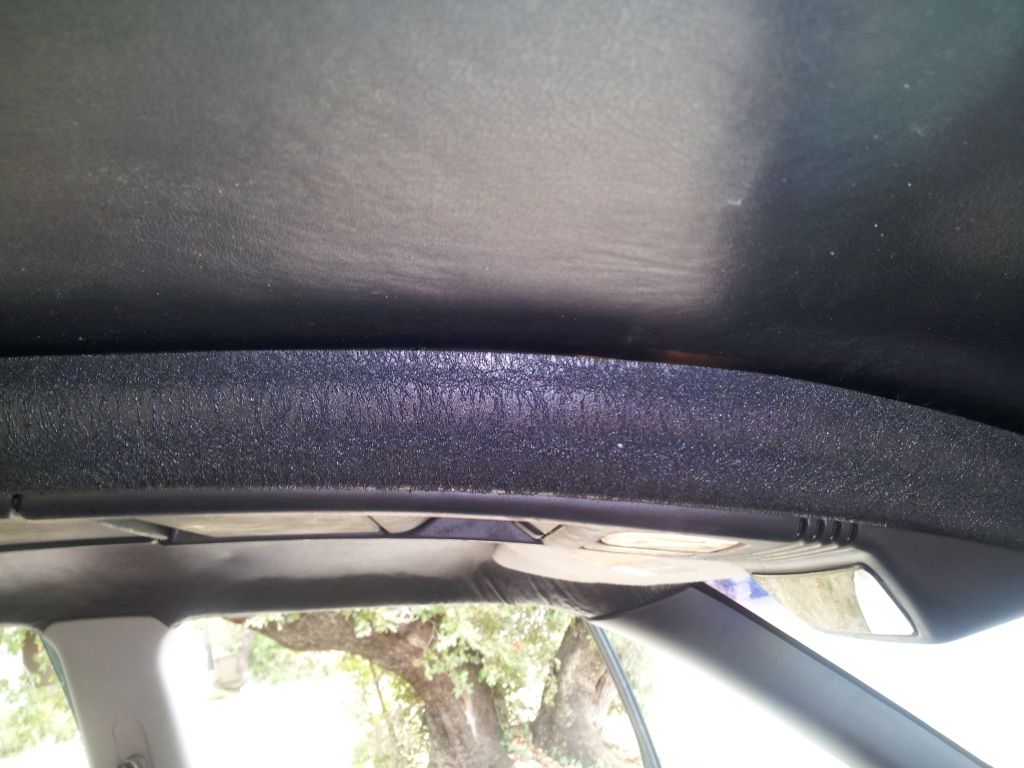

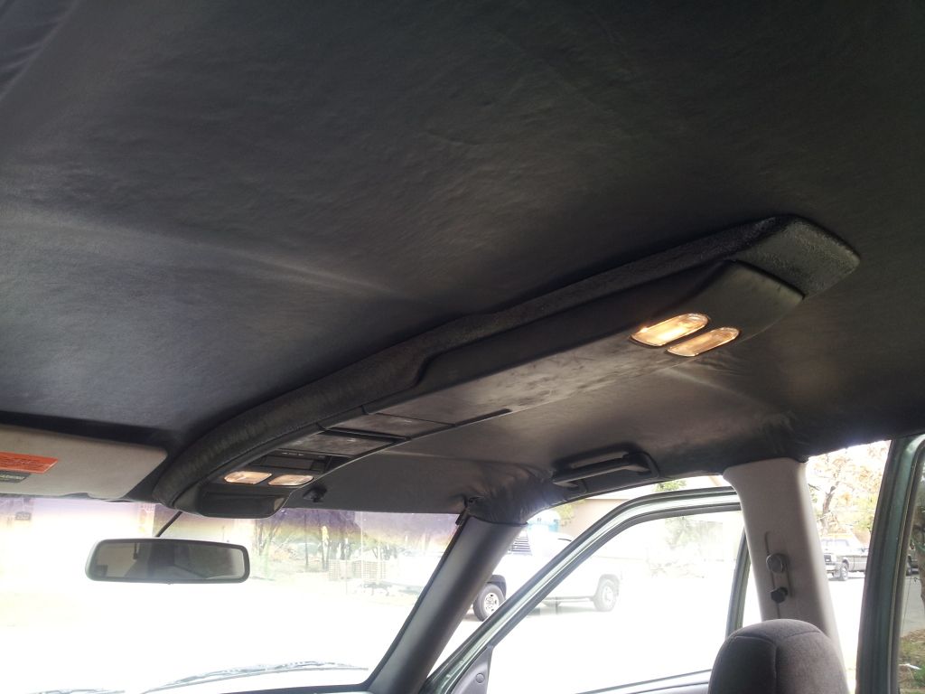

Once the console and handles dried they ended up looking like this. You can see it has somewhat of a textured look and also some of the old adhesive that wouldnt remove kind of shows through but i dont think it looks bad. I thought about trying to use that fabric around the edge but it would have been very difficult for my level of fabric working ha and i think it wouldn't have lasted as long as i know this spray on liner will

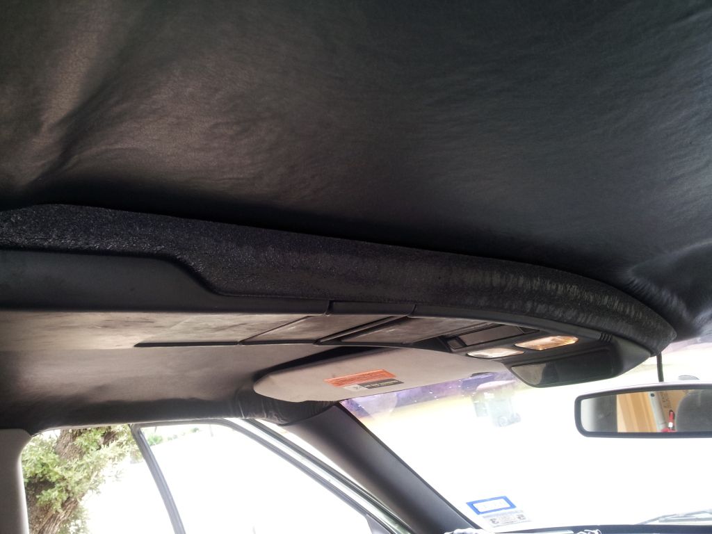

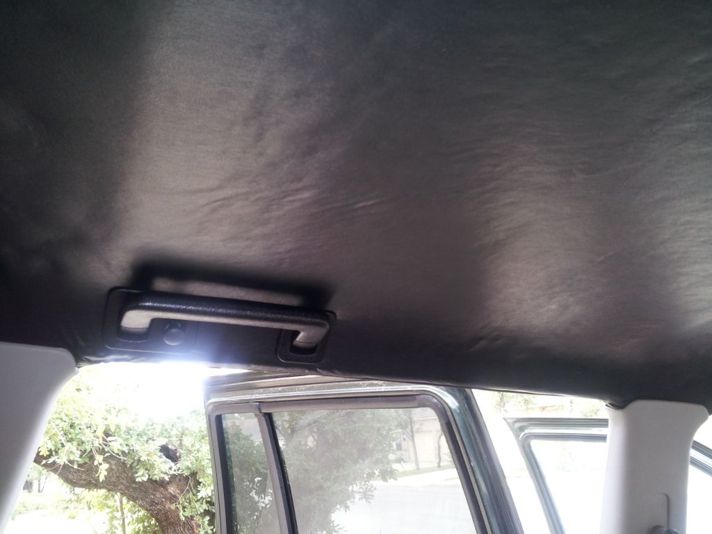

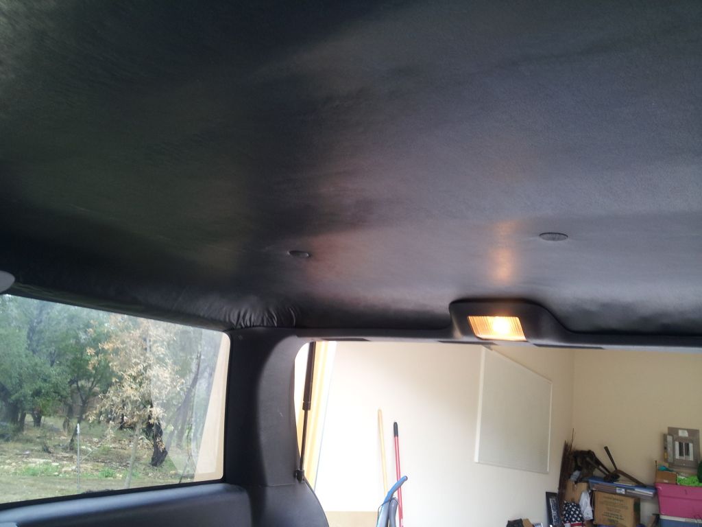

okay so now that everything is done its ready to all be assembled. Everything went together very well and i am very pleased with the turn out.
here is a before and after
the only downfall to not using a fabric on the console is that you can see a tiny space between it and the headliner that the fabric would have filled, but this is only really noticeable from a direct side view with your head touching the ceiling
Overall it was a solid like 6 hours of work not including drying time, it was much easier then i thought it was going to be, even more so getting it out the more difficult/ time consuming part was prepping the headline so it was ready for the new fabric.

okay look at the center console i painted. i used a spray on bedliner from autozone and i think that is my favorite part of the whole thing. IF i could do it again i would really contemplate spraying the whole headliner piece with bedliner because it was would be cheap and so much less tidious then attaching that new fabric for the headliner. On the other hand the fabric does give it a nice look.
I have seen another thread where someone actually sprayed the whole fiberglass piece with bedliner
this has some pics of a xj
http://www.jeepforum.com/forum/f177/...dliner-890996/
it looks okay. i saw a zj with it that looked alot better though.

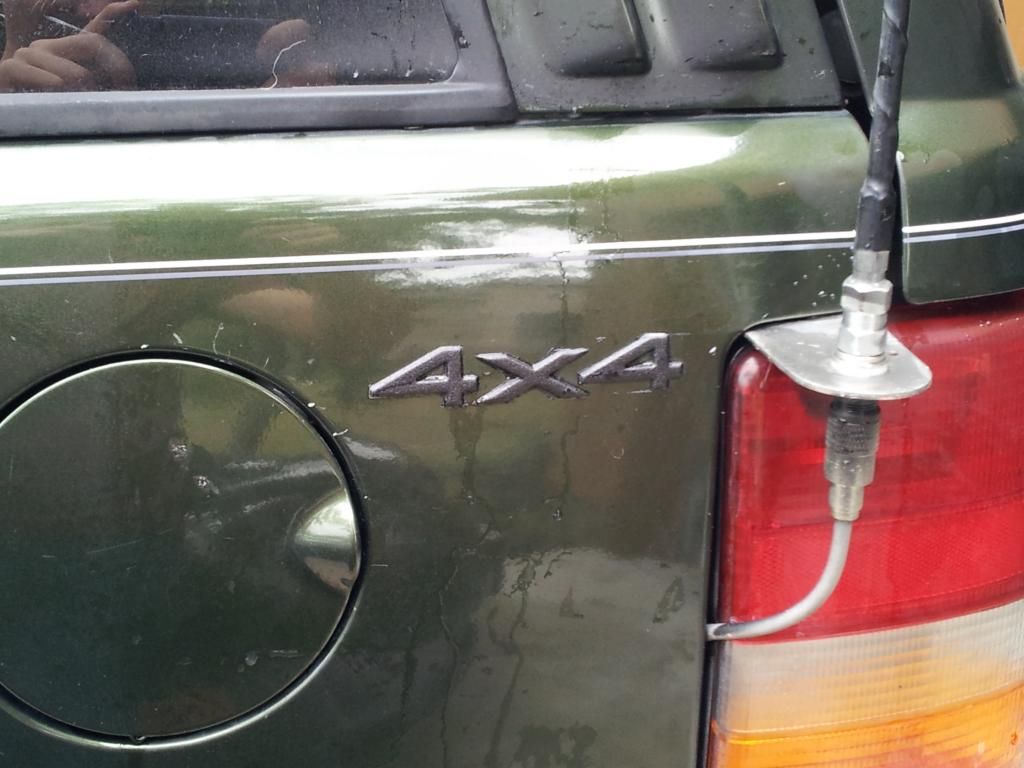

haha i liked it so much i decided to do all my cladding and grill with it as well
here is a old pic to reference
