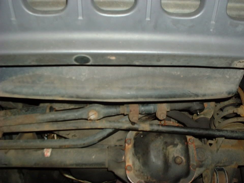

Arlo: maybe this will cheer you up. This is my bent tie-rod. I got DW around the same time I discovered that my tie-rod was bent. After replacing the tie-rod, with the Rustyís conversion, I STILL had DW!!

i was going to say maybe your tierod or draglink may be bent and flexing a bit but after seeing that pic . are all your wheel weights still on the rims? i mark mine to make sure theres no movement.
