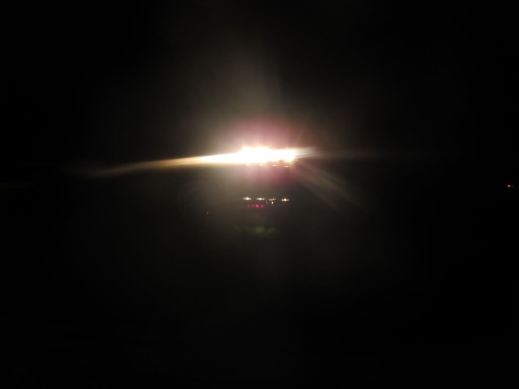

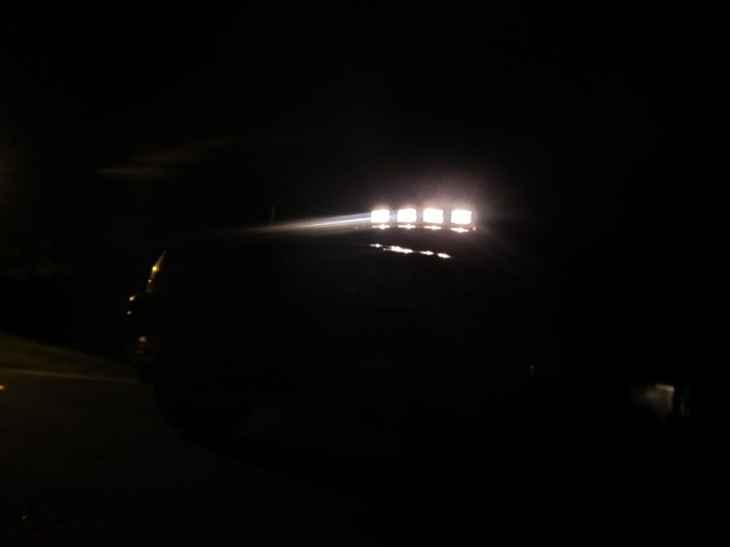

Hey all here are a few photos of my light install, I put on 4 Hella 500FF's. Not sure if anyone has done this install like this but might as well put it up, who knows it may serve as inspiration to someone to do it.
I installed all the relays that came with the lights in the upper console along with the switches, made it to where I could either have the outer two on or the inner two on seperate from one another, or just have all of them on.
ran the wires between the headliner and the roof, down behind the passenger side pillar fascia and into the engine bay. then from there they went up through the metal clip on the side of the windshield up to the stock roof rack mounts. my "light bar on a budget'' but never the less it works great. all wires are covered in wire loom and will soon be soldered at every connection to assure connectivity. let me know what you all think. thanks for looking; any other questions feel free to ask.

lets see some head on shots, and some shots of the lights shining on somethin.

Oh and I forgot to mention that the picture with the lights installed in the garage are before all wiring was done, I just snapped the pic to send to my friends to get input from them, there is loom covering everything up now
