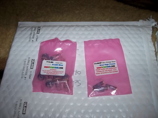

Finally switched out the ugly stock green lights in my gauge console and the ring around the ignition today, now it's all lit up in a sweet looking BLUE. Actually ordered one bulb to few, and wasn't able to put them in the shifter, but I'll get that eventually. But for now, I'm very happy with the way they turned out! I was also going to replace the ones in the climate control, but the bulbs I got didn't match up....
Got the bulbs for SuperBrightLEDs, ordered 8 of the T13-x6, and 4 of the 74-xHP.
All finished, in person it doesn't have all the bright and dim spots, its very uniform!
If anybody could tell me what the correct lights for the climate control are, I would appreciate it. I got all my numbers from:OSRAM SYLVANIA - Replacement Guide - Start

Originally Posted by gatorayde View Post
Looks good. You should've pulled the ABS bulb out while you were in there Well, it looks like the ABS light but the pic is too blurry to tell.
Yeah, I didn't think about that, it is the ABS light. Got a bad speed sensor that I haven't got around to replacing so thats why its on...
Originally Posted by Noiitekk View Post
Looks good, this is on my definite to-do list. How much did it run you for all of them?
The total was right around $35 plus tax.
Originally Posted by EisBlade
You gave us how many of each you ordered, but also mentioned not having ordered enough and being 1 bulb short. Which bulb number were you short, T13-x6 or the 74-xHP?
I was 1 short on the T13-x6, I read that the console only needed 7 but when I pulled it out there were 8. And like I mentioned earlier, the bright and dim spots dont really show in real life, my camera makes them way more visible.
The install was kind of a PITA, but the result makes it all worth it!

Originally Posted by bball128 View Post
That looks sweet. I want to do the same thing sometime. Did you have any trouble figuring out the correct way to put the LEDs in?
The lights are polarized so they can only go in one way, the only way I know of to get it right is to test it, and flip the ones that dont light.

i was thinking about doing mine to. so you need 8 bulbs for a zj? for dash
studmichael is offline
post #15 of 56 Old 11-15-2009, 09:25 AM Thread Starter
BlackbeastZJ
Location: Fairborn, OH
Posts: 525
Yeah, theres 6 for the gauges and 2 for the turn signals.
