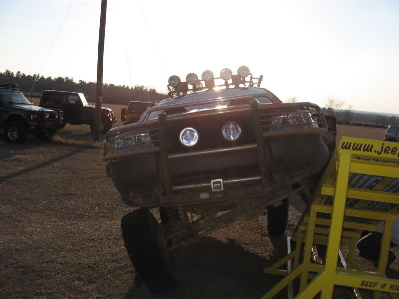

I havent ran claytons kit but I have ran rock krawlers on a comanche and a friend has been running rock krawlers kit since at least 04
I was happy with rock krawlers kit but they have improved there kit since I have ran there kit
either kit you get you will most likely be happy with it
heres a pic from early 05 of a frined running the rock krawler kit and he is still running the same kit
