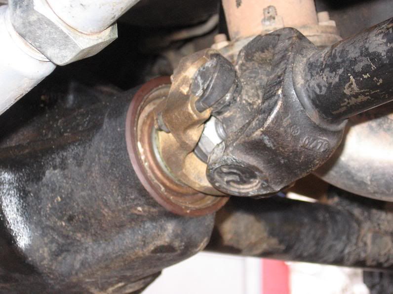

Im a little confused... What is this '242 shaft' you got for $25, front drive shaft? The double cardan joint (TC end of the driveshaft) will bolt up but if you had a CV joint at the axle, you're going to have to change yokes on the pinion. You'll need to ditch the yoke thats for a CV joint and get a yoke for u-joints.
CV joint pinion yoke.
U-joint pinion yoke.
