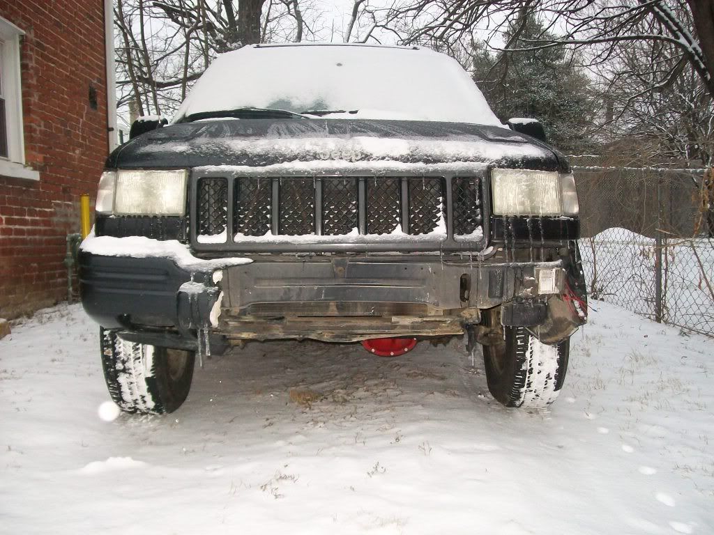

Im thinking about removing my stock front bumper because I like the look without it more. Is this going to be a bad idea? Or anything I need to worry about? And I will not be offroading while its off. If its a bad idea I wont do it, but Im wondering if its possible or if anyone else does it? Eventually I will be buying an aftermarket bumper. Thanks !

Take the ****er off!!! No issues it wont hurt anything

Mine fell off after I ran into a stump. No problem wheeling with it on or off. It's just plastic.

The bumper doesn't support anything. It's flimsy cheap plastic.

Headlights mount into the header panel (behind the grill) the bumper is a completely separate piece.

The ONLY problem you might have is it's illegal in some areas to run without a bumper cover particularly when dealing with large lift kits, at least here in the states.. I have no clue about B.C.'s laws tho. That and you can't mount the flimsy road lights into the plastic bumper cover, though why would ya want those on a Jeep anyways haha

If you wanna do it the pretty way then you gotta push the plastic pins off take you grill over off theres some there and sometimes theres some in the bottom of the bumper holding it under de radiator, take the plastic pins from the mud covers by the wheel and thats bout it it should fall off since the side plastic stoppers only slide into the cars side posts
It doesn't support anything special only your whole engine, so don't be scared to pull it off

you'll need to do something with the wheel well liners. they flap in the breeze otherwise. i had mine off fixing some damage and they tried to rub the tires but i hog tied them so they couldnt

They rub against your tires and melt. I used zip ties to tie them up.
