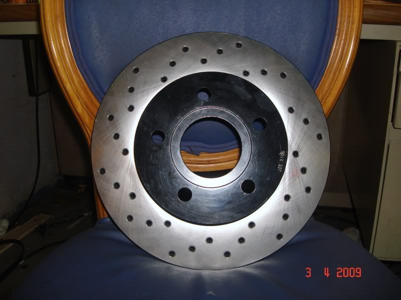

A couple years ago, I switched to drilled rotors..... OEM are crap. I still have calipers that came on my 2000 WJ, but no more pulsations.

Sounds like a warped rotor. Did you put on ceramic brake pads when you changed them? thos create a lot of heat and will tend to warp rotors faster. Drilled or vented rotors will help with this.

I did put ceramic pads on it to reduce the amount of brake dust on the wheels. Where do I go to get a good set of drilled or vented rotors?
