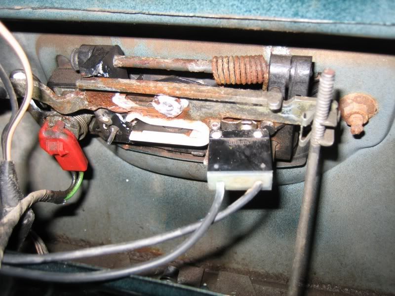

You have to test the circuit to find out which of the components is gone. Could be the button, the release solenoid or the limit switch that's faulty. For me it was the limit switch, a sealed microswitch that's riveted to the liftgate lock. When I knocked it off and opened it up, the tiny spring inside was broke. Can't find a replacement anywhere without buying the complete lock assembly! Been driving without it since.

thats the picture of the lift gate latch.. that works.. but im talking about the glass in the liftgate lifting up.. i dont think its the same unit...hmmm but i dont know

The black plastic thing with 2 wires coming out of it in the foreground is the limit switch for the liftglass. It's attached to the lock and is activated to close the circuit when the latch moves against it (when it's unlocked). You can unplug the wires at the other end and run a bypass wire to see if it's the switch that's causing the problem.
