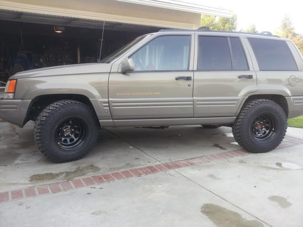

I have 3.5" iro f>r swap and 33x11 tires

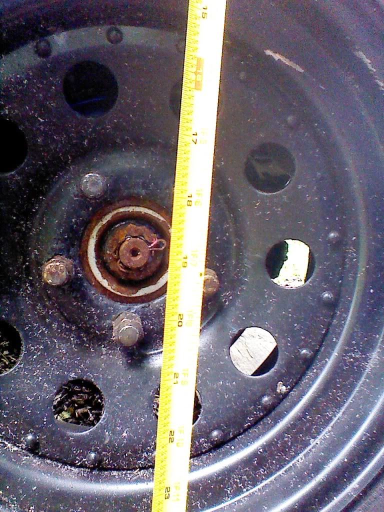

Im sorry, i was mistaken. I do have aftermarket shocks(original owner put them in) and they are ProComp ES3000s. That is the only mod to the suspension but it did give an inch of lift i didnt know i had. From center of wheel to bottom of fender measures 19 inches. I do not have the UC package because my springs are not coded for it. Front driver spring is coded FM which means it did not get the UC package.

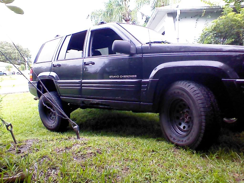

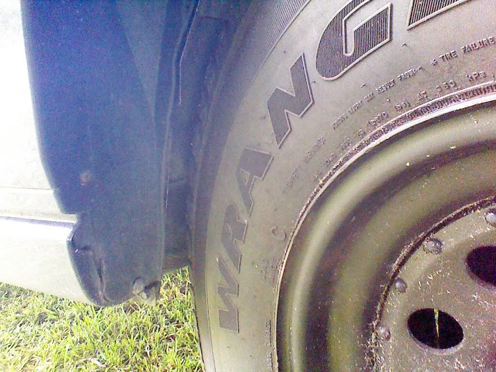

Pics are terrible quality cuz my tablets camera sucks plus i had to use photobucket because file size was too big.
This is the most flex i could do at the time because im not near any hills or trails. The front wheel pic looks closer to the well that it really is because of pic angle. It looks like its less than 1/4 inch but its actually more like 3/4 inch. Remember, this is with non up country package, but there are pro comp es3000 shocks on the truck that give it that 1" lift.
This pic was taken on level ground.
Ill take better pics if you want.
