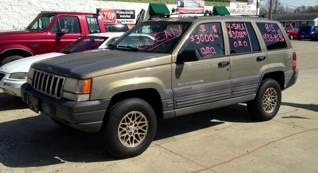

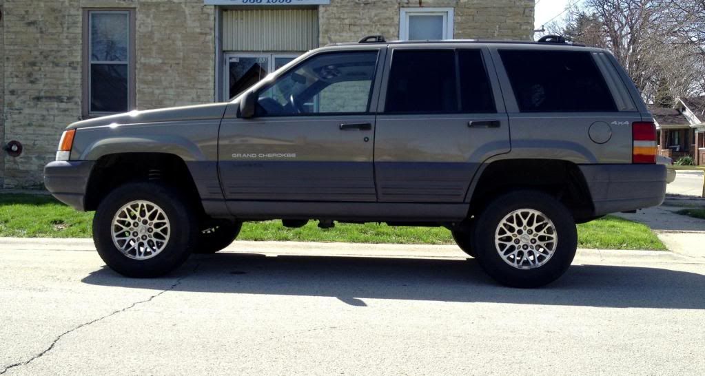

RE 3.5 coils in the front, my stock I6 coils in the rear. I was lucky to have it be pretty level afterwards but have one simple issue. It's tooo level, I feel if I load the back end down at all that it will sag. Will the new springs up front "break in" and lose height after say a month? Or should I add an isolater or 2 in the rear? *stock wheels and tires in these pics, I have 32s going on this week.
Before( was jeepless for the winter until replaced with this jeep last week)
After
Thanks guys!

Looks sharp!
I'd just do a 0.75" spacer in the rear or V8 coils to bring it up a hair.

I doubled my spacers all around. No issues. Easy to add/remove. Id say do it.

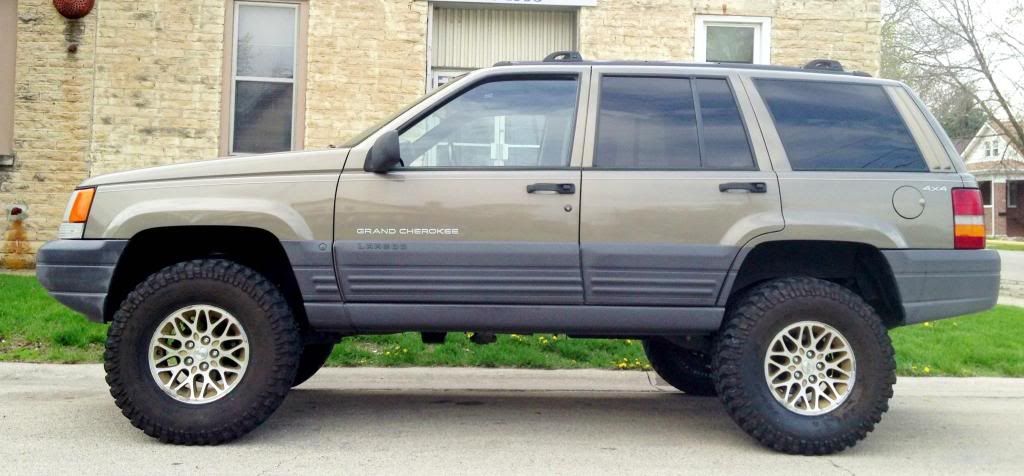

Just wanted to throw up a pic with the 32s on

Good lookin tires. I like the color
