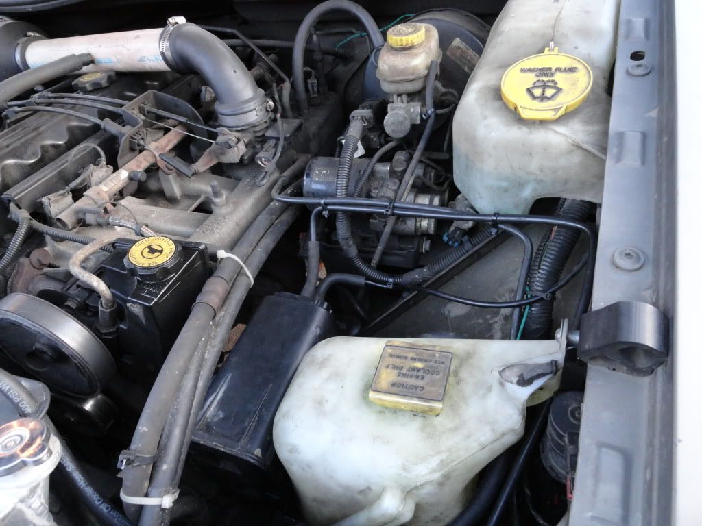

Posts: 1,035

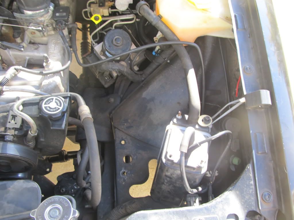

Here ya go I had a newer square canister from a parts jeep and went with that over the original round one

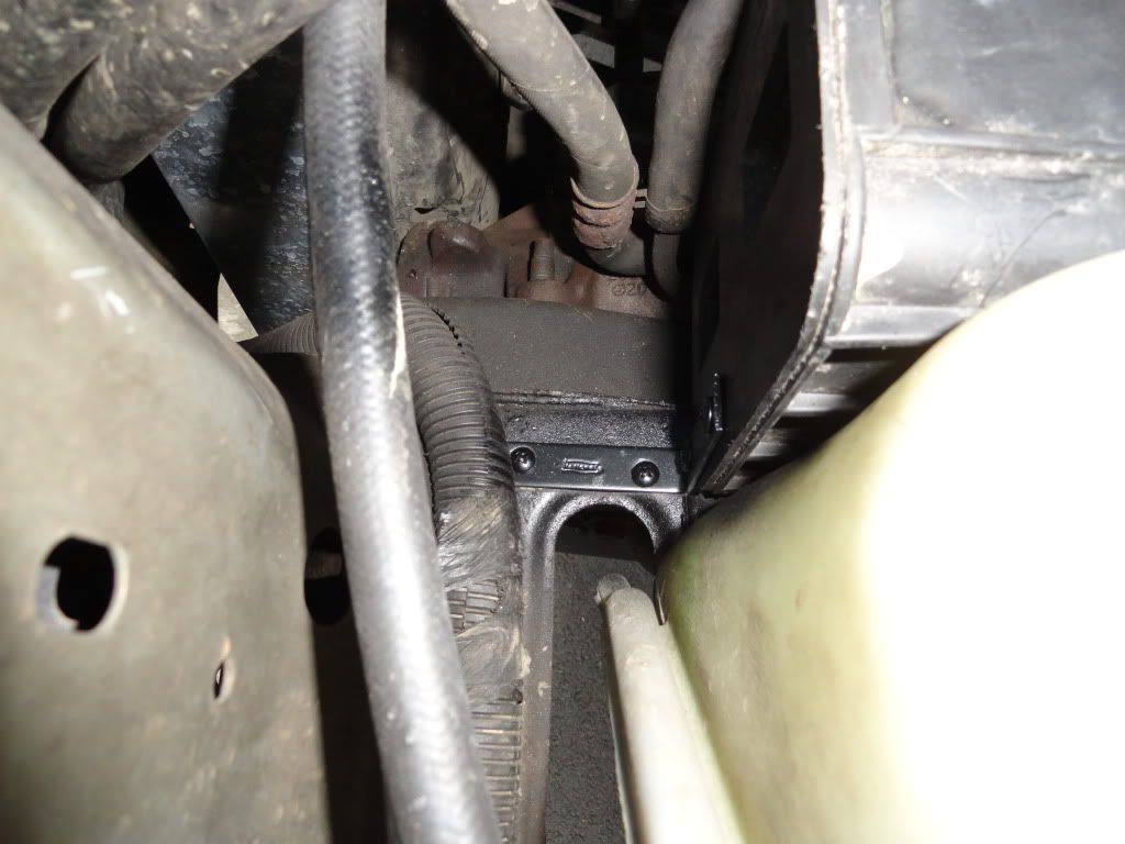

here's where I put mine:

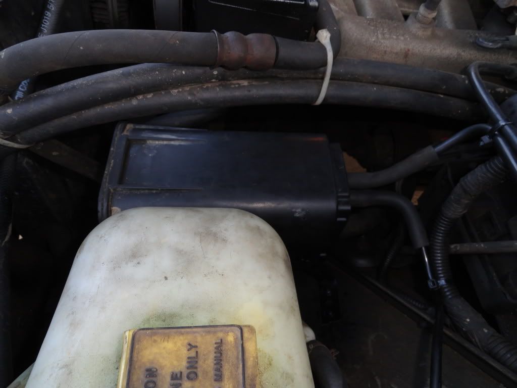

I did mine similar to Technohead in the other thread but I turned it on it's side. It looks exposed but once I put my bumper on it was protected.

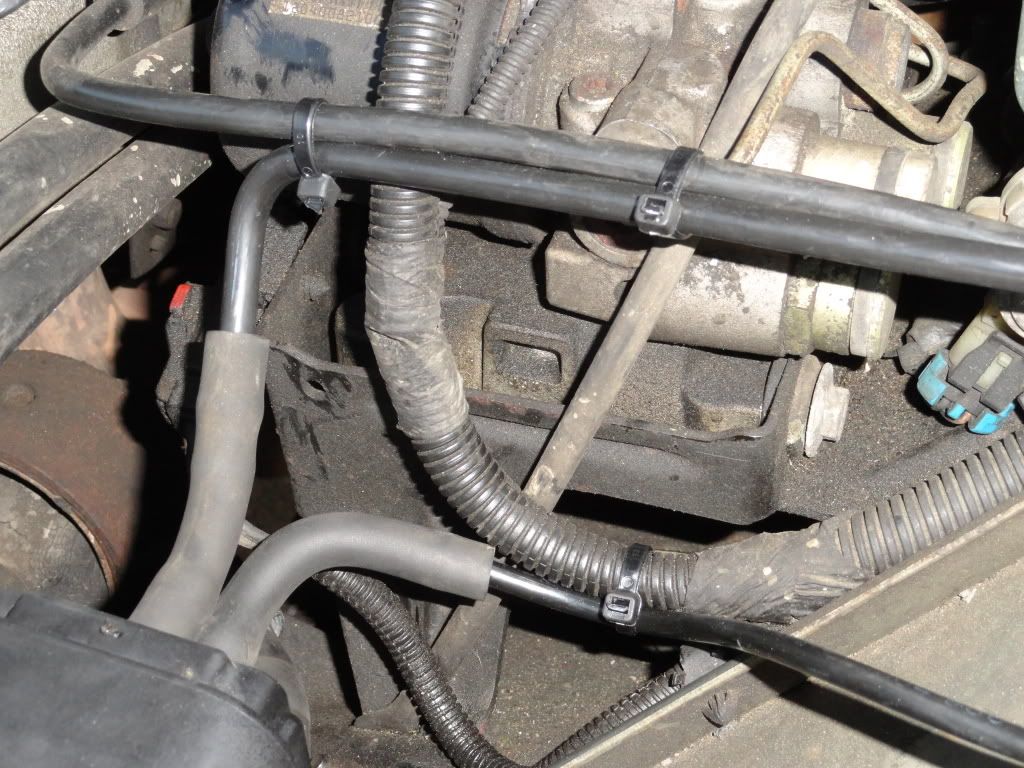

I tucked mine way up behind the bumper. Used the existing studs on the canister and bolted them through the jeep
