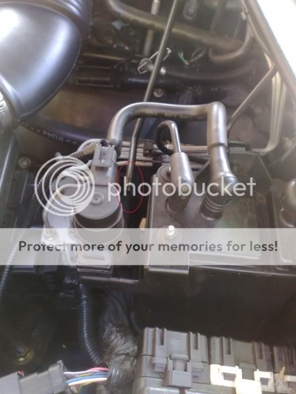

if cleaning the carbon off the IAC motor didn't work, which is typically the cause, then make sure the vacuum line from the side of the throttle body to the EVAP Canister Purge Solenoid(I think) is connected. Youll find the hose is not long enough & will come off when the engine revs hard, as the engine leans over. A common problem, but you will also get an erratic idle as well. Once reconnected it takes up to 10 start cycles to settle back down. Worked for me, as I was about to buy a new IAC, but now don't have to. Just need to cable tie the hose onto the solenoid, or bend the solenoid frame towards the TB. This is the hose:
Jammer73 is offline
