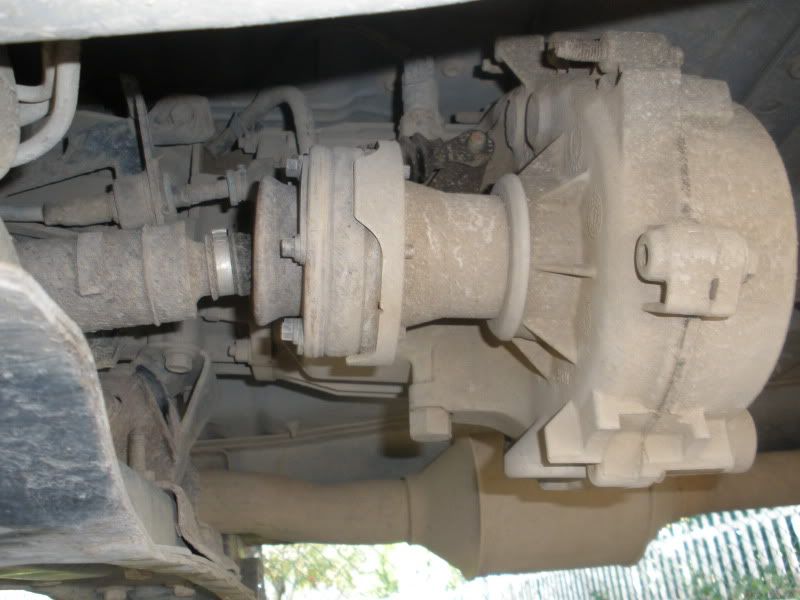

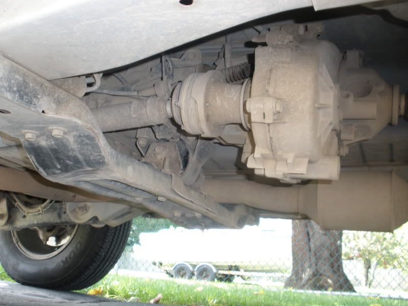

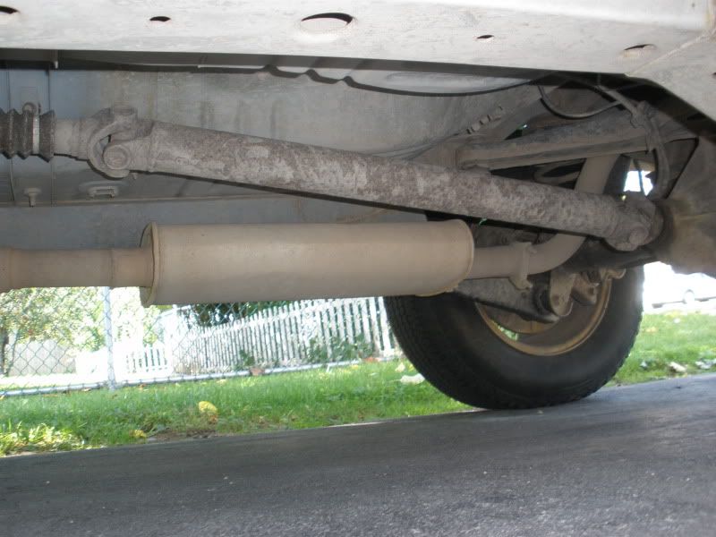

I'm not reall sure about that, actually don't know at all. It's all factory, I'll take some pictures when I get home from work. Hopefully someone can ID what I'm working with.

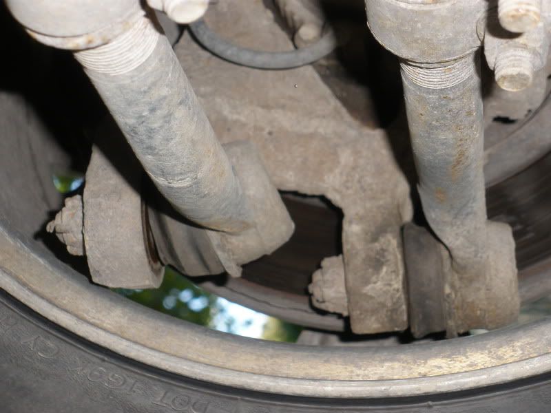

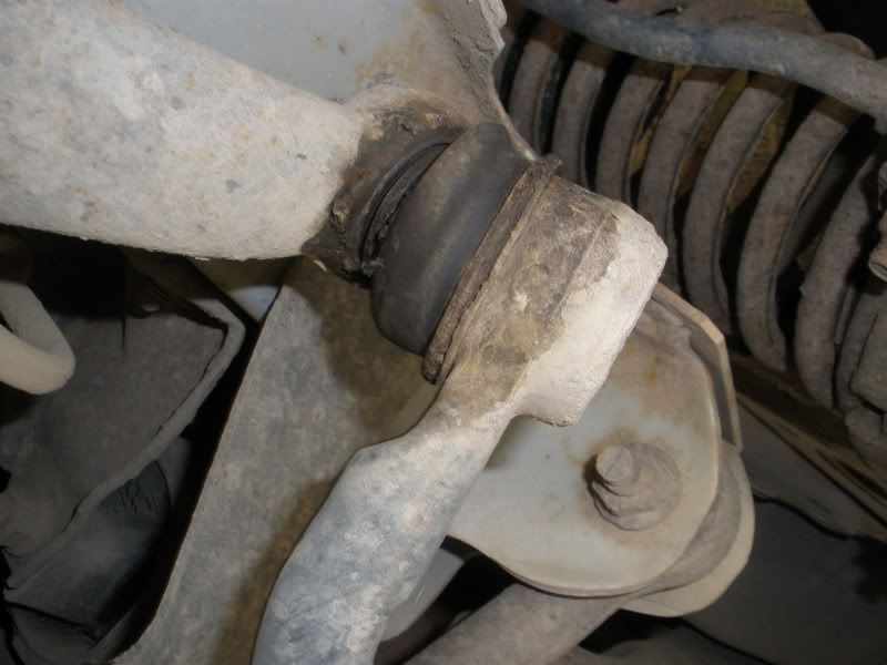

So do I just need a rear, or both? I also took some pictures. I think I finally found the source of all the rattling I hear when I'm driving. Can those tire rods just be tightened or is it time for all new?
Now I supposed that this is where all the noise is coming from?

I would say that upper one is shot judging by the squeak.
But the twisting movement is normal.
You need to have someone turn your steering wheel back-and-forth (with the jeep on for power steering) while you watch every joint. Those tie rod and drag link ends should not have any side to side movement, meaning that the studs dont move independently from the rest of the TRE

Also, you have the weak *** front drive shaft, and with any kind of lift you will want to quickly upgrade it.

yea, your rear DS is fine the front will need to be swapped out.
