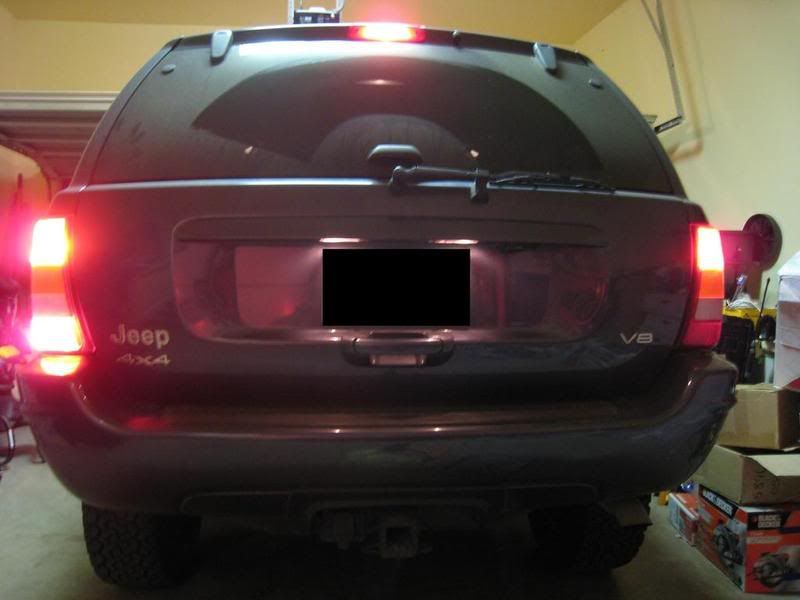

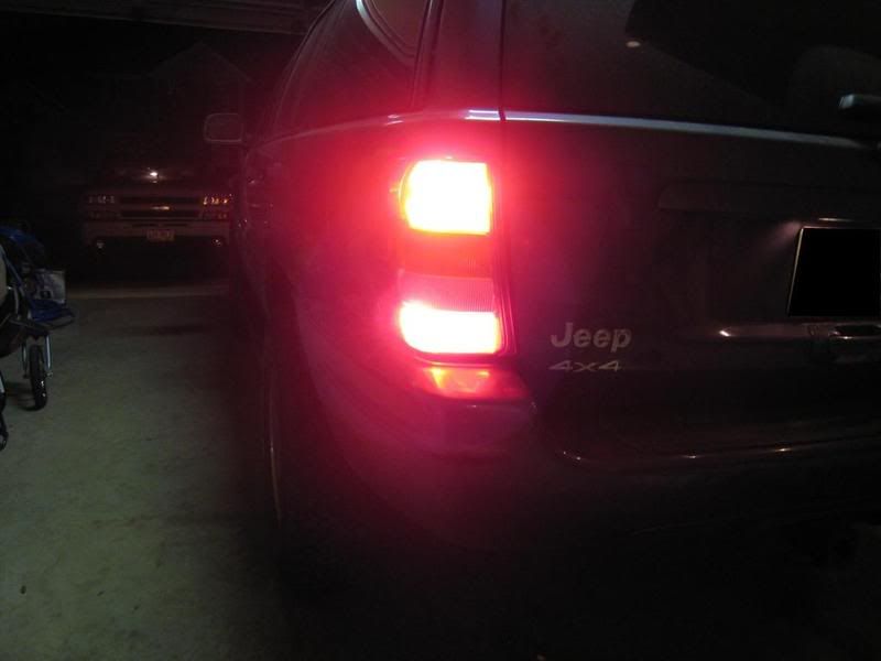

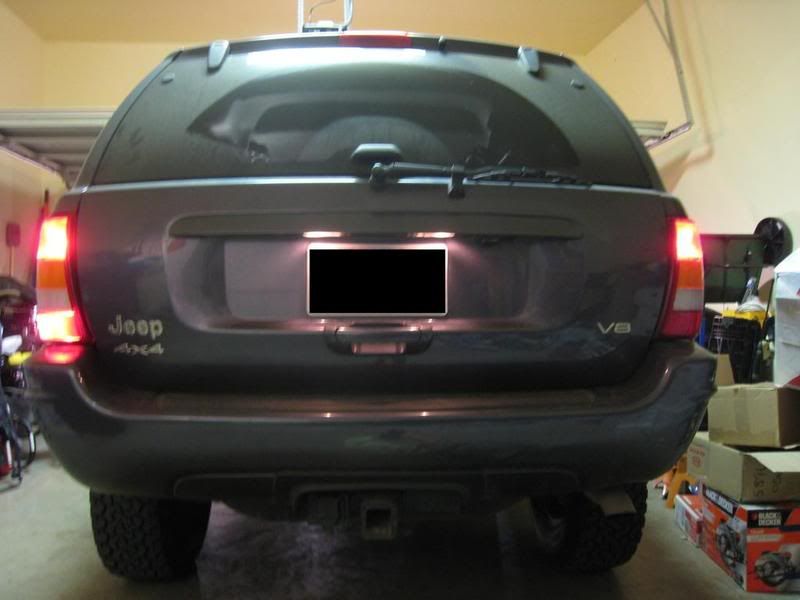

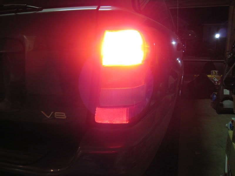

The quad tail light / brake light mod
I know others have done this mod. I decided to go for it after some kid rear-ended me few months ago (somehow that doesn't sound right), just a little unoticeable dent on my bumper cover; his minivan's hood look pretty bad though , and worse, my neck was sore for a week.... I may also add one of those 3 blink modules to the third stop light down the road...
Real easy mod, went to vato-zone, picked up a couple of 3157 sockets and bulbs, pulled a 1-1/8" drill hole saw, tested then spliced the wires and voila.
Passenger side stock for comparison:
Then both sides:

I know what you mean, but honestly the pics don't do justice and IMO, the difference is much more evident in real life. I also thought about this, and one option is to wire this only to the brakes and not the tails, that way it will be more obvious change in light while braking; but then I like the fact that an extra tail makes you more visible while driving.
That's the reason I'm considering the 3-blinker for the 3rd brake light (I guess 5th now ); I've seen those on the road and they really do catch your eye. LEDs would be nice too
